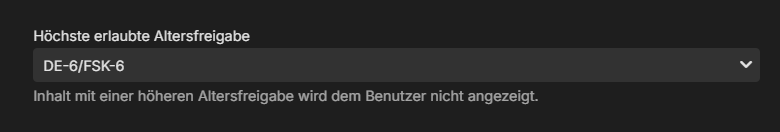

Snics 0 Posted March 16, 2025 Posted March 16, 2025 (edited) Hallo habe die Alterssperre für einen Benutzer auf max FSK6 gesetzt. Trotzdem ist die komplette Datenbank verfügbar. Auch FSK 18 und kann auch abgespielt werden. Wo ist der fehler? Interessant ist auch das der User selbst seinen Filter ändern kann. Edited March 16, 2025 by Snics

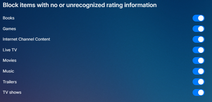

Happy2Play 9811 Posted March 16, 2025 Posted March 16, 2025 1 minute ago, Snics said: Hello, I set the age lock for a user to max FSK6. Nevertheless, the complete database is available. Also FSK 18 and can also be played. Where is the error? A guess would be the ratings themselves being considered unknown? Where did those come from at it does not look like the correct format and don't think Emby will delimit that? @Luke What are your exact parental ratings setting? Did you check the unknown/unrecognized ratings?

Luke 42239 Posted March 16, 2025 Posted March 16, 2025 @Snicsplease let us know if this helps. Thanks.
