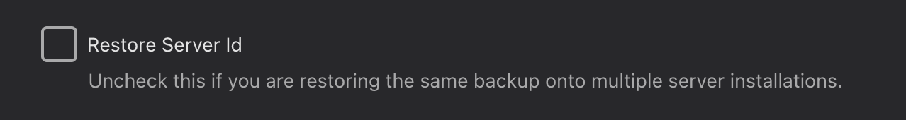

Dreakon13 143 Posted March 17, 2025 Author Posted March 17, 2025 Thank you, deleting the device.txt did the trick. TV apps are recognizing the two servers on their own now. I'll keep that in mind if I ever decide to get creative with the backup and restore feature again... kinda makes me wonder if the device.txt should carry over with it. Especially if you untick this option... Seems more likely to lead to confusion and issues than not.
