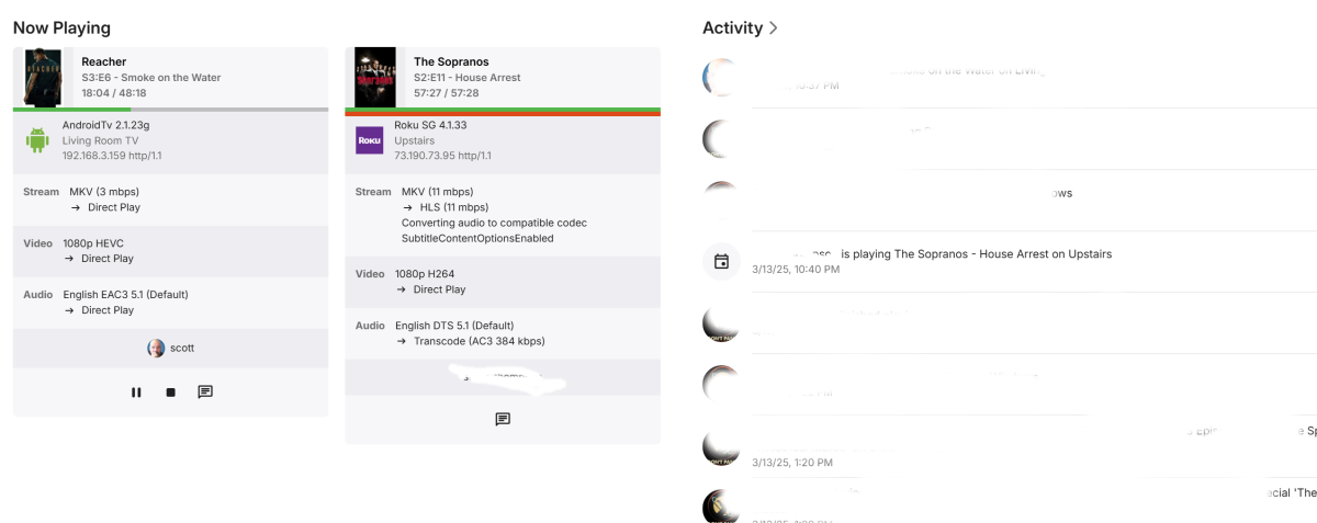

HawkXP71 112 Posted March 15, 2025 Posted March 15, 2025 I have someone who uses a ROKU SG to watch videos. unfortunately, he often watches TV shows but when the show goes to credits, he turns of the TV. The issue is, the Roku seems to pause the show not stop it. Then the user will sit there int he now playing state for hours (sometimes days) till he watches the next episode. Is there any setting, to say "stop sessions that are idle for over XXX minutes" ?

HawkXP71 112 Posted March 15, 2025 Author Posted March 15, 2025 Wasnt sure if it was a bug.. As you can see from the screen shot, the the user watched the episode yesterday at 1040pm, finished later, but the session is still open 24 hours later. I also attached both yesterdays and todays log. Thanks ~Scott embyserver_0313.txt embyserver_0314.txt

Luke 42178 Posted March 16, 2025 Posted March 16, 2025 On 3/15/2025 at 2:11 AM, HawkXP71 said: Wasnt sure if it was a bug.. As you can see from the screen shot, the the user watched the episode yesterday at 1040pm, finished later, but the session is still open 24 hours later. I also attached both yesterdays and todays log. Thanks ~Scott embyserver_0313.txt 1.91 MB · 0 downloads embyserver_0314.txt 1.91 MB · 0 downloads Hi, please try removing these plugins: 2025-03-11 20:51:23.845 Info App: Loading AutoCollections, Version=1.0.0.0, Culture=neutral, PublicKeyToken=null from C:\Emby-Server\programdata\plugins\AutoCollections.dll 2025-03-11 20:51:23.845 Info App: Loading DiskSpace, Version=1.0.6.4, Culture=neutral, PublicKeyToken=null from C:\Emby-Server\programdata\plugins\DiskSpace.dll 2025-03-11 20:51:23.845 Info App: Loading Emby.DataExplorer2, Version=4.8.2.0, Culture=neutral, PublicKeyToken=null from C:\Emby-Server\programdata\plugins\Emby.DataExplorer2.dll 2025-03-11 20:51:23.845 Info App: Loading Emby.DiagnosticsPlugin, Version=4.8.0.80, Culture=neutral, PublicKeyToken=null from C:\Emby-Server\programdata\plugins\Emby.DiagnosticsPlugin.dll 2025-03-11 20:51:23.845 Info App: Loading playback_reporting, Version=2.1.0.5, Culture=neutral, PublicKeyToken=null from C:\Emby-Server\programdata\plugins\playback_reporting.dll 2025-03-11 20:51:23.845 Info App: Loading statistics, Version=3.4.1.0, Culture=neutral, PublicKeyToken=null from C:\Emby-Server\programdata\plugins\Statistics.dll Then restart the server and see how things compare. Thanks.
