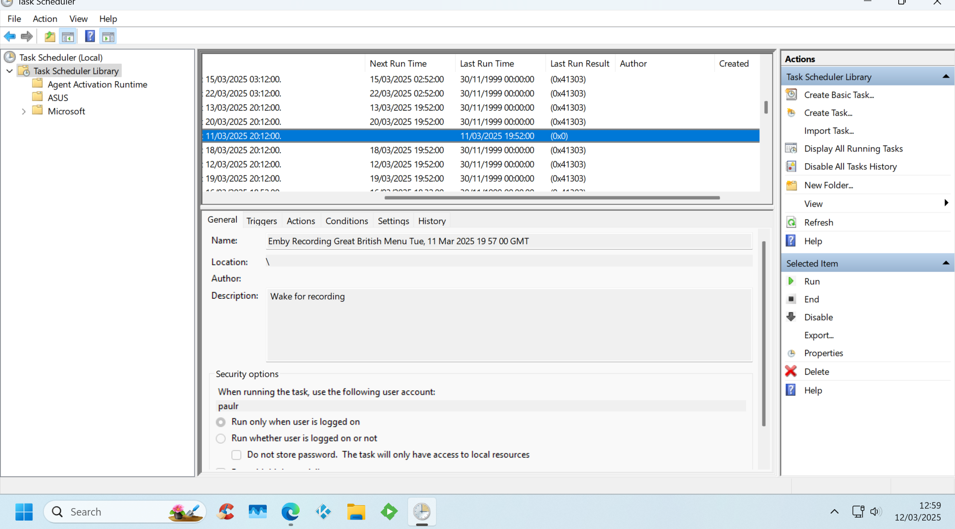

Now the details.  I have attached the Emby log and a screen shot of the Windows Task Manager showing the scheduled wake event.

2.  19:52:  The Windows Task Scheduler (see screenshot) shows a completed task set to run at 19:52 to wake the PC.  The last run result is (0x0) which I understand means it ran successfully.   However, the Emby log entries indicate the PC was already awake at this time.
