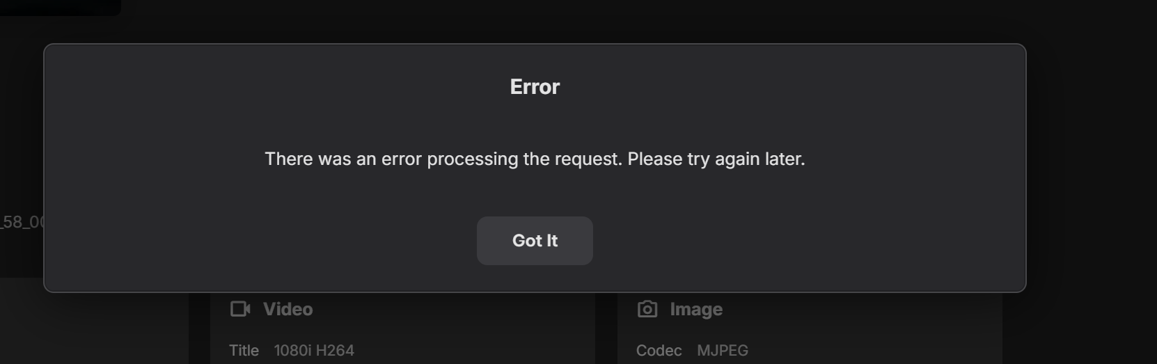

santo 1 Posted March 12, 2025 Posted March 12, 2025 Just checking if something has changed. WTV files recorded on MCE server were playing fine up until a week ago. Noticed no longer playing via web UI and iOS. Still playing through Samsung TV. Hitting play button does nothing and clicking the play button icon thumbnail gives error "There was an error processing the request. Please try again later". Not sure if related to this error in the log: 2025-03-12 00:00:31.387 Error QuickSingleImageExtractor: ProcessRun 'quick-extract-image' Error Output: ffmpeg version 5.1-emby_2023_06_25 Copyright (c) 2000-2022 the FFmpeg developers and softworkz for Emby LLC built with gcc 12.2.0 (Rev10, Built by MSYS2 project) Execution Date: 2025-03-11 23:59:31 -vsync is deprecated. Use -fps_mode Passing a number to -vsync is deprecated, use a string argument as described in the manual. h264 @ 000001e5ef47d540] non-existing PPS 0 referenced Last message repeated 1 times [h264 @ 000001e5ef47d540] decode_slice_header error [h264 @ 000001e5ef47d540] no frame!
