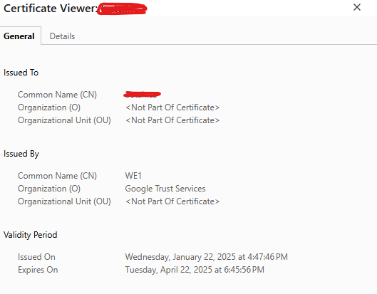

peterbata 4 Posted March 12, 2025 Author Posted March 12, 2025 3 hours ago, pwhodges said: In your first post you mention that httpS://emby.etc fails. You haven't mentioned that you have a certificate set up and working, so I'd like to confirm that. Paul Hello @pwhodgesThank you so much for chiming in. I really appreciate it. The certificate(s) are issued by Cloudflare. So visiting https://emby.mydomain.com results in the screenshot that I have attached to this reply. Using http://emby.mydomain.com changes nothing. As I said earlier I have no issues initiating a secure connection to my Emby server from all browsers and the Emby Android app. Using Emby Connect and the Emby iPhone app is where I am stuck with the cannot reach server error message

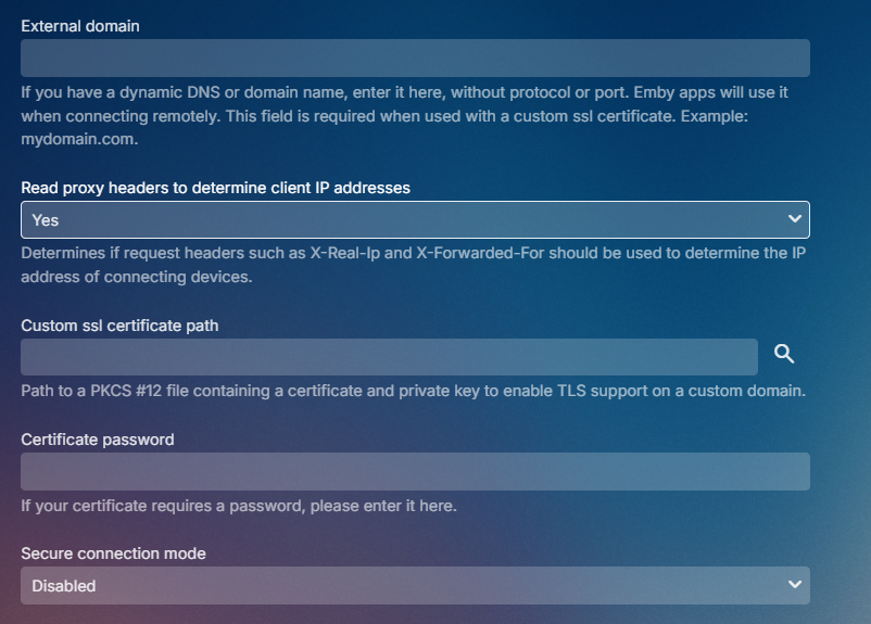

Carlo 4561 Posted March 13, 2025 Posted March 13, 2025 Hi, what public ports are you using? What do you have set up for External Domain? What do you have setup for these fields? You can send me a PM with this info if you like. Carlo
peterbata 4 Posted March 13, 2025 Author Posted March 13, 2025 1 hour ago, Carlo said: Hi, what public ports are you using? What do you have set up for External Domain? What do you have setup for these fields? You can send me a PM with this info if you like. Carlo Hello @CarloThanks for your response. Please see screenshot. External domain = emby.mydomain.com

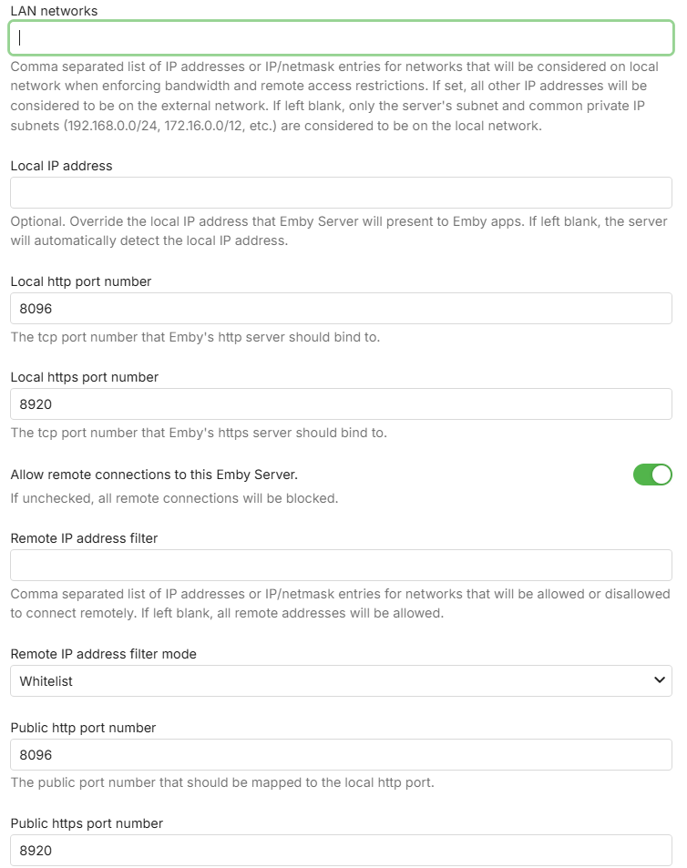

Solution KegTapper 8 Posted March 13, 2025 Solution Posted March 13, 2025 I'm using a cloudflare tunnel. My network settings look like this
peterbata 4 Posted March 14, 2025 Author Posted March 14, 2025 @KegTapperHmm. Let me give that a go. Will get back to you with my findings. Thanks for providing me that screenshot. Much appreciated. 1
peterbata 4 Posted March 14, 2025 Author Posted March 14, 2025 @KegTapperWell it took a while but someone finally came along with the solution that was keeping up at night. Thank you so much for getting back to me with the settings that I required. Have a wonderful Friday / weekend. 1 1
