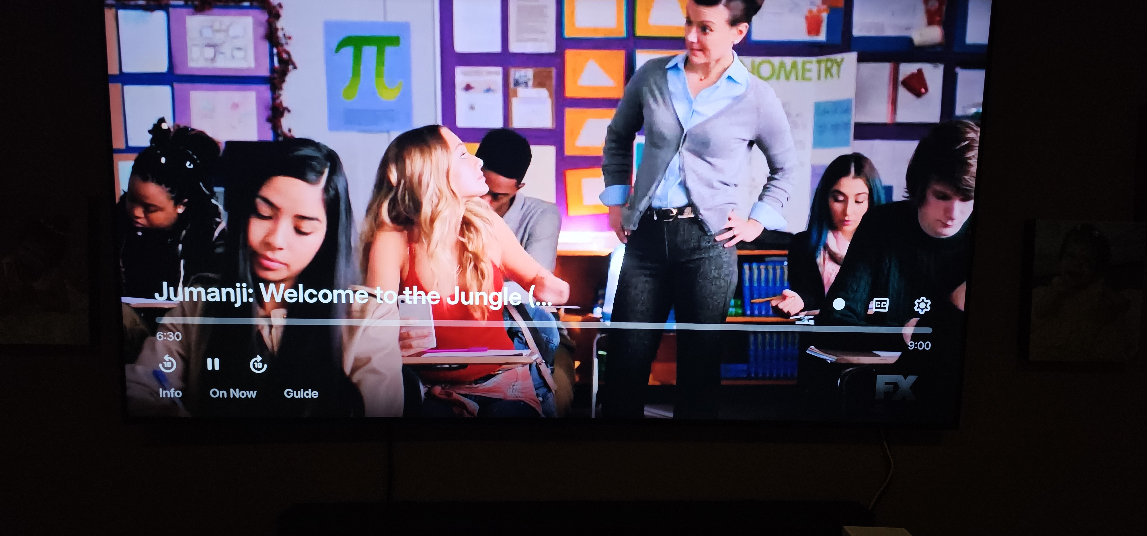

SamES 1084 Posted March 23, 2025 Posted March 23, 2025 50 minutes ago, all4dom said: @SamESi finally had a chance to try the usb download again with the stick being formatted to FAT32 & it worked. Only issue I still notice is when watching live tv, i still cant select the guide to view what's on the other channels, I have to back out of what i'm watching & then select guide. If you press down arrow while watching, then can you access the guide? @Luke I suspect another example of not being able to navigate the OSD during live playback as no element has the focus.
SamES 1084 Posted March 23, 2025 Posted March 23, 2025 What options do you have when you press down? Can you show a photo?
all4dom 101 Posted March 23, 2025 Author Posted March 23, 2025 @SamESso I installed the usb version on my sons samsung crystal tv & the guide works. When i press down on my 2023 q80c 65inch nothing happens. Only thing I can do is back out when watching live tv.
all4dom 101 Posted March 23, 2025 Author Posted March 23, 2025 No. You can see then icons but you can't select anything.
SamES 1084 Posted March 24, 2025 Posted March 24, 2025 The 'Info' key is the one you want - which is not so easy if you have the remote with only a few keys
all4dom 101 Posted March 24, 2025 Author Posted March 24, 2025 What is the info key on a samsung remote?
SamES 1084 Posted March 24, 2025 Posted March 24, 2025 4 minutes ago, all4dom said: What is the info key on a Samsung remote? If you have the 'Smart' remote, press the colored dot button twice and select info on screen.
all4dom 101 Posted March 24, 2025 Author Posted March 24, 2025 @SamESok that works but can i ask why I can't just select the down on the screen? To have to go through the extra steps doesnt make sense......unless it's bwcause of samsung ...then that makes a lot of sense.
SamES 1084 Posted March 24, 2025 Posted March 24, 2025 Up/Down just shows the OSD, but for LiveTV the navigation on the OSD is currently broken, however it should be fixed in the next update. Pressing Info is just a quick work-around for you as it shows the Info view, then after that navigation is possible.
