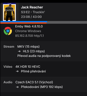

tlkounev 14 Posted March 5, 2025 Posted March 5, 2025 Hi, Im facing problems with transcoding EAC-3 in Chrome when Edge with same core can direct play EAC-3. Both browser are on same core and Emby see them as Chrome. Both has to have EAC-3 support as EAC-3 codec should be build to Gecko. Is this bug or feature? :) chrome.txt edge.txt

EarlyOnsetPooka 1 Posted January 31 Posted January 31 On 3/5/2025 at 9:59 AM, tlkounev said: Hi, Im facing problems with transcoding EAC-3 in Chrome when Edge with same core can direct play EAC-3. Both browser are on same core and Emby see them as Chrome. Both has to have EAC-3 support as EAC-3 codec should be build to Gecko. Is this bug or feature? chrome.txt 151.97 kB · 0 downloads edge.txt 196.68 kB · 0 downloads I've got the same behavior. I haven't pulled logs, but I attempted to play a file with EAC3 in Chrome, Edge, and the Emby windows app. Chrome forces transcode to mp3, while the other two direct play the EAC3

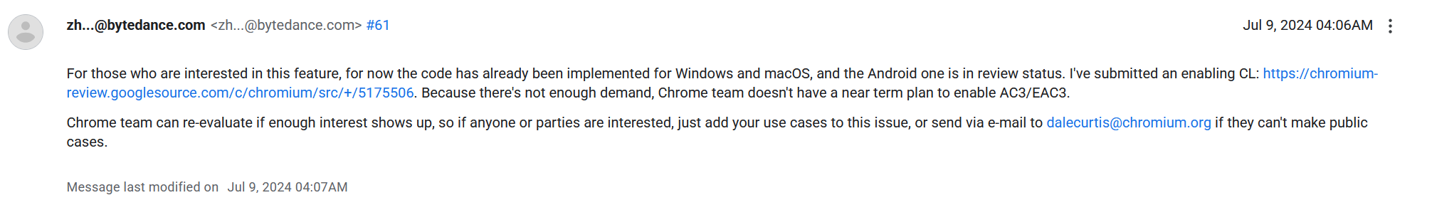

RanmaCanada 503 Posted January 31 Posted January 31 Just because they use the same core, doesn't mean they have the same features. The core is there, but Google hasn't implemented it, but it appears MS has. https://issues.chromium.org/issues/41253735 Just some proofs.
