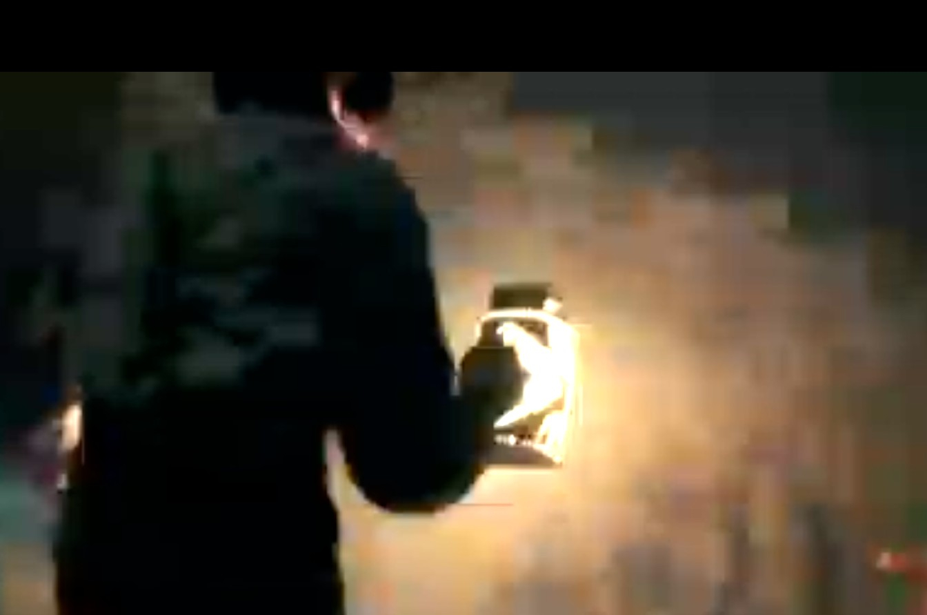

Meathor 0 Posted March 4, 2025 Posted March 4, 2025 Hallo, leider bekomme ich immer wieder artefakte beim wiedergeben von Medien. Siehe Bild... Habe ich was falsch eingestellt? Habe doch nur von nem I5 auf nem I7 gewechselt.mer
Meathor 0 Posted March 4, 2025 Author Posted March 4, 2025 PS: Das ist 1080P im VLC wird das ohne dies wieder gegeben.

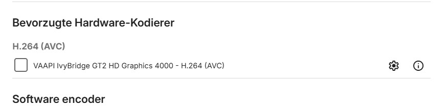

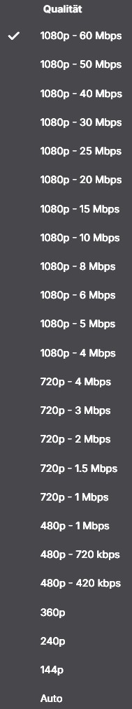

Meathor 0 Posted March 4, 2025 Author Posted March 4, 2025 Hello, sry for bad English. Direct Play are not showing. Only options in Screenshot is shown (1080p is the Original file). I Steam witch Google Chrome version 133.0, OS is Debian 6.1.112 Emby Server is on 4.8.10. Thx.

Meathor 0 Posted March 4, 2025 Author Posted March 4, 2025 If the Option H.264 AVC (Screen) is aktivated the artifacts is showig...

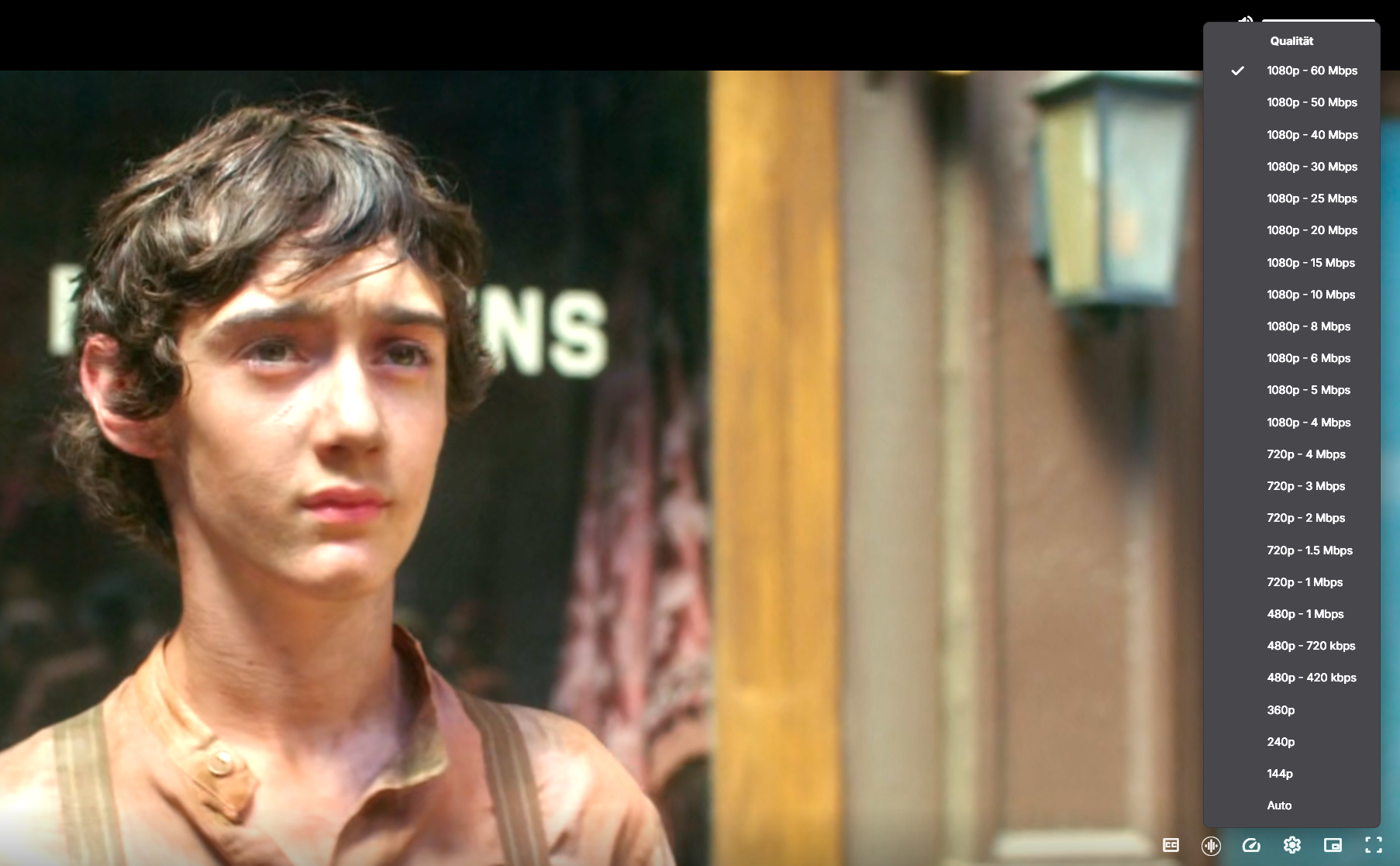

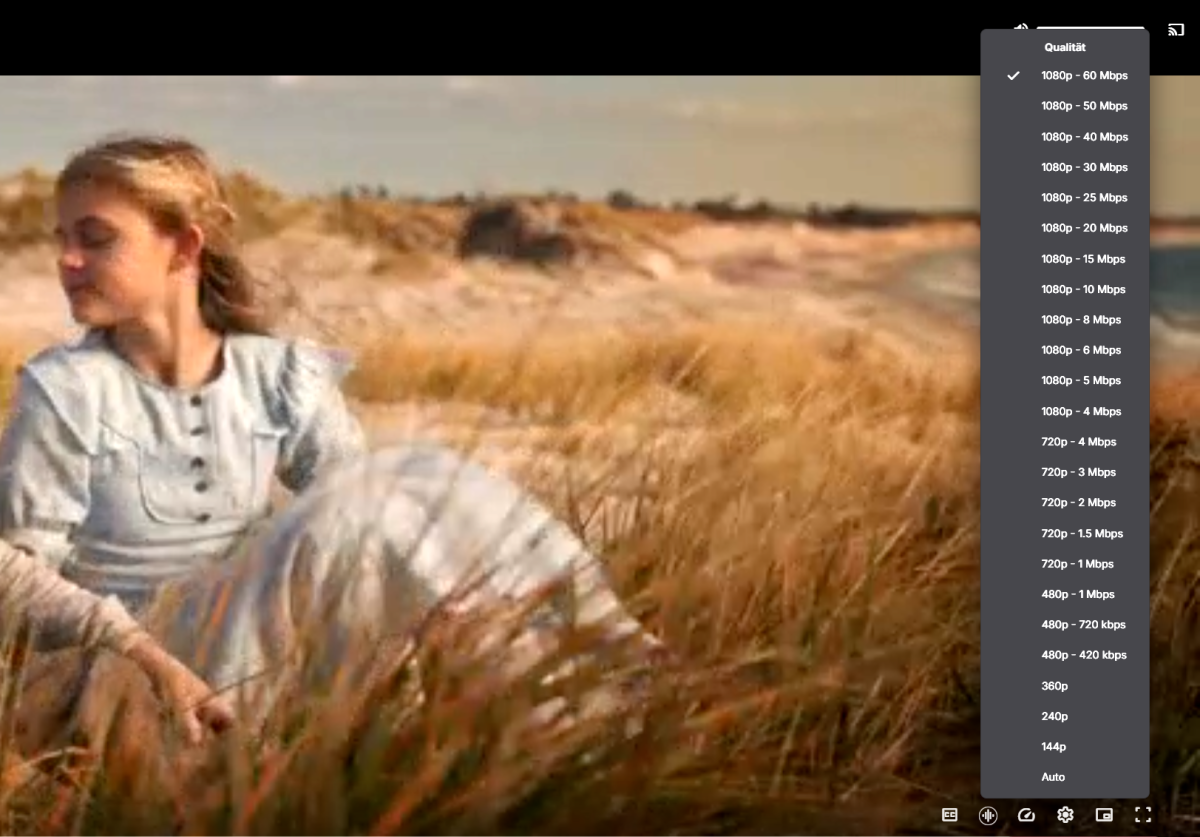

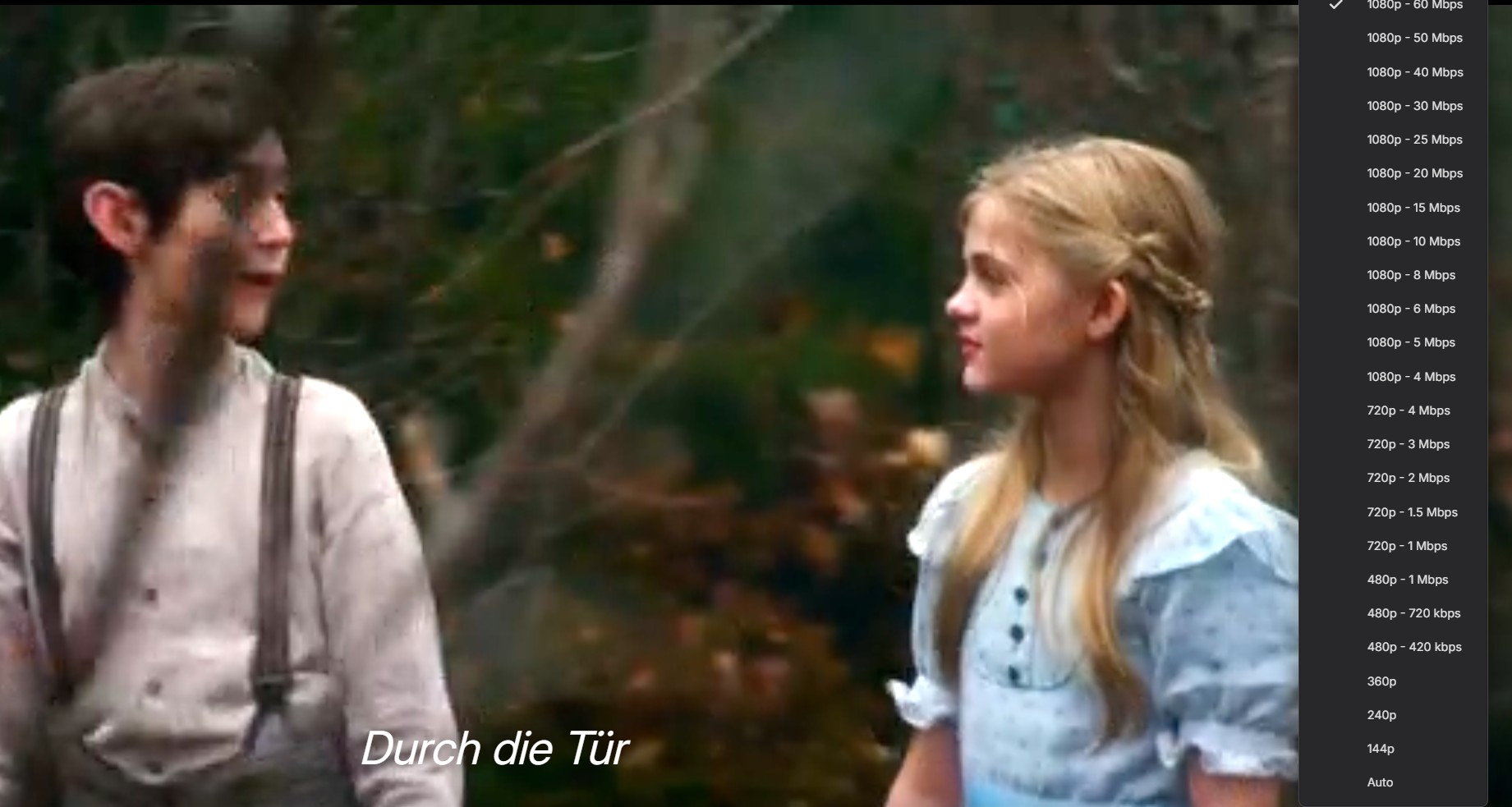

Meathor 0 Posted March 4, 2025 Author Posted March 4, 2025 artifacts are gone but quali is not 1080p... see screeshot
Luke 42243 Posted March 4, 2025 Posted March 4, 2025 4 minutes ago, Meathor said: artifacts are gone but quali is not 1080p... see screeshot Hi there, let's look at an example. Please attach the information requested in how to report a media playback issue. Thanks!
Happy2Play 9812 Posted March 4, 2025 Posted March 4, 2025 You can not go by the client player quality as you have applied a server bitrate limit. I do not know if the server will even send 1080p at 2Mbps. Per testing in another topic I believe the lowers 1080p went was like 5Mbps. But every example you need to post at least the new ffmpeg log.
