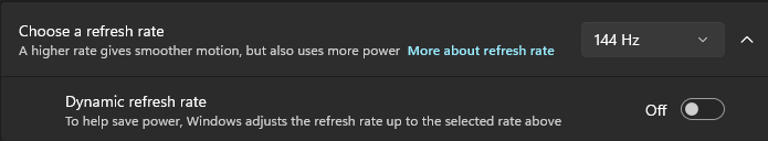

65535 14 Posted March 21, 2025 Author Posted March 21, 2025 (edited) I see about the telemetry (or lack thereof). If I ever crash for whatever reason, I'll be sure to report with logs. 19 hours ago, softworkz said: What I'm hoping for instead is an opportunity to borrow a gaming monitor for a few days from somebody to do some testing and analysis. That's great news! 4 hours ago, frankmb said: Just a guess but it is probably for power savings, especially on laptop. You get the smoothness of high refresh rate all the time but not the power usage of high refresh rate 100% of the time. Exactly. It says that where you enable the feature: Microsoft further say on their website: Quote Windows 11 introduces a new feature called Dynamic Refresh Rate (DRR) that automatically adjusts the refresh rate based on what you are doing at the time. This can help you get the best of both worlds: a smooth experience when you need it for gaming, browsing or inking, and a longer battery life when you’re not doing these types of things. 19 hours ago, softworkz said: Why do they spend so much effort on this? Why not have everybody use 144 Hz permanently instead? Clearly because there are drawbacks in doing the latter, and that's why it's important to analyze and understand in which ways it affects our app.Depend on these results we'll figure out the best approach to handle it in the future. So there's your answer as to why. The existence of this feature doesn't imply that high refresh rates are bad or incompatible. It's not forced on or anything (it's actually half-assed and undercooked like most MS software nowadays). Besides power draw, there's no evidence of any issues running even 480 hz permanently. Anyway, I don't wanna get ahead of myself before you've had the chance to test with the monitor. 19 hours ago, softworkz said: With 18 Gbps, you cannot even get 4k@60Hz with 10bit HDR. The maximum is 8bit and that only with chroma subsampling 19 hours ago, softworkz said: Since videos above 60 fps are rare and higher rates are making things worse for the majority of users (HDMI), rates above 60 Hz are currently not considered for the automatic refresh mode switching feature. 4k60 with 10 bpc and 4:2:0 is actually in-spec for HDMI 2.0b, but I see your overall point on why it's defaulting to the lowest rate. Displays pull all kinds of weird behaviors that might need to be worked around. All of this certainly needs to be taken into account. HDMI 2.0 TVs are going to be around for a while. Thanks for your time. Looking forward to updates on your testing Edited March 21, 2025 by 65535

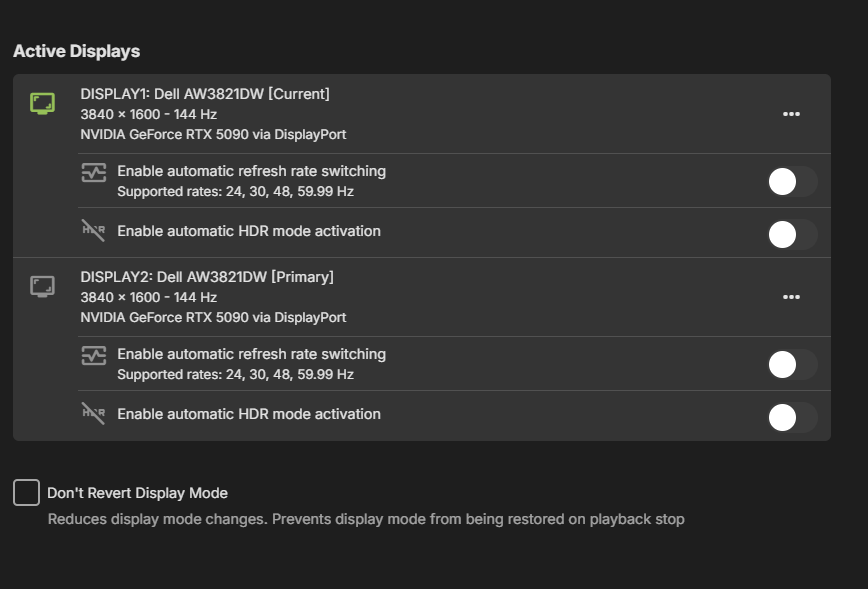

themlgsnejk 1 Posted March 25, 2025 Posted March 25, 2025 Thank you for making the app unusable on pc! Now my 5120x1440 240hz monitor switches to 120hz no matter what i set the option to. Everything was very fine before this update, now i'll have to stick with using the browser... 1
kron0s 24 Posted March 26, 2025 Posted March 26, 2025 (edited) Sigh, please disable automatic frame rate switching. Even after the new update with the setting disable it still switches my screen's refresh rate to 120hz. I don't want this, I want to keep my monitor at the rate I set it at and not dictated by Emby! No one wants this feature, please fix the issue and let us disable the automatic frame rate switching!! Edited March 26, 2025 by kron0s 1
softworkz 5133 Posted March 26, 2025 Posted March 26, 2025 1 minute ago, kron0s said: Sigh, please disable automatic frame rate switching. Even after the new update with the setting disable it still switches my screen's refresh rate to 120hz. Please see the discussion above. That's the current behavior. We understand that not everybody likes this and it will be further investigated. I'm locking this topic temporarily because there are some good discussion points I want to follow-up to later. This is not meant to keep anybody from complaining, just create new topics please when you feel you need to do so. Thanks.
softworkz 5133 Posted April 9, 2025 Posted April 9, 2025 Please note: The next beta will have an opt-out. 2
Volodesi 11 Posted April 12, 2025 Posted April 12, 2025 On 4/8/2025 at 11:07 PM, softworkz said: Please note: The next beta will have an opt-out. How do you go about doing this with a Windows Store app? I figured it was like most App stores and there would be somewhere on the page to Opt-In to the better version. But I don't see it. I've been trying to force myself to use the Windows App version, but the Refresh rate switch is driving me insane since I am on a 4K240Hz monitor. 3

softworkz 5133 Posted April 26, 2025 Posted April 26, 2025 The opt-out option is in the new beta (https://emby.media/community/index.php?/topic/138418-new-windows-xbox-beta-222500-beta/) If all goes well, the stable will follow in a few days. Thanks 1
shadezero 3 Posted October 4, 2025 Posted October 4, 2025 (edited) Disregard Edited October 4, 2025 by shadezero Found setting to bypass
