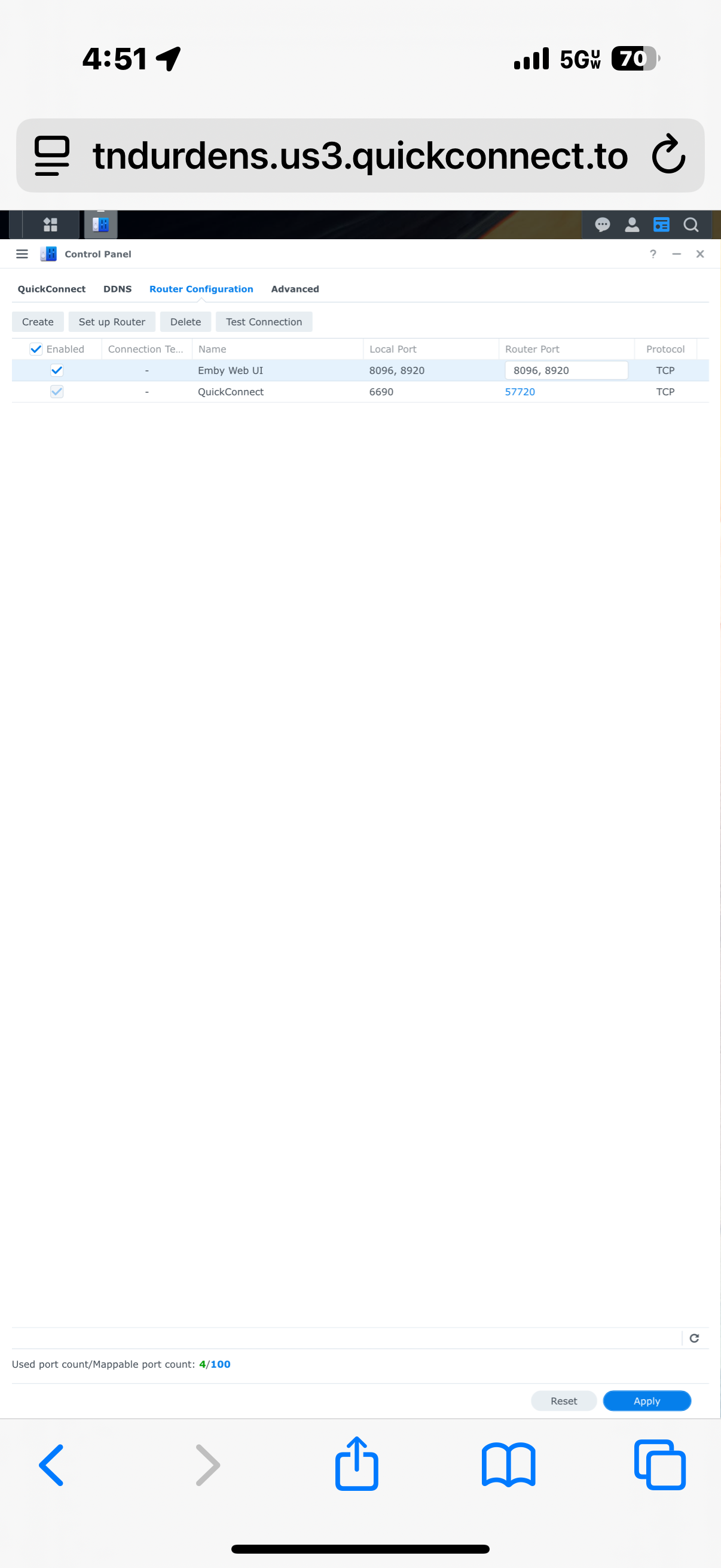

njtechguy 3 Posted February 26, 2025 Posted February 26, 2025 I have a nighthawk RS700 and I recently changed my nighthawk modem to my isp modem. I am very tech savvy I put the isp modem in bridge mode. I set the forwarding on the synology drive. I also have Emby premiere lifetime. The issue is the remote access is stopping every other day and everyone gets blocked. I reset the synology and then it works again. The synology drive has the port forwarding and permissions correct. I need to know why does the remote access keep getting blocked every other day and what is the max number number of users for Emby premiere lifetime and do I need to do port forwarding on the router and modem too PLEASE HELP

njtechguy 3 Posted February 27, 2025 Author Posted February 27, 2025 I actually fixed the remote issues instead of doing the port forwarding on my NAS I did it on the router and it has been stable 1
Luke 42240 Posted February 27, 2025 Posted February 27, 2025 13 hours ago, njtechguy said: I actually fixed the remote issues instead of doing the port forwarding on my NAS I did it on the router and it has been stable Great. What was the solution?
Carlo 4561 Posted March 2, 2025 Posted March 2, 2025 On 2/27/2025 at 1:31 PM, Luke said: Great. What was the solution? He had to setup port forwarding on the router to allow inbound traffic through it. 1
