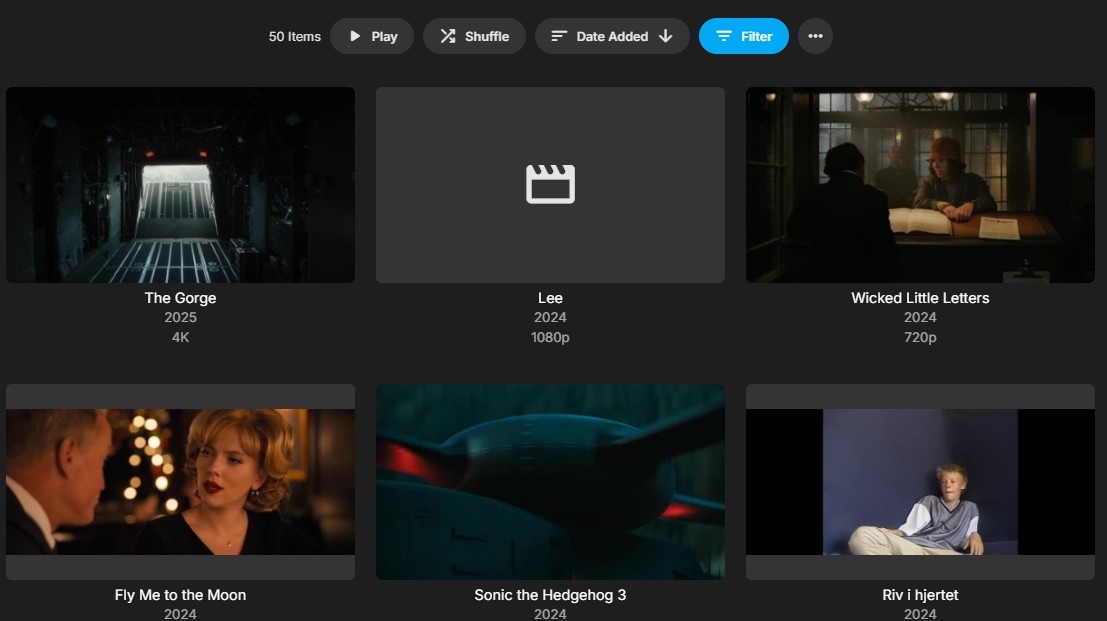

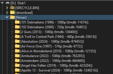

Feels like I'm tried everything. Even went over all my movies, checked there name ande given them the tmdb id. But it will not update, it only makes som thumbs from the movie it self.

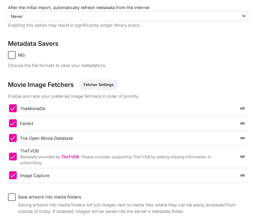

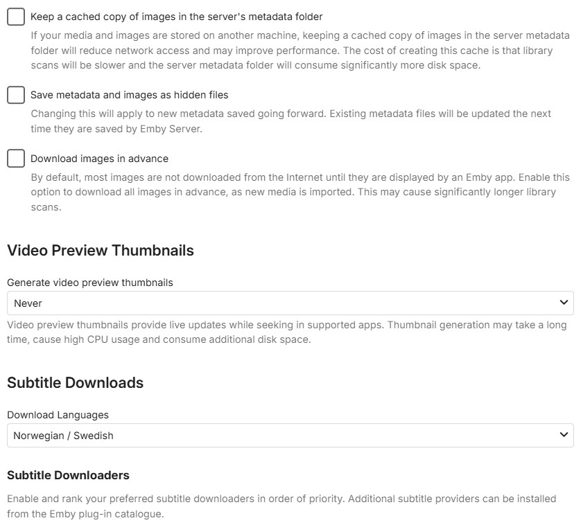

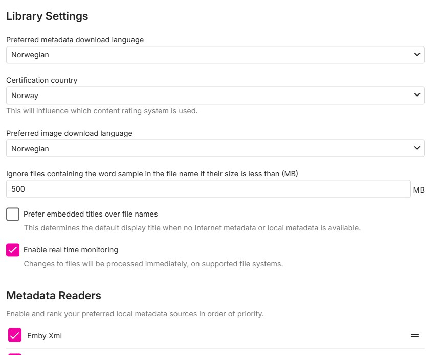

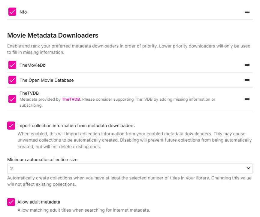

I'll add pictres and log, so you can see what I see. Hope someone pleas can help. Also add pics of setup for mye move library, folder setup and how my library looks like 🙂

I would double check your library settings and maybe even toggle them as it looks like the only some libraries sending provider queries, like it is random or per specific libraries not knowing all libraries configured.
As doing a generic search of your log for "https://api.themoviedb" you see it only hits a few library folder items and errors do to incomplete naming schemes.  But would expect a lot more queries.

I have added all my lib settings in the pictures, except the folders, but they are all there. I don't know what more to check, that's why I asked here. 🙂
