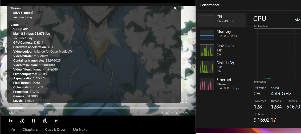

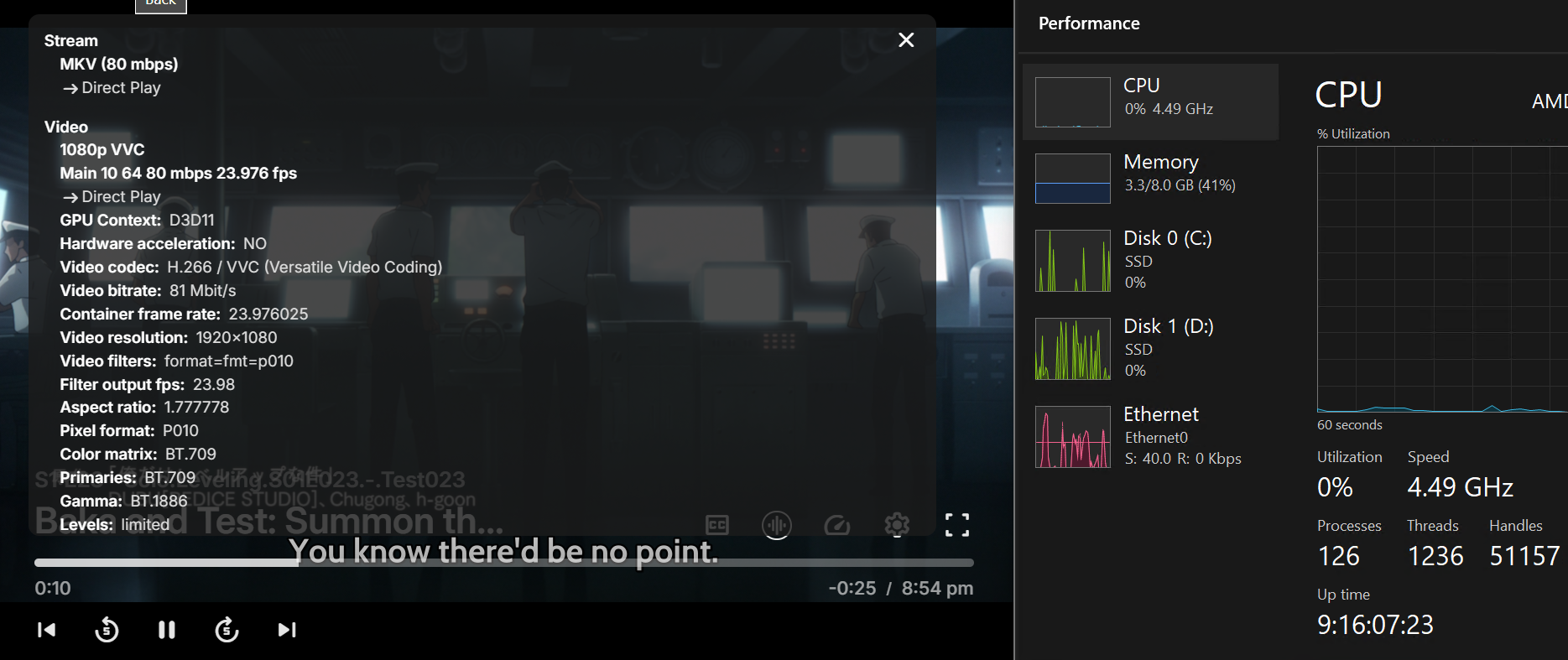

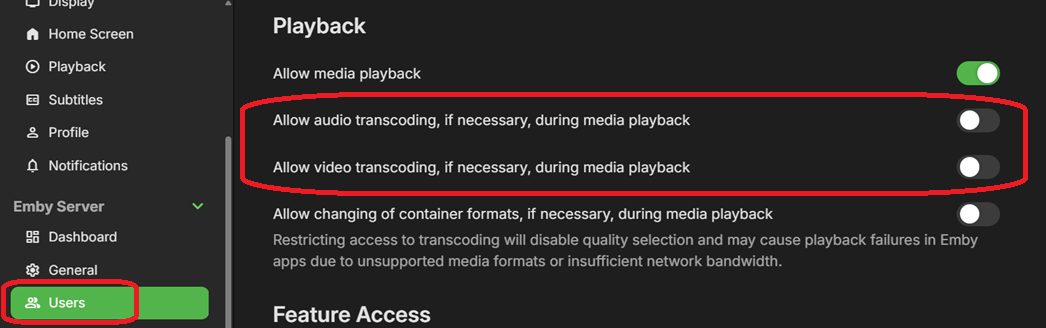

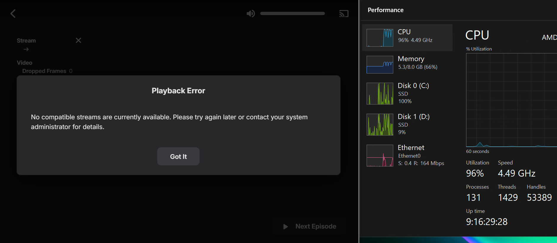

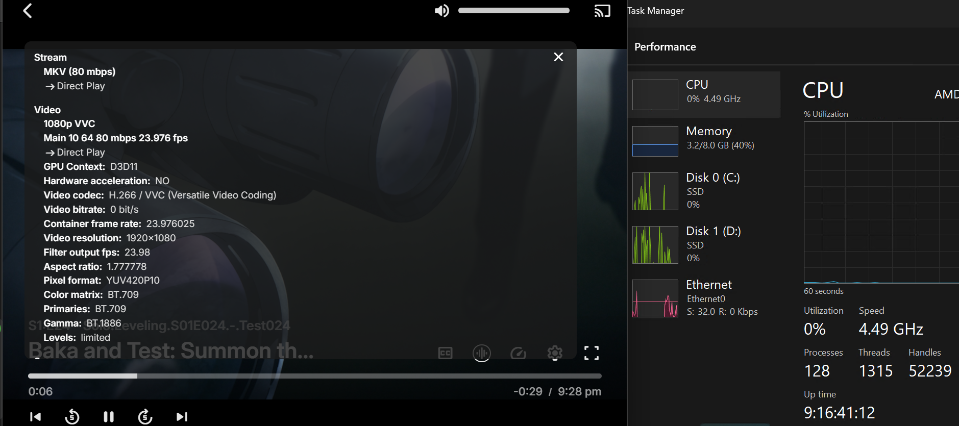

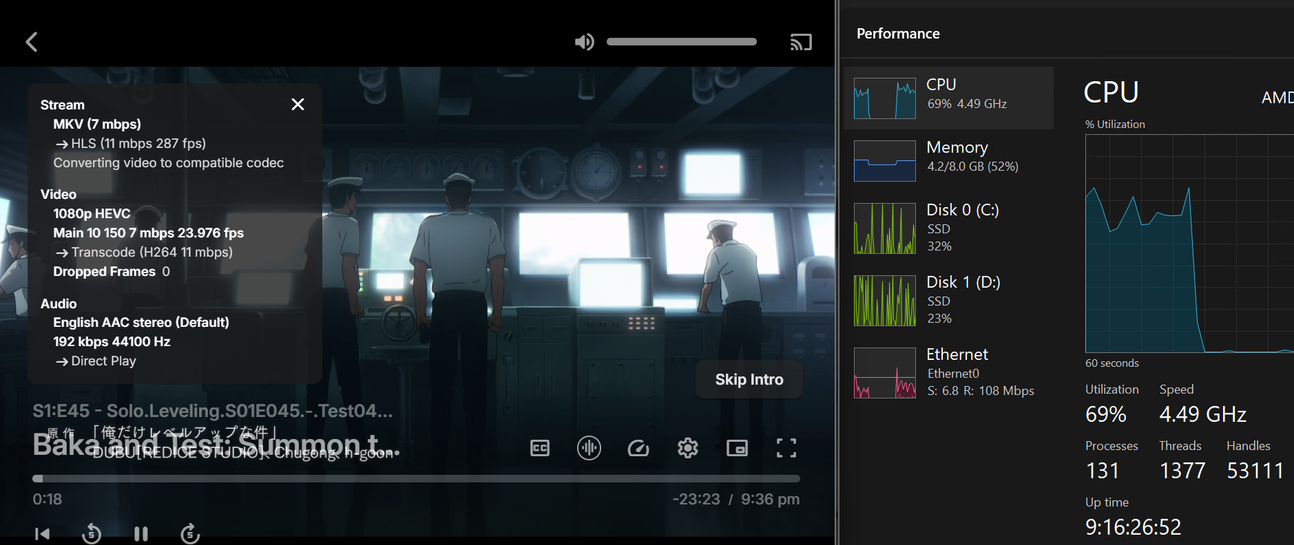

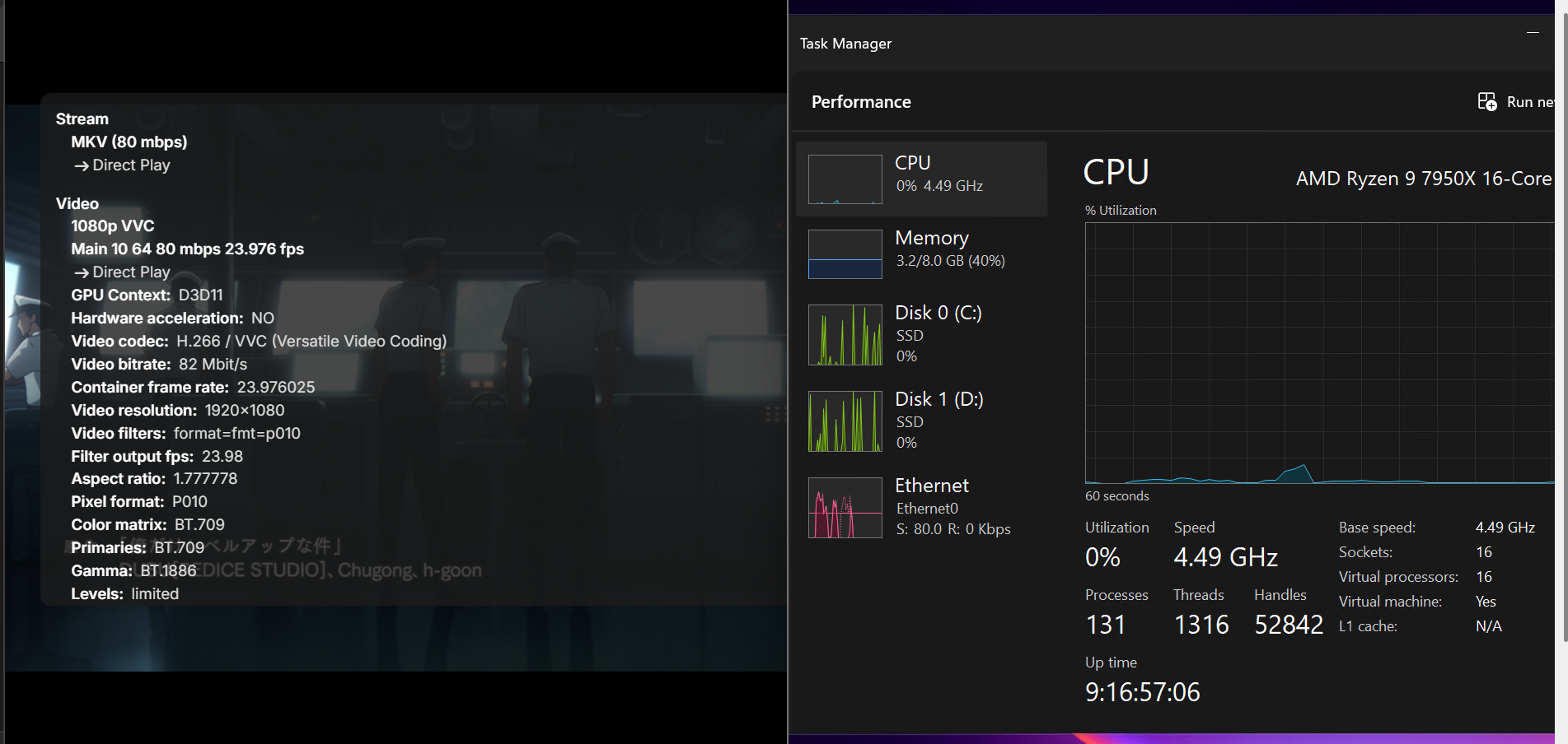

Enndy 0 Posted March 25, 2025 Posted March 25, 2025 (edited) In case someone is interested, I fixed the issue of having to transcode my HEVC (H.265), AV1, and VVC (H.266) video files by following the instructions given here in an earlier post, plus Emby App, plus Emby Premier, as explained below. 1.- Disabling transcoding per user in their settings page. 2.- By downloading the Emby app from the Microsoft Store (on my Windows 11 computer). Unfortunately, the Emby app was able to play all formats without transcoding. This was confirmed by checking Emby server - Win2025 Task Manager performance being normal=very low - By checking Stats for Nerds on videos being played 3.- The new Emby app plays any video, but only for 1 minute unless you have Emby Premiere, which allows you to play videos without time limits. All other browsers I tried (Firefox, Chrome, MS Edge) were unable to play videos at all after disabling Transcoding. RESULTS Before fix: HVEC (H.265) + Chrome + "Transcoding=ON" + Direct Play Left: Google Chrome | Right: Emby host server Task Manager Before fix: VVC (H.266) + "Transcoding=ON" + Direct Play Left: Google Chrome | Right: Emby host server Task Manager After fix: AV1 + Emby App + "Transcoding=OFF" + Direct Play Left: Emby App | Right: Emby host server Task Manager After fix: VVC (H.266) + Emby App + Transcoding=OFF + Direct Play Left: Emby App | Right: Emby host server Task Manager After fix: HEVC (H.265) + Emby App + Transcoding=OFF + Direct Play Left: Emby App | Right: Emby host server Task Manager PS: Please note: - This is my first post here. I hope these screenshots come out well and do not confuse or drive people crazy. - Even when Transcoding is ON, and other browsers trigger Emby Server to use all CPU power on the host server, the Emby App does not force transcoding, instead it uses Direct Play keeping the host server CPU utilization very low, as shown below. But the computer where the player is running, on the other hand, will, you might say, suffer the consequences by having to use more CPU than usual. I am OK with this since even a low end laptop I use for testing, is capable of playing most videos, except for the one shown below, which it has a bit of a difficult time processing it, pausing the video for a fraction of a every now and then, but that video is unnecessarily high quality, very heavy in storage space, and used only for testing. Left: Emby App | Right: Emby host server Task Manager | Below: low end test laptop performance while playing this video Edited March 25, 2025 by Enndy
