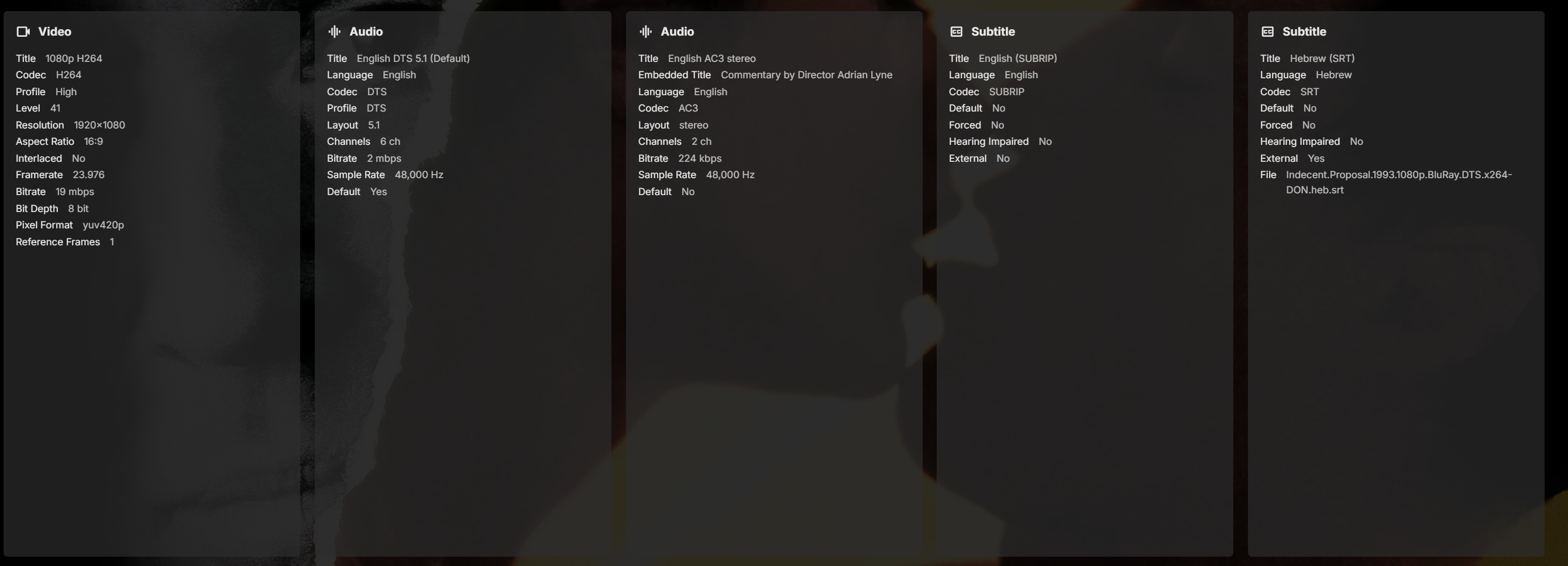

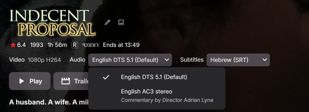

LoLoEmby 1 Posted February 24, 2025 Posted February 24, 2025 Hey folks! I have an annoying experience that I was not able to turn off. When I watch movies with Descriptive / Commentary audio on the web or some Samsung TVs with the latest Emby app the audio of Descriptive taking over the original sound file. The only what I found out was to remux it with MKVtoolNix and remove that audio file. Things that I tried to change: 1. Transcoding - Direct play / On 2. Change default Trak to English or my language 3. Check on and off the: "Play default audio track regardless of language" 4. Remember audio track selections - On and Off 5. Enable Cinema Intros - On and Off This is very annoying issue and I tried to search for solution but without luck. Any suggestion please? Thanks

LoLoEmby 1 Posted February 25, 2025 Author Posted February 25, 2025 Ahh no for the "SAS.Rogue.Heroes" no issue. this is another user playing it right now. I'm talking about the movie that I attached Indecent.Proposal.1993.

visproduction 328 Posted February 25, 2025 Posted February 25, 2025 I think audio DTS-HD is not recognized and the second audio AC3 is used. If you converted the first DTS audio to AAC surround, for example, it would probably play fine as the default audio. See: https://www.avsforum.com/threads/what-is-difference-between-dts-hd-and-dts-ma.814541/
LoLoEmby 1 Posted February 26, 2025 Author Posted February 26, 2025 13 hours ago, Happy2Play said: do you have ffmpeg logs for that? I attached the lastest file from the server after playing the movie so I believe, no The user that I'm connected with set as Direct play so I guess no ffmpeg for him 9 hours ago, visproduction said: I think audio DTS-HD is not recognized and the second audio AC3 is used. If you converted the first DTS audio to AAC surround, for example, it would probably play fine as the default audio. See: https://www.avsforum.com/threads/what-is-difference-between-dts-hd-and-dts-ma.814541/ I think you right Just want to avoid changing the movie file since it's on torrents as well. We need to find a setting to disable the other AC3 Commentary audio. Thank you both!

LoLoEmby 1 Posted February 26, 2025 Author Posted February 26, 2025 It somehow stays the same More than that, when I trying to switch to the other source audio, no change. still playing the same audio track. I tried different movie with English and Hebrew DUB, when I start the movie, it always plays the Hebrew no matther if I choose English in the menu or change in the player itself.

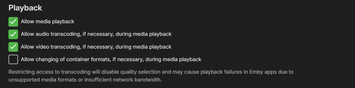

Solution Luke 42178 Posted February 26, 2025 Solution Posted February 26, 2025 7 minutes ago, LoLoEmby said: It somehow stays the same More than that, when I trying to switch to the other source audio, no change. still playing the same audio track. I tried different movie with English and Hebrew DUB, when I start the movie, it always plays the Hebrew no matther if I choose English in the menu or change in the player itself. This could be playing a role in your issue:
LoLoEmby 1 Posted February 27, 2025 Author Posted February 27, 2025 Thanks for the quick reply, man. I always using this selection when I know the user have low end TV/Streamer Without changing the container. Do you think it can be the issue? Should I enable it for everyone?
Luke 42178 Posted February 27, 2025 Posted February 27, 2025 It could be the problem yes. I would start by reenabling it.
LoLoEmby 1 Posted February 27, 2025 Author Posted February 27, 2025 You are amazing! Many thanks Luke! Not its actually working even when changing during playback. I would like if you can explain a little about this playback container settings please...
Luke 42178 Posted February 27, 2025 Posted February 27, 2025 11 hours ago, LoLoEmby said: You are amazing! Many thanks Luke! Not its actually working even when changing during playback. I would like if you can explain a little about this playback container settings please... Using the option takes away some playback methods. Sometimes those methods are needed in order to select the correct track.
