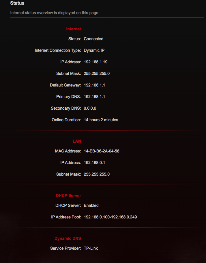

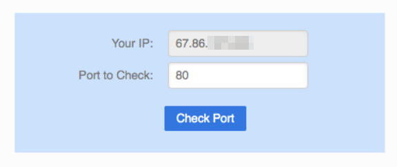

Bigmack3000 116 Posted February 23, 2025 Author Posted February 23, 2025 (edited) yes Im pretty sure the new modem is cgnat. this is from canyouseeme: this is from optimum: this is from my router: Edited February 23, 2025 by seanbuff removed public IP

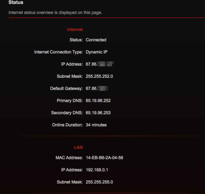

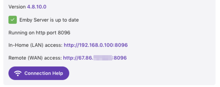

Bigmack3000 116 Posted February 23, 2025 Author Posted February 23, 2025 (edited) ok i think I'm a lot closer now. this is the router ip after choosing lan 4: but this is what automatically emby lists: Edited February 24, 2025 by seanbuff removed public IPs

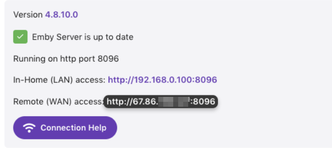

Bigmack3000 116 Posted February 24, 2025 Author Posted February 24, 2025 (edited) Ok i restarted emby. now the correct wan ip shows up: and if i click that link on my computer it opens fine. but if i try to connect remotely on my phone, the server cannot be found Edited February 24, 2025 by seanbuff removed public IP
Bigmack3000 116 Posted February 24, 2025 Author Posted February 24, 2025 ok, probably too many updates from me, but i removed the server from my phone app, then reconnected on wifi, and it brought over the new correct wan access as well. I think I'm all good for now. Thanks everyone! 1
