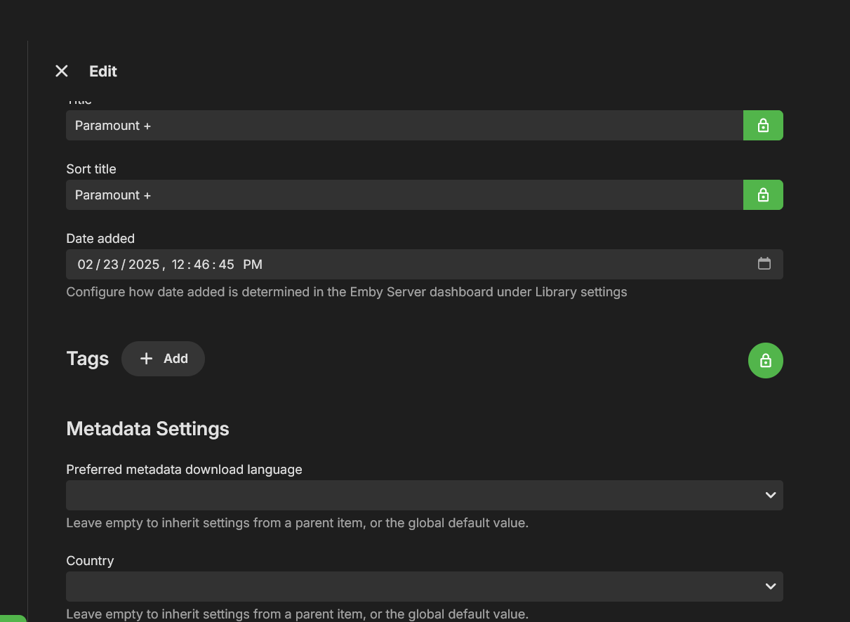

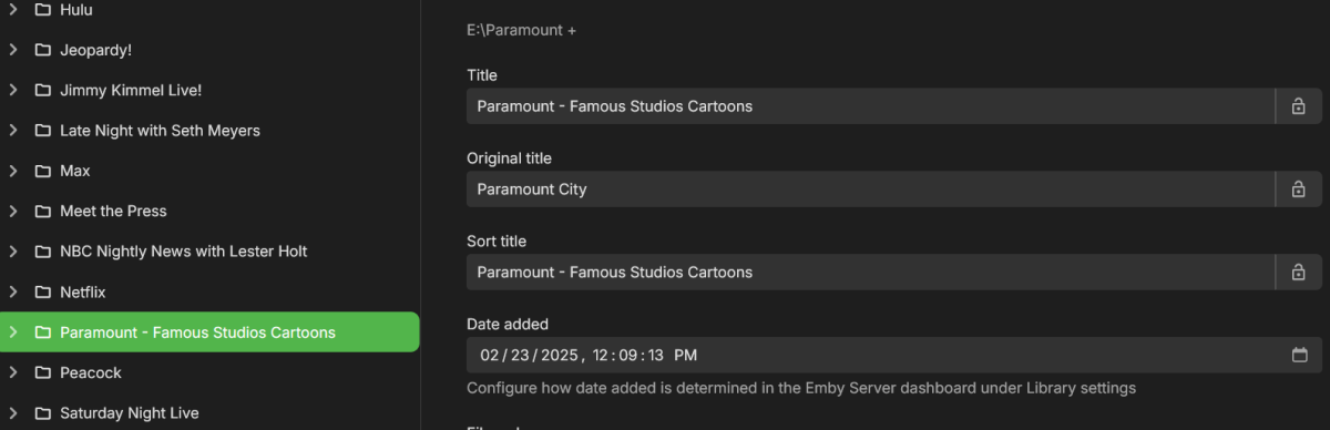

classic57ba@gmail.com 0 Posted February 23, 2025 Posted February 23, 2025 I have my Recorded TV file structure as such: E:\StreamingWebSiteName\SeriesName\Seasonnumber\episodes. Example: E:\Paramount+\The Daily Show\The Daily Show_S30E19_February 5, 2025.mvk. Thais has worked great for a long time until today. There are many subfolders under Paramount + such as FBI, Ghosts, etc. The folder Paramount + is just a folder like Netflix and HULU. I created the folder and "locked" it so it could not be changed in EMBY. See EMBY1.png for example. I downloaded the series 1923 which is a Paramount + series. EMBY immediately assumed 1923 was a season of Paramount + and changed Paramount + to Paramount - Famous Studios Cartoons and downloaded Metadata for the "series". See EMBY.png for an example. Am I missing a setting that will stop EMBY from adding Metadata to a folder?

Happy2Play 9798 Posted February 23, 2025 Posted February 23, 2025 (edited) Yes number named shows can throw Emby's detection system off so most likely 1923 is seen as a season folder making Paramount + a Series folder. You can try to add the year to your Series folders ie 1923 (2022) as there are a few topics on the issue of nested folder structures. Edited February 23, 2025 by Happy2Play

classic57ba@gmail.com 0 Posted February 23, 2025 Author Posted February 23, 2025 Happy2Play, thanks. I have "temporarily" addressed the issue with removing all content from that folder and re-adding them. I agree that the addition of year would address this issue but the episodes are downloaded in the background and I have no control over the naming convention of an individual series. They could (and probably would) hit the folder without my being able to intercept them and change the name. When I look at the "Metadata Manager" it has 2 subdirectories. "Shows" and "Folders". Actual folders do not show up in the "Shows" subdirectory so EMBY knows at some point this is just a folder. I would think the "Lock" switches would have some impact. Shouldn't the "Lock" switch on a specific folder have some impact on this issue? If not, what does the "lock" switch actually do?

Luke 42178 Posted February 28, 2025 Posted February 28, 2025 Right the lock is a metadata lock. It doesn't lock it out of the basic scanning engine. Are you mixing movies and series together under your network folders?
