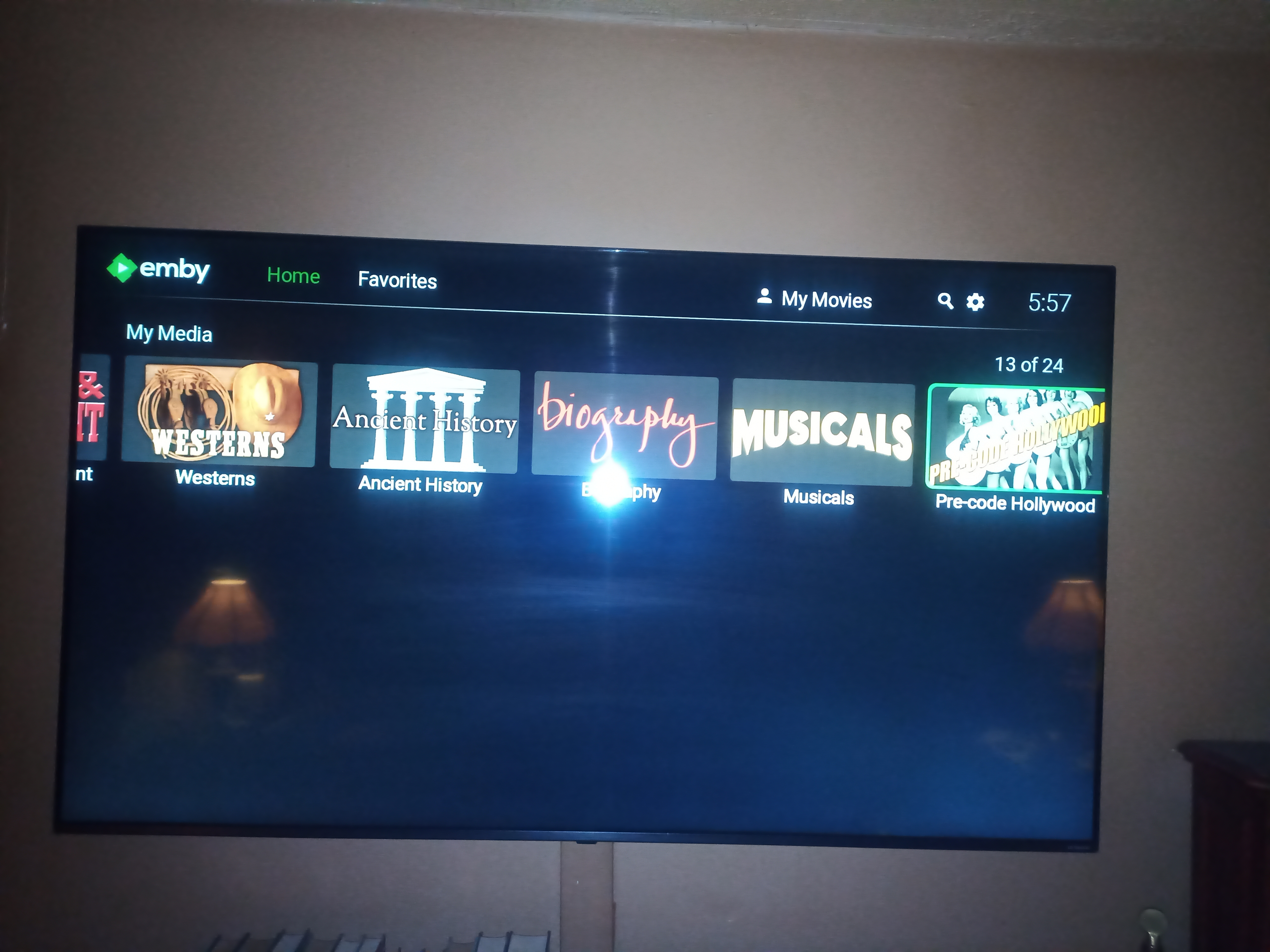

sbourwest 0 Posted February 23, 2025 Posted February 23, 2025 Some issues I'd like to see if there's a workaround, plugin, or potential fix for. On the Emby home screen, folder images with transparency show a gray background on thumbnails. On older versions there was no background and transparency worked better. Also the horizontal scroll has issues. In previous versions the selection box was centered and only moved right or left when at the end (unless wrapped). In fixed view, the selection box is off the screen to the left and you can't see the full thumbnail. In float, part of the rightmost thumbnail is cut off on the screen, while the leftmost is almost entirely cut off. First image is float, second is fixed.
ebr 16332 Posted February 23, 2025 Posted February 23, 2025 Hi. That's very odd. What is the display device and at what resolution?
ebr 16332 Posted February 23, 2025 Posted February 23, 2025 The backgrounds are by design for uniformity.
speechles 2062 Posted February 23, 2025 Posted February 23, 2025 Is the TV in zoom mode or something? Overscan is turned on? Is this a 720P TV and you set it up in the Roku settings at 1080P? Do other Roku apps have the same issue on the TV and the edges are also missing?

StuBailey 35 Posted March 26, 2025 Posted March 26, 2025 I did restart it. You can even just switch users to see the effect instead of exiting. I just had it backwards thinking FLOAT was the issue so it's fixed that I see exactly like the original poster showed in pics. My tv is 1080p but i tried 720 in the roku settings and it's the same problem. I'm just discussing it, not trying to press for a fix.
ebr 16332 Posted March 26, 2025 Posted March 26, 2025 Correct, it is the "fixed" scrolling that can create this issue. That is really not a widely used option so we may just need to remove it if this becomes too common.
