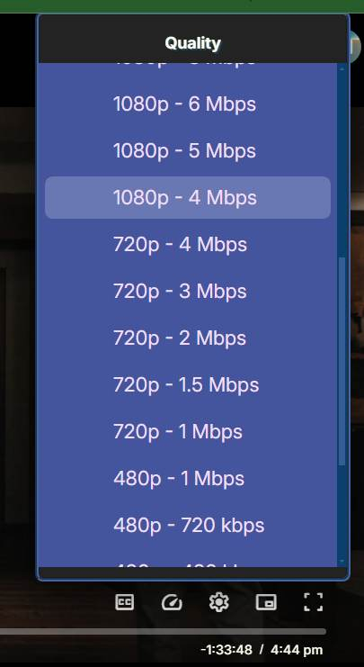

yocker 1363 Posted February 23, 2025 Posted February 23, 2025 Might have stumbled on a bug where changing quality can make it seem like Emby has failed with a black screen but in fact it is trying to download the whole video in background before resuming playback. This can be observed by fx. using Windows Egde -> F12 -> Network and then looking at amount transferred, continue to change quality until bug happens. Shouldn't be hard to replicate. Only way to temporary fix it is to stop video and start it again, this sadly often makes the video start from the beginning. Have this happen with Emby Apps as well as i can observe the traffic on my network. This can really consume bandwidth on slower connections.

yocker 1363 Posted February 23, 2025 Author Posted February 23, 2025 My version of Emby is 4.8.10. It doesn't seem to matter what client or app that's used to play a video, the bug will be there and can and will happen so i figure it must be server sided. Tried with everything from, Chrome, Windows Edge, Firefox, Emby for Android, Emby for WebOS, Chromecasting and Iphone. Sorry didn't think of that, some clients might only give the option to change birate but sticking with Windows Edge (for simplicity) i know that when playing a 4K video there you get the option to downscale to 1080p or other resolutions when selecting quality. Just in case to make 100% sure there is no misunderstanding. I'm talking about the changing quality using the cogwheel in the video player, not in playback settings of Emby.

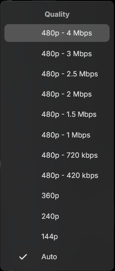

speechles 2060 Posted February 23, 2025 Posted February 23, 2025 (edited) 43 minutes ago, yocker said: I'm talking about the changing quality using the cogwheel in the video player, not in playback settings of Emby. web app roku When you change it from inside the video player with the gear/cog the apps will only give you options for the resolution you are playing. For example playing a 480P item I only get options related to 480P and lower. You cannot gain quality from within the video player. The setting inside the main playback settings of each app gives you the full quality menu. 9 hours ago, yocker said: continue to change quality until bug happens. Shouldn't be hard to replicate. Why? What is the purpose for changing quality like that? Are we simulate someone on a really horrible connection and they keep dropping down and down until it plays without buffering? Or just trying to break it by fiddling with it constantly? Are there any ffmpeg logs created? Those might shed light since changing quality lower and lower should eventually cause transcoding. Edited February 23, 2025 by speechles
