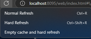

Solution Happy2Play 9798 Posted February 23, 2025 Solution Posted February 23, 2025 But in the end every server update will have some breaking change and you will have to reevaluate all the code you change. So you will want to have a test server running the beta branch also. Just now, AngusAranda said: Oh so back to the cache: How do I clear / delete the cache because I modified those files but I don't see the changes, even after restarting the server and for good measure I made sure with system and system.old were edited. Open the debug console (F12) on Emby page and right click the page refresh button. 1

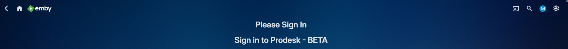

AngusAranda 1 Posted February 23, 2025 Author Posted February 23, 2025 (edited) On the login screen for the emby web interface when you're selecting different users there's two lines of text. The top line says: "Please sign in" and the line below it says: "Sign in to {Server name}". I can't seem to find that text in any of the files and I want to get rid of one of those lines. Edited February 23, 2025 by AngusAranda
AngusAranda 1 Posted February 23, 2025 Author Posted February 23, 2025 3 minutes ago, Happy2Play said: But in the end every server update will have some breaking change and you will have to reevaluate all the code you change. So you will want to have a test server running the beta branch also. Open the debug console (F12) on Emby page and right click the page refresh button. Ayeeeeee this worked perfectly!!! Thank you sir! I thought everyone was referring to the server cache, not my browser cache lol Sometimes I'm so logical, I'm stupid

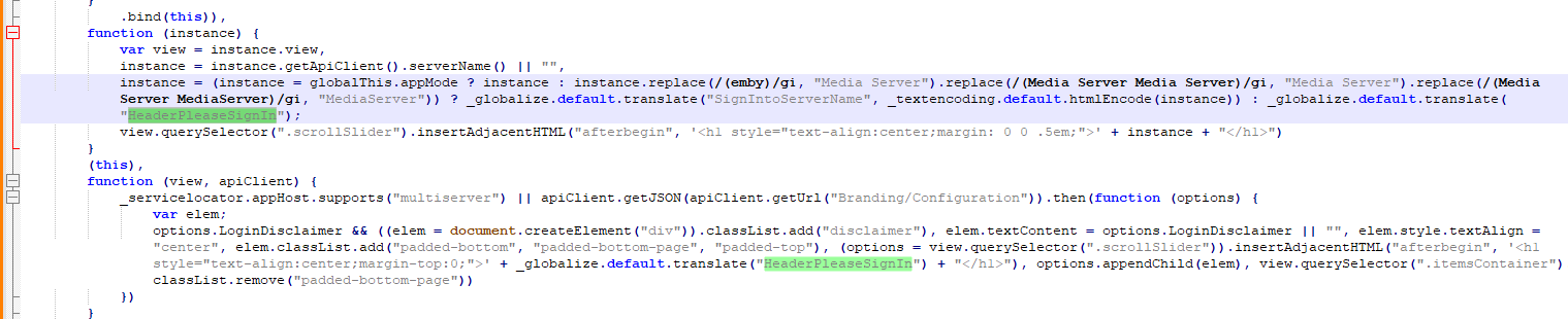

Happy2Play 9798 Posted February 23, 2025 Posted February 23, 2025 1 minute ago, AngusAranda said: On the login screen for the emby web interface when you're selecting different users there's two lines of text The top line says sign in and the line below it says please sign in. I can't seem to find that text in any of the files and I want to get rid of one of those lines. You mean this? As I believe this are scripted back to the language stings. 1
AngusAranda 1 Posted February 23, 2025 Author Posted February 23, 2025 Just now, Happy2Play said: You mean this? As I believe this are scripted back to the language stings. Sweet I'll start checking those files next. Thank you
Happy2Play 9798 Posted February 23, 2025 Posted February 23, 2025 (edited) Note there are two stings folders and this specific one would be \system\dashboard-ui\modules\common\strings and your specific language setup. login.js string json "HeaderPleaseSignIn": "Please Sign In", "SignIntoServerName": "Sign in to {0}", Edited February 23, 2025 by Happy2Play added info 1
