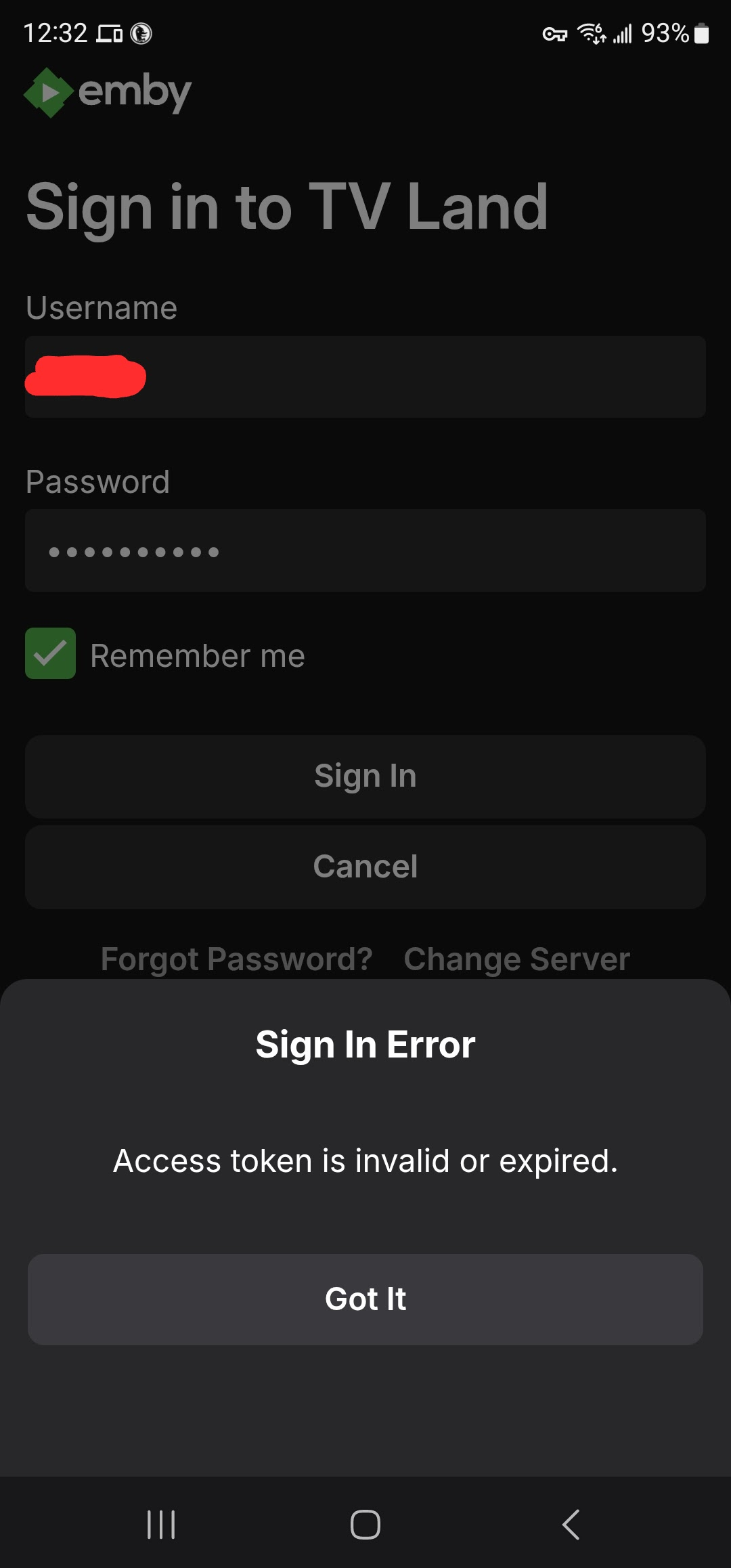

Nvitalian 8 Posted February 22, 2025 Posted February 22, 2025 (edited) Wrong Area: This should be in Docker, Sorry. I've dug around but I'm not finding anything that matches my situation. Apologies ahead of time if I missed something. Emby Container Version 4.8.10.0 Everything locally is fantastic, I have no issue with any of the users I've created. I can not get any user to auth remotely though, I get the token error. I've double-checked all users have the tick box checked: "Allow remote connections to this Emby Server. If unchecked, all remote connections will be blocked." Happy to upload any configs or anything else needed. Thank you in advance. Emby Server Log.txt Edited February 22, 2025 by Nvitalian Wrong Area: This should be in Docker, Sorry.

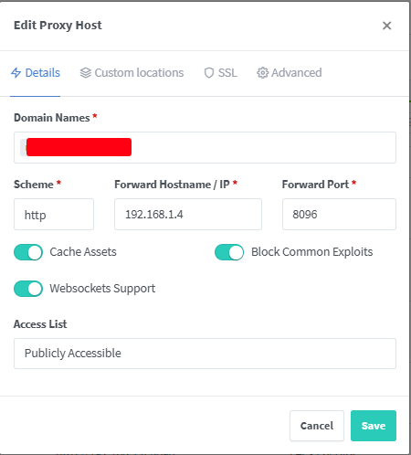

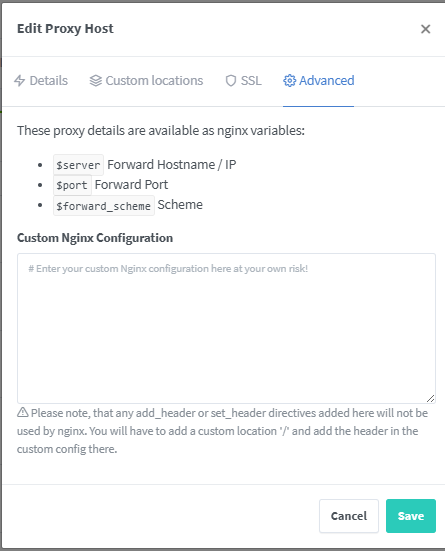

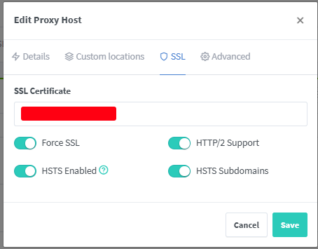

Nvitalian 8 Posted February 26, 2025 Author Posted February 26, 2025 (edited) If I need to close this down and open a new post please let me know. So what I can't figure out is Emby is running as a container. It's connected to the host network. Publicly, it has its own subdomain. A record pointed to NPM. Is there an environment variable I'm supposed to be setting to do subdomain? I see the issue with the GET coming through and no POST and the rewrite through NPM does nothing. In Emby I have the External domain set in network settings. Wondering if I should dump using a Truenas "App" and build the container through portainer or cli. Thanks in advance. Edited February 26, 2025 by Nvitalian
Nvitalian 8 Posted February 26, 2025 Author Posted February 26, 2025 (edited) I should add this token issue only occurs via the Android app. Going through a browser is fine. But... If you sign in via Emby Connect, select the server, you can pass through just fine. Edited February 26, 2025 by Nvitalian

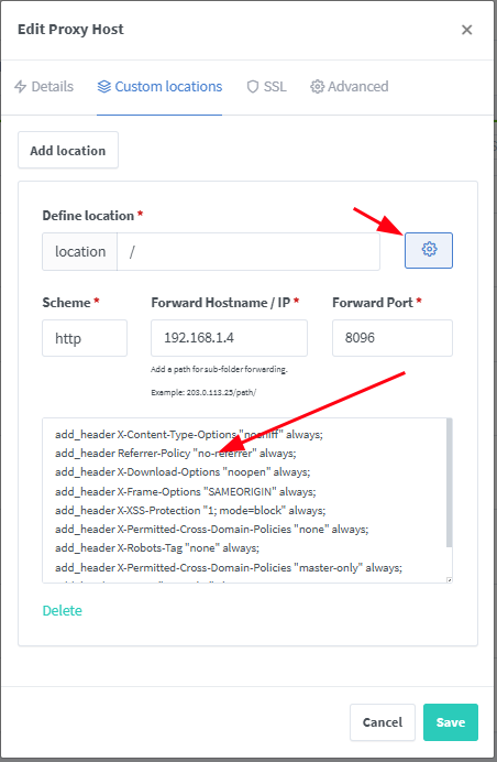

Neminem 1623 Posted February 26, 2025 Posted February 26, 2025 Here is some hints, on how I got it working with NPM. I use awsome.domain.com add_header X-Content-Type-Options "nosniff" always; add_header Referrer-Policy "no-referrer" always; add_header X-Download-Options "noopen" always; add_header X-Frame-Options "SAMEORIGIN" always; add_header X-XSS-Protection "1; mode=block" always; add_header X-Permitted-Cross-Domain-Policies "none" always; add_header X-Robots-Tag "none" always; add_header X-Permitted-Cross-Domain-Policies "master-only" always; add_header Pragma "no-cache" always; add_header Cache-Control "no-store" always; Its not pretty and its not secure in anyway, I only get a B, something about "Content Security Policy (CSP)" that I never could get working in the NPM webui. but it works for me. 3

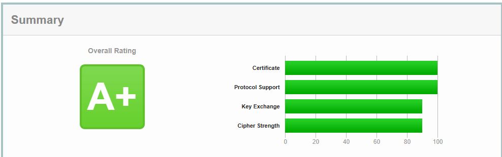

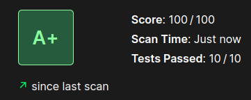

Lessaj 484 Posted February 26, 2025 Posted February 26, 2025 22 minutes ago, Neminem said: What testing service is this? I want to check mine, I get an A+ with Qualys but I don't think they check CSP.
Neminem 1623 Posted February 26, 2025 Posted February 26, 2025 Its from this test HTTP Header Security Test - HTTP Observatory | MDN 2
