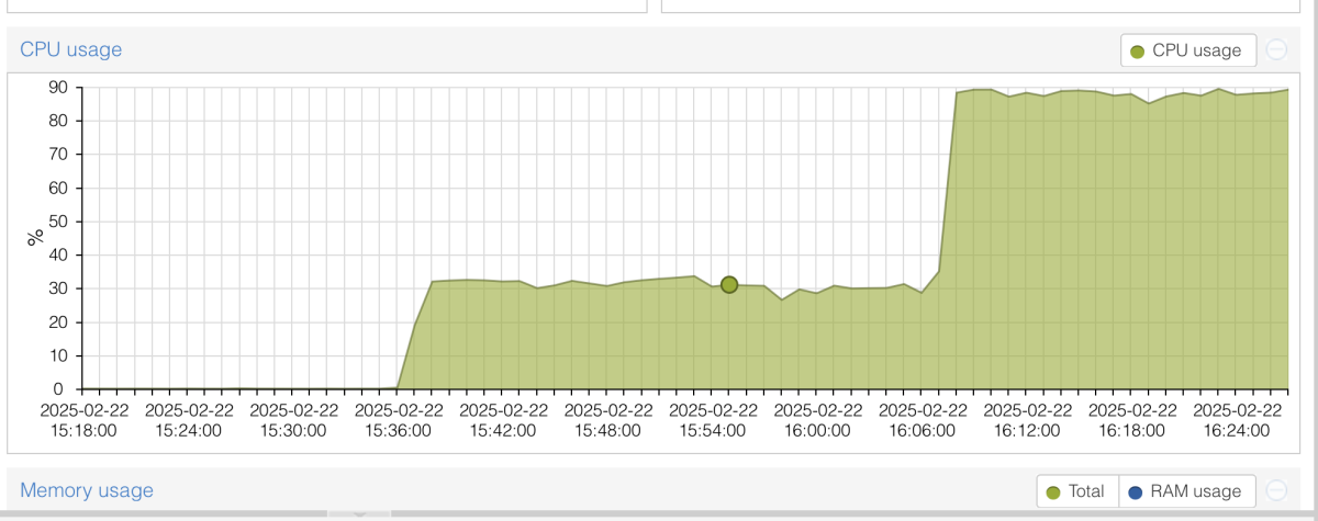

julianr 0 Posted February 22, 2025 Posted February 22, 2025 Hello, I have a problem with Live TV playback of some channels from an VU+ Receiver. The strange thing is, it only happens to a specific group of tv programs: Channels which are decrypted from a smartcard. Other programs which are FTA or from another smartcard runs without a stopping. Emby shows that the stream is running but it is hanging at a specific time. Also if i stream the same channel on 2 or 3 Devices, all streams stops at the same position. in the embyserver log there are no errors, but the ffmpeg log says that trancode files are opened but no frames are written. 15:06:48.459 [segment @ 0x35a0bf80] Opening '/media/ssd/embyr/transcoding-temp/158F9A/158F9A_607.ts.tmp' for writing 15:06:49.145 elapsed=00:30:19.86 frame=45557 fps= 25 q=28.0 size=N/A time=00:30:22.03 bitrate=N/A throttle=off speed= 1x 15:06:49.958 elapsed=00:30:20.67 frame=45571 fps= 25 q=28.0 size=N/A time=00:30:22.63 bitrate=N/A throttle=off speed= 1x 15:06:50.673 elapsed=00:30:21.39 frame=45592 fps= 25 q=28.0 size=N/A time=00:30:23.53 bitrate=N/A throttle=off speed= 1x 15:06:51.375 elapsed=00:30:22.09 frame=45612 fps= 25 q=28.0 size=N/A time=00:30:24.42 bitrate=N/A throttle=off speed= 1x 15:06:51.449 [segment @ 0x35a0bf80] Opening '/media/ssd/embyr/transcoding-temp/158F9A/158F9A.m3u8.tmp' for writing 15:06:51.450 SegmentComplete=video:0 Index=607 Start=1822.280000 End=1825.280000 Duration=3.000000 offset_pts=0 start_pts=1822280000 Frames=75 filename=hls/158F9A/158F9A_607.ts 15:06:51.450 [segment @ 0x35a0bf80] Opening '/media/ssd/embyr/transcoding-temp/158F9A/158F9A_608.ts.tmp' for writing 15:06:51.482 http://127.0.0.1:8096/LiveTv/LiveStreamFiles/0a7d967fd74e40c4b466c695a47f4960/stream.ts: corrupt decoded frame in stream 1 15:06:51.875 elapsed=00:30:22.60 frame=45628 fps= 25 q=28.0 size=N/A time=00:30:25.02 bitrate=N/A throttle=off speed= 1x 15:06:51.893 http://127.0.0.1:8096/LiveTv/LiveStreamFiles/0a7d967fd74e40c4b466c695a47f4960/stream.ts: corrupt decoded frame in stream 1 15:06:52.006 [mpegts @ 0x35991700] DTS 3242972375 < 10046689008 out of order 15:06:52.374 http://127.0.0.1:8096/LiveTv/LiveStreamFiles/0a7d967fd74e40c4b466c695a47f4960/stream.ts: corrupt decoded frame in stream 1 15:06:52.382 More than 1000 frames duplicated 15:06:53.042 [segment @ 0x35a0bf80] Opening '/media/ssd/embyr/transcoding-temp/158F9A/158F9A.m3u8.tmp' for writing 15:06:53.042 SegmentComplete=video:0 Index=608 Start=1825.280000 End=1828.280000 Duration=3.000000 offset_pts=0 start_pts=1825280000 Frames=75 filename=hls/158F9A/158F9A_608.ts 15:06:53.042 [segment @ 0x35a0bf80] Opening '/media/ssd/embyr/transcoding-temp/158F9A/158F9A_609.ts.tmp' for writing 15:06:53.196 [segment @ 0x35a0bf80] Opening '/media/ssd/embyr/transcoding-temp/158F9A/158F9A.m3u8.tmp' for writing 15:06:53.197 SegmentComplete=video:0 Index=609 Start=1828.280000 End=1831.280000 Duration=3.000000 offset_pts=0 start_pts=1828280000 Frames=75 filename=hls/158F9A/158F9A_609.ts 15:06:53.197 [segment @ 0x35a0bf80] Opening '/media/ssd/embyr/transcoding-temp/158F9A/158F9A_610.ts.tmp' for writing 15:06:53.344 [segment @ 0x35a0bf80] Opening '/media/ssd/embyr/transcoding-temp/158F9A/158F9A.m3u8.tmp' for writing At 15:06:48.459 there the last correct writing of the trancoding file, then the error occurs and the stream stops. When the stream is hanging, the cpu utilization is at a very high level (the see attachment). If i run the m3u in m3u players there are no problems.

Carlo 4561 Posted February 25, 2025 Posted February 25, 2025 II bet the high CPU starts where "15:06:52.382 More than 1000 frames duplicated" is logged. It sounds like you have 2 smartcards. Is it possible for you to switch the position of the smartcard? If so, this would show if the issue follows the smartcard or only happens on a specific tuner. If it follows the smartcard, I'd ask the provider to reset the smartcard and send a new setup to it or have them replace the card. BTW, which hardware tuners are you using? Do you have the ability to connect them directly to Emby or is VU+ required?
julianr 0 Posted February 28, 2025 Author Posted February 28, 2025 yes, at this time the cpu utilization rizes. Changing the smartcards does not help. The error is independent from the tuner. I have a VU+ Uno 4K with FBC Tuner. I thought maybe to connect TvHeadend via Sat>IP but that is not so uncomplicated. I would like to have an easier solution.
