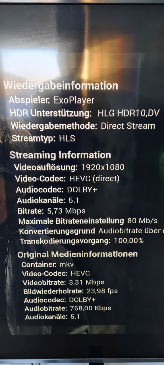

kingom 6 Posted February 20, 2025 Posted February 20, 2025 I have a reproduceable issue with my firetv. Problem: At the End of an episode, around 5-10minutes before it ends (depends on how long the episode is), playback starts freezing every now and then. I can play a 45minute file with no problems until i reach 5-7minutes before it ends. Then it starts freezing. After 30-60 seconds it resumes playing, after another 30-60 seconds it again freezes, then plays, freezes, plays, etc. until the file is done. It freezes about as long as it then plays again until the next freeze. Steps i already tried: It occures with every firetv stick i tested (4 so far). It occures independent of the user. It does not occure when watching with LG APP. It does not occure when watching with browser. It does not occure when i set quality so low that the file needs to be transcoded. I can only reproduce this with tv shows, not with movies (haven't found the sweetspot in file length) It does not happen with all my files (althoug all the files are encoded the same way (x265 tdarr). it does not matter if i watch the whole file or if i scroll to the end of a file it freezes in both cases. Logs: Logs of the Server and Transcodes are attached. Also a screenshot from stats for nerds If more information is needed please reach out to me. embyserver.txt ffmpeg-directstream-f914ef75-34ec-4e9d-b247-488a0da5535e_1.txt ffmpeg-directstream-757a261b-e227-47ec-85bc-6bc5e2cd4b2b_1.txt ffmpeg-directstream-2fdf61ac-e069-4168-97cf-1d64cf19b310_1.txt ffmpeg-directstream-82456201-e91f-42be-a088-b18896c8e7c0_1.txt

Solution ebr 16336 Posted February 20, 2025 Solution Posted February 20, 2025 Hi. Do you always have subtitles enabled? Does this still occur if you disable them? Can you try searching for our standard android app (Just "Emby" on Amazon and "Emby for Android on Google) on the same device's app store and see how that compares? Thanks.
kingom 6 Posted February 20, 2025 Author Posted February 20, 2025 (edited) 18 minutes ago, ebr said: Hi. Do you always have subtitles enabled? Does this still occur if you disable them? Can you try searching for our standard android app (Just "Emby" on Amazon and "Emby for Android on Google) on the same device's app store and see how that compares? Thanks. It stopps happening when disabling subtiles. Also it's working when using the standard android app. Thanks! Edited February 20, 2025 by kingom 1
