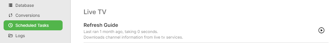

Jator 13 Posted February 20, 2025 Posted February 20, 2025 Sorry if this is self-evident and/or posted previously, I searched through the forum seeing if "guide refresh interval" would give me the answer I was looking for but didn't see a relevant post 4 pages in. What is the interval that XMLTV guides are refreshed? And is there a custom interval setting? I ask because I have docker that supplies Pluto channels into Emby and it only usually has 6-12 hours worth of guide data at a time. My current DVR platform has the ability to refresh a guide in various intervals (3, 6, 12, 24 hours) but haven't found that option here yet. I'm on 4.8.8 if that makes a difference, I can't get 4.8.10 to install or update through Package Manager on my Synology. Thanks, Jay
Solution GrimReaper 5265 Posted February 20, 2025 Solution Posted February 20, 2025 37 minutes ago, Jator said: but haven't found that option here yet. Settings>Scheduled Tasks>Refresh Guide. Click to change/add/delete trigger(s).
