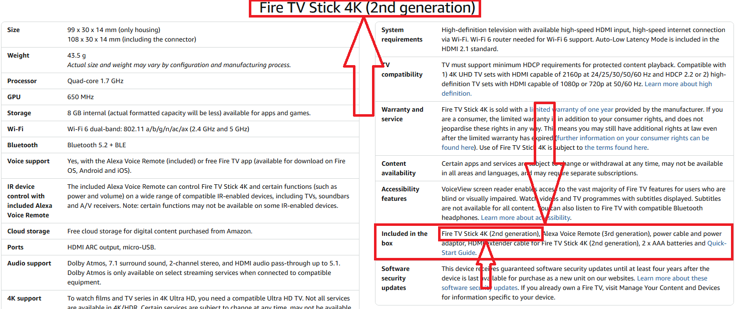

GrimReaper 4898 Posted February 20, 2025 Posted February 20, 2025 13 hours ago, rcsnoopdog said: any recommendations on the cheapest Firestick model that can handle them properly with Emby and HEVC 10 That would appear to be OG Fire TV Stick 4K - 1st Gen (2018). You can check all model specs on the same page, look for "Main 10 profile" under "Video codecs" section, "H.265 (HEVC)" part.

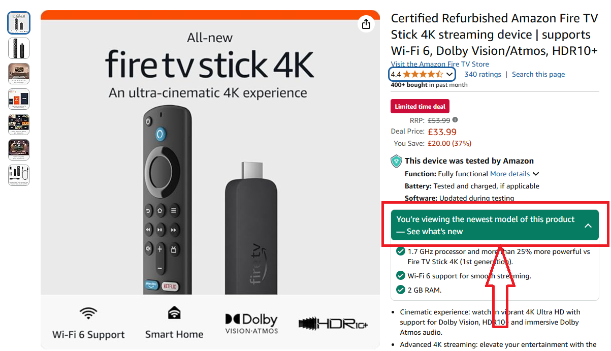

rcsnoopdog 11 Posted February 20, 2025 Author Posted February 20, 2025 44 minutes ago, GrimReaper said: That would appear to be OG Fire TV Stick 4K - 1st Gen (2018). You can check all model specs on the same page, look for "Main 10 profile" under "Video codecs" section, "H.265 (HEVC)" part. Would this one do hevc 10 as i can't find it saying hevc 10 or what year it is Certified Refurbished Amazon Fire TV Stick 4K streaming device | supports Wi-Fi 6, Dolby Vision/Atmos, HDR10+ : Amazon.co.uk: Electronics & Photo
Solution GrimReaper 4898 Posted February 20, 2025 Solution Posted February 20, 2025 14 minutes ago, rcsnoopdog said: Would this one do hevc 10 It sure should. 14 minutes ago, rcsnoopdog said: i can't find it saying hevc 10 or what year it is Its 2nd Gen (2023) - latest, visible at that same link/listing page: Full specs here: Device Specifications: Fire TV Streaming Media Player | Amazon Fire TV 1
