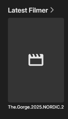

The Gorge would not be identified, at all. But if I'll do a manually search, it finds it straight away.
I don't see anything in my library at all, just a thumb of the movie, and the file name.
So you do see something?
How are your files named and organized?

Yes, kinda. It's like this: Snippet.jpg.9fb3d2a294f8e93a20d3a5eb04fa125a.jpg

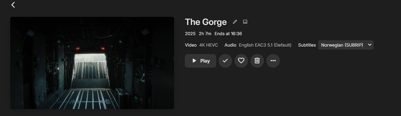

I will try to clean up the naming now, to se if that works. It's just an pain to do. But I see that it can be an problem.

Now I have tested a little bit more. Found out it is a little pickier than I thought on the naming. So I guess I have being lucky before with my bad naming. It didn't even like the "2160p Atmos". Look at log for scan with this:

The I renamed it to "The Gorge (2025) - 4k", looks like it found it. But no meta data, so I'm not sure of this. Heres is the log for that manual lib.scan.

How it looks in the library: image.thumb.jpeg.206719a65c216adf5ec3c6e0a6fab43b.jpeg
So I still think there is something wrong here, but I can't seem to find the problem. And I really think my naming is up to date now?
Edited by PeteGul
Added pic.
Hi, I would try using the identify feature on that title and see if it helps.
That works, and always has, as I have to enter name and pick it my self. But it hasn't just being this movie. I was the LOTR movies to. And this has never been like this before.
