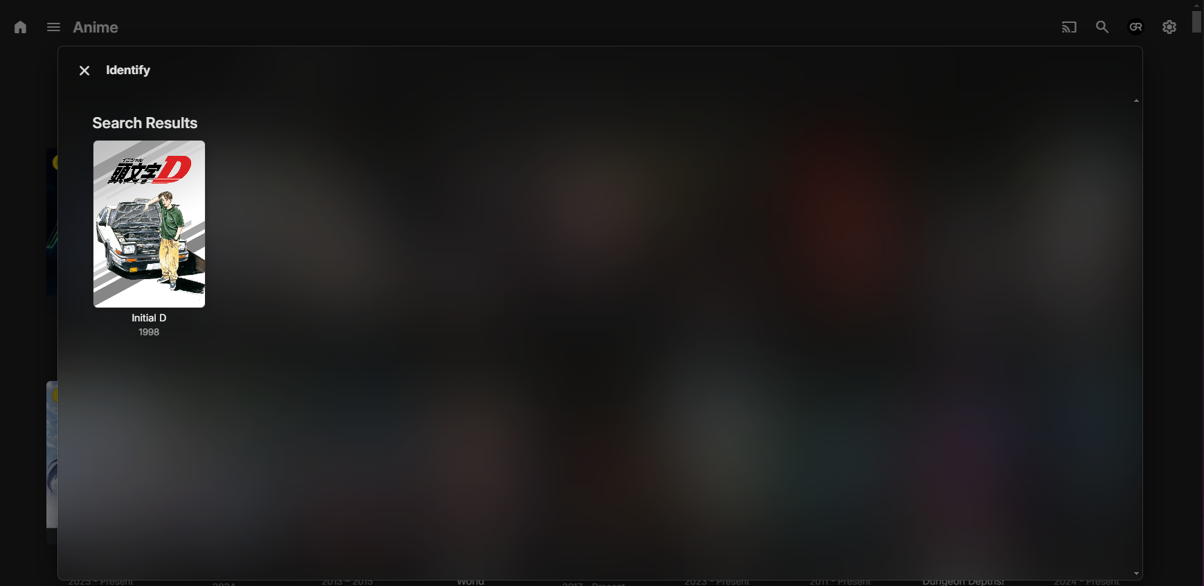

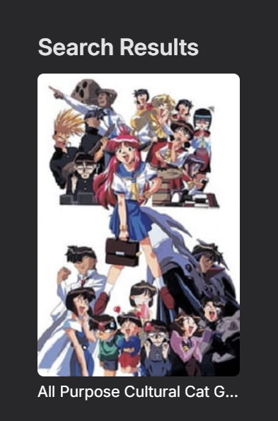

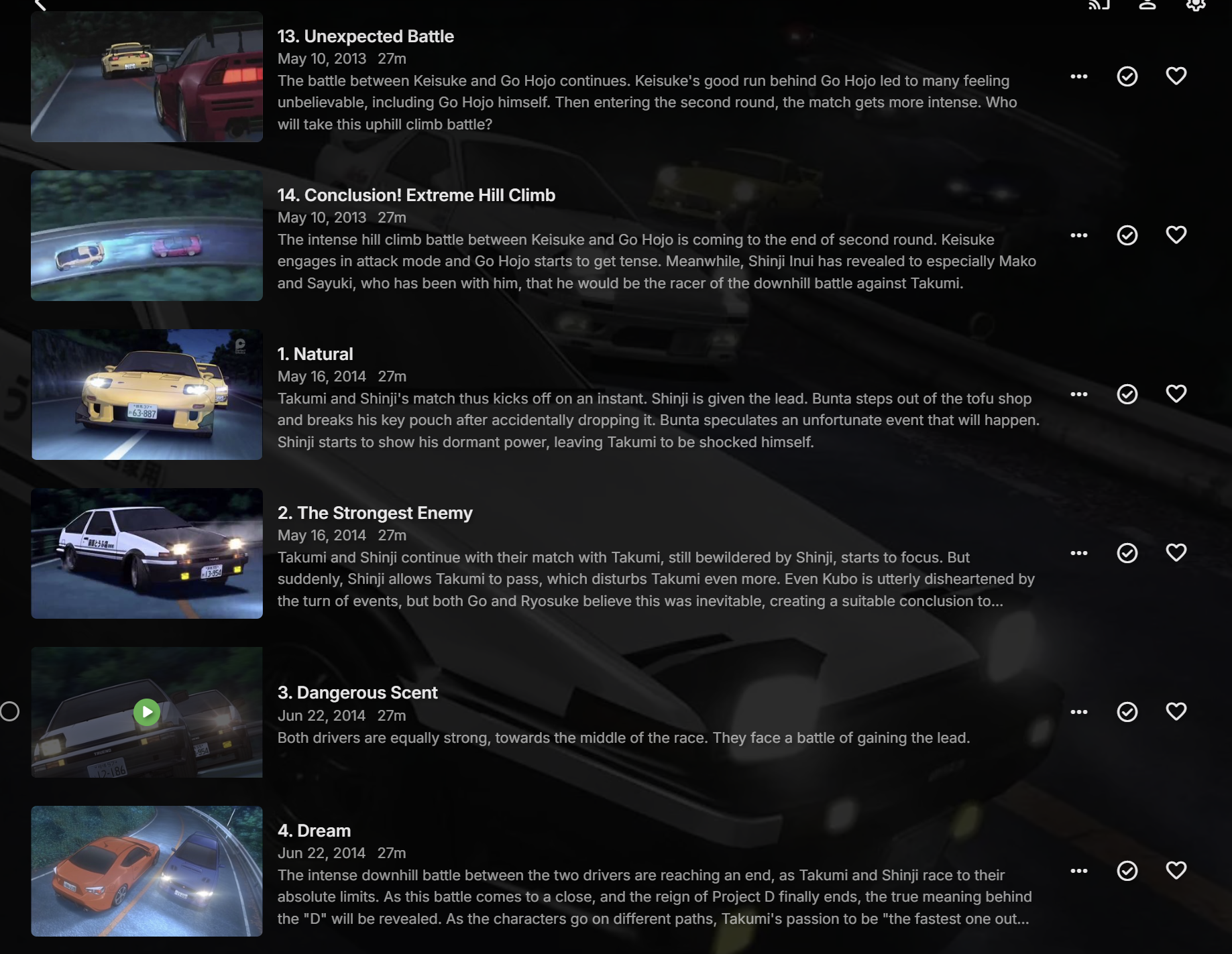

Creaperemby 4 Posted February 19, 2025 Posted February 19, 2025 if you search up initial D to identify Emby, this "all-purpose cultural cat thing" shows up, and if I were to use IMDB for the metadata all seasons display the same release date, a couple of days ago up till season 2 was getting recognized correctly, but now almost nothing is recognizing properly for this anime, movies, other tv shows and music is being recognized correctly.
GrimReaper 5224 Posted February 19, 2025 Posted February 19, 2025 (edited) What server version? What are your enabled meta-providers and in what order? What IMDBId you're using? Have no issues getting correct search result with either Title or IMDBId. Edited February 19, 2025 by GrimReaper Screenshot

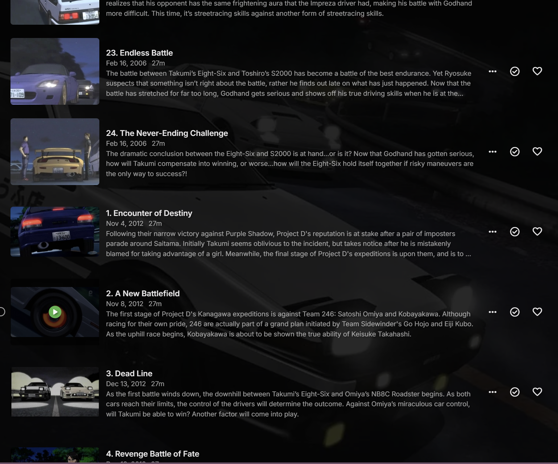

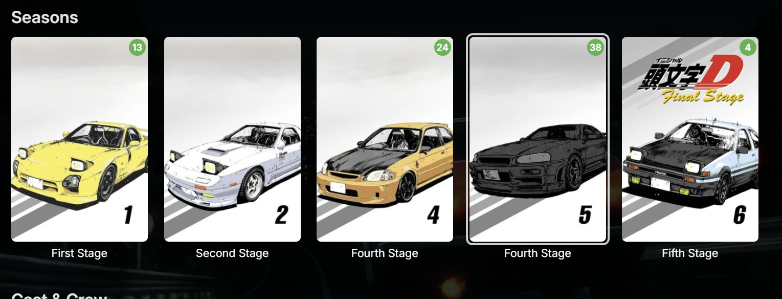

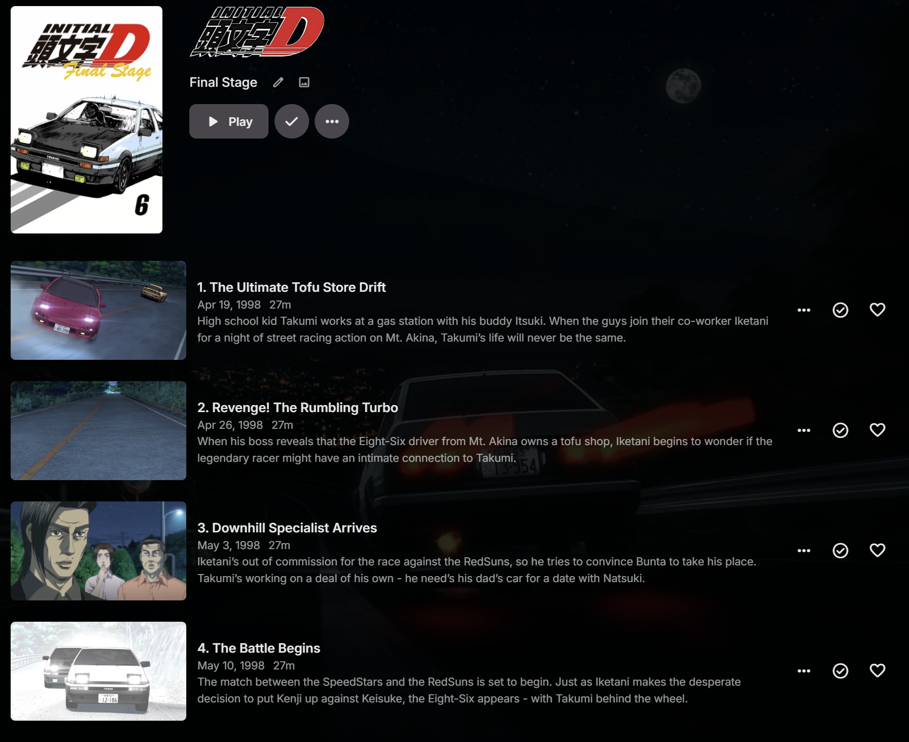

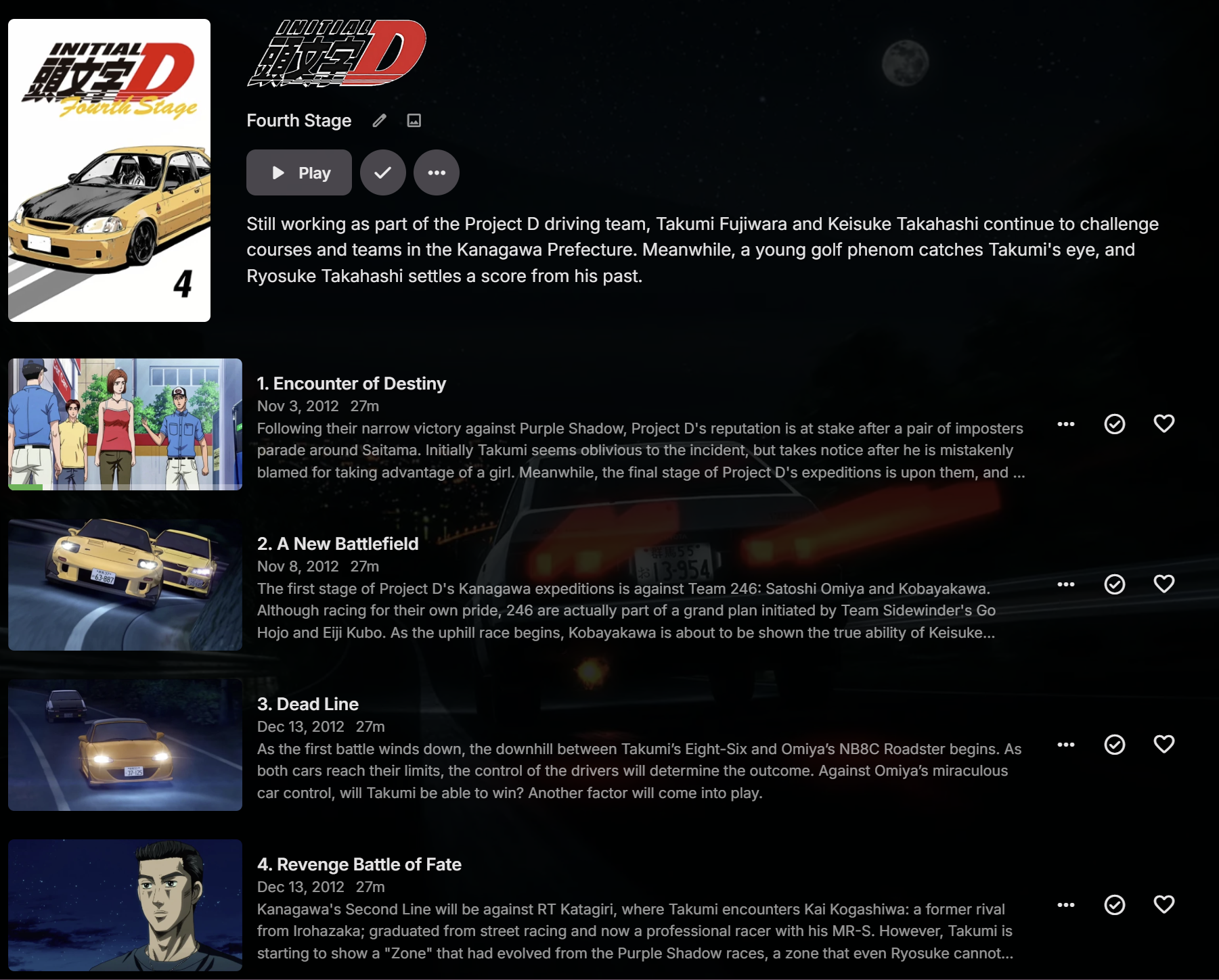

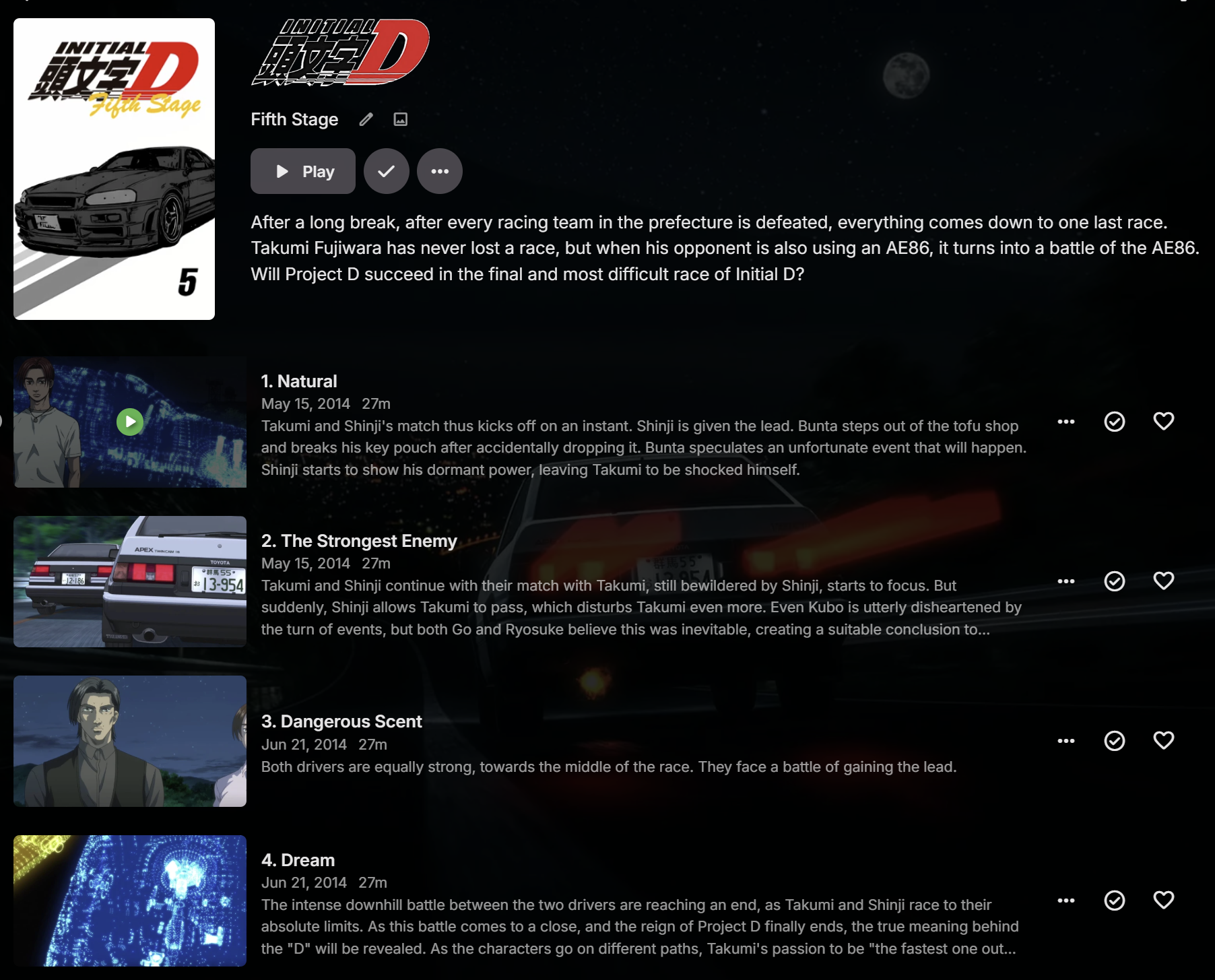

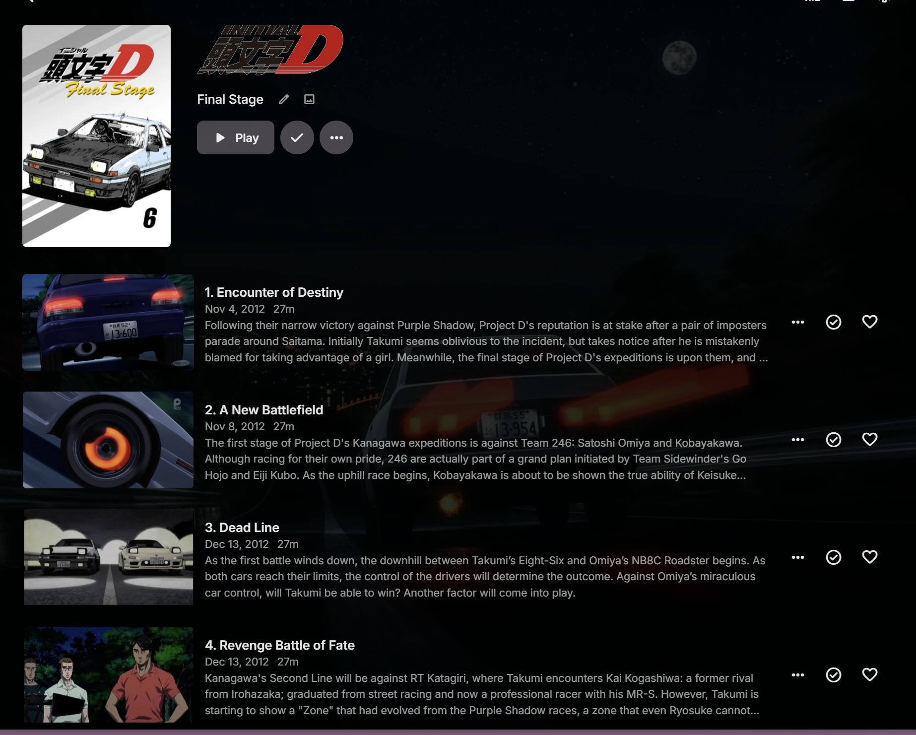

Creaperemby 4 Posted February 20, 2025 Author Posted February 20, 2025 I was able to fix the issue by reordering meta providers, however, it is messing up from season 4, with the episodes of season 4 being recognized as season 5, and ones that don't read properly displaying the season 1 title and description. the 5th season also displays the 6th season. The 6th season just shows the 1st season's data. I am running Version 4.8.10.0 of Emby on an Asustor Nas

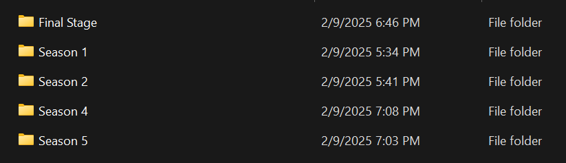

Creaperemby 4 Posted February 20, 2025 Author Posted February 20, 2025 They are organized by season and title

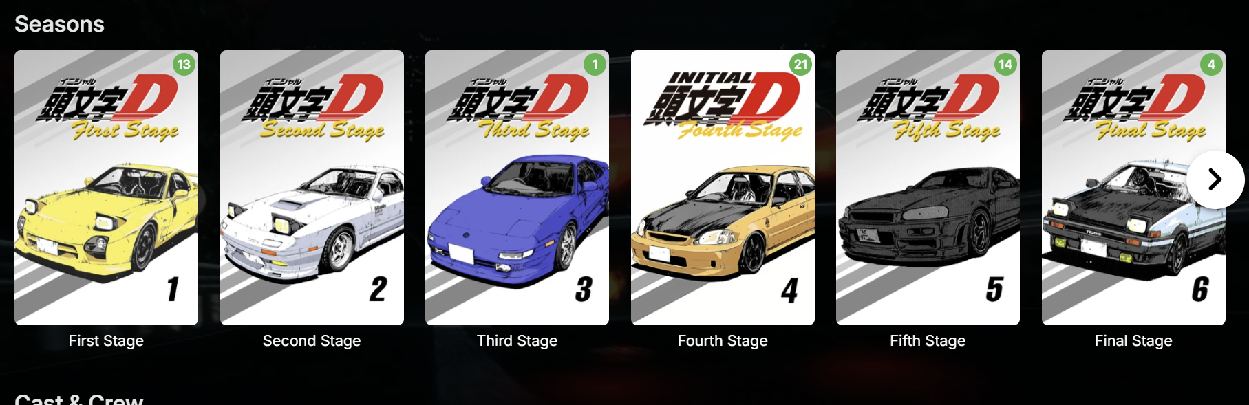

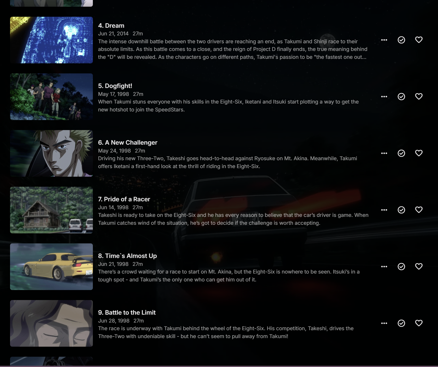

GrimReaper 5224 Posted February 20, 2025 Posted February 20, 2025 For some reason, you're still not providing the info: On 2/19/2025 at 10:34 AM, GrimReaper said: What are your enabled meta-providers and in what order? But based on your screenshots, I'd guess you have TMDB as highest-priority fetcher. 7 hours ago, Creaperemby said: it is messing up from season 4, with the episodes of season 4 being recognized as season 5, and ones that don't read properly displaying the season 1 title and description. the 5th season also displays the 6th season. The 6th season just shows the 1st season's data. As TMDB has only 5 seasons+Specials for that show (contrary to TVDB that has 6 seasons+Specials listed) with Fourth stage as Season 3, Fifth stage as season 4 and Final stage as Season 5 - that's the data you're getting: Fifth stage episode descriptions for Season 4 episodes, Final stage episode descriptions for Season 5 and your Final stage episodes probably cannot cannot be linked to last season due to folder not being named Season 6 (or episode naming within, it is unknown how do you have them numbered) hence being identified as Season 1 episodes. TV Naming You need to either: 1. Rename Final Stage folder to Season 6 2. Move TVDB as your highest-priority meta-fetcher OR 1. Rename Season 4, Season 5 and Final Stage folders and episodes as Season 3, Season 4 and Season 5 respectively if you prefer having TMDB as primary-meta provider Re-Identify the item or Refresh Metadata>Replace all.

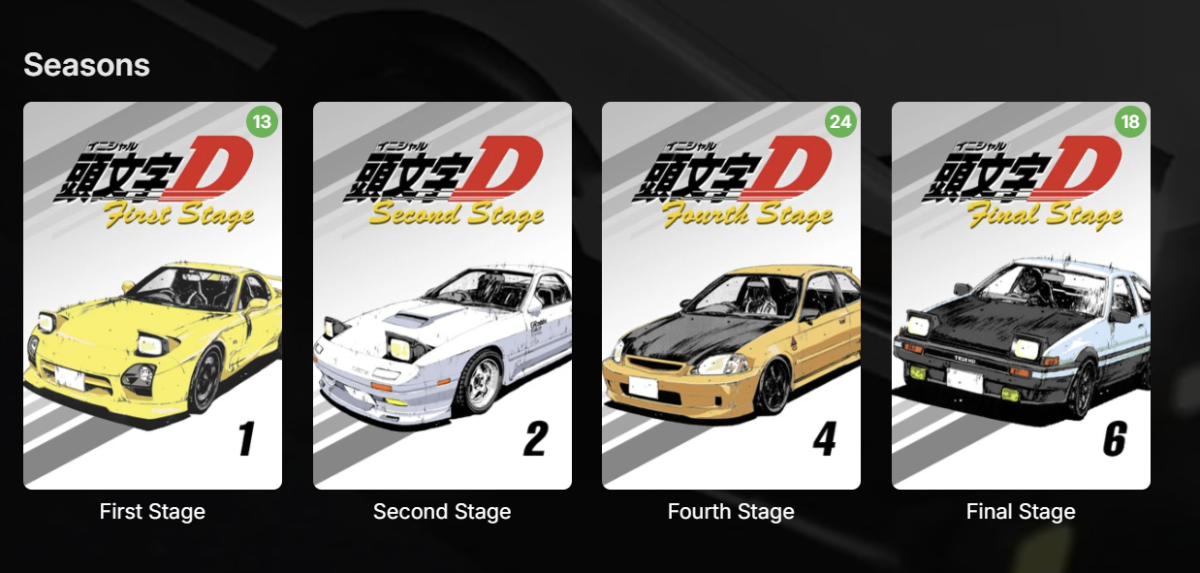

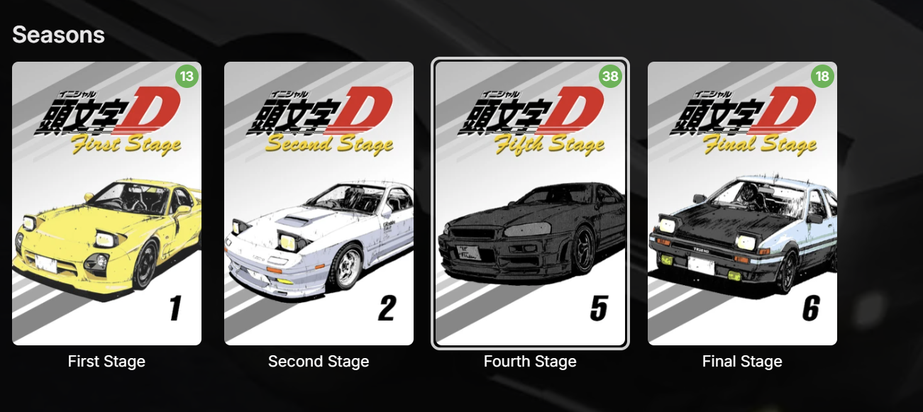

Creaperemby 4 Posted February 21, 2025 Author Posted February 21, 2025 I tried both methods, the TVBD method got me the closest, however, it decided to merge the 4th and 5th seasons into one thing, although the episodes are getting detected properly which is good. the TMBD method did not work properly.
Creaperemby 4 Posted February 21, 2025 Author Posted February 21, 2025 after resetting the metadata again, it now transferred the episodes to the final stage, so season 4 is fixed, however, season 5 and the final season is merged

Creaperemby 4 Posted February 21, 2025 Author Posted February 21, 2025 So with TMBD as the priority fetcher, it puts the season 5 episodes as season 4, and another season 4 that has both season 4 and 5's files in it
pwhodges 2132 Posted February 21, 2025 Posted February 21, 2025 Remember - whenever you change between metadata providers which split the show differently, you have to rename all the episodes to match. The only way any provider can know what season and episode a video file actually contains is from the folder and file names. Paul

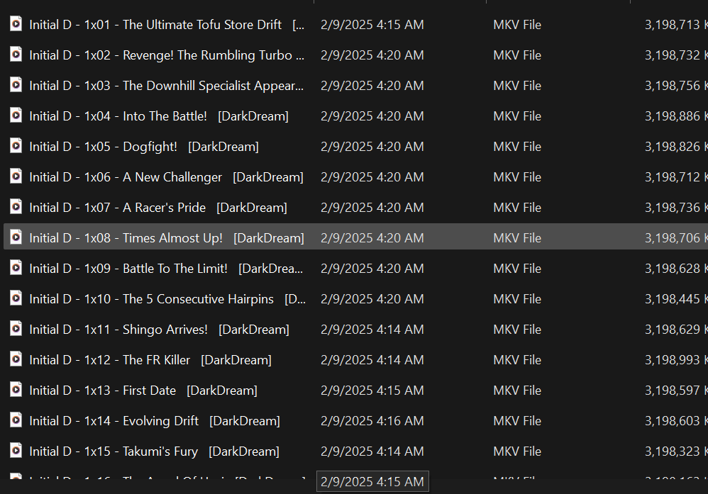

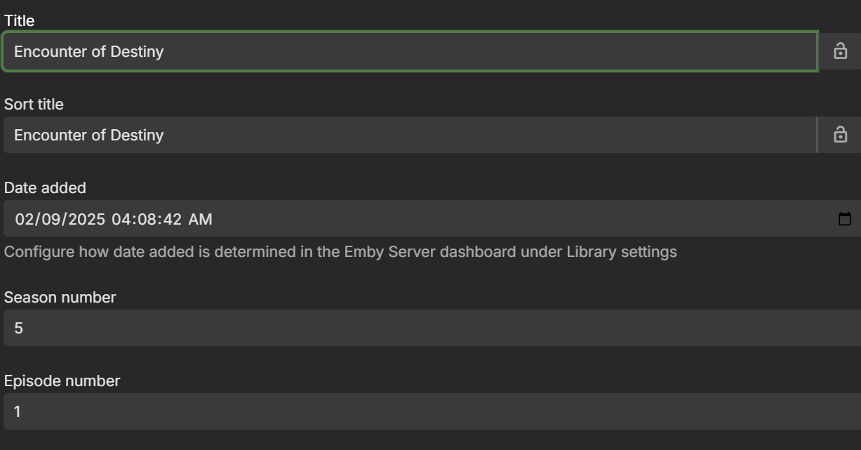

Creaperemby 4 Posted February 22, 2025 Author Posted February 22, 2025 Ok so the episodes are all named correctly, with season number and everything, and the metadata is being recognized as season 5 in Emby too, but it still sorts itself to season 6

Solution Creaperemby 4 Posted February 23, 2025 Author Solution Posted February 23, 2025 I found the fix, and now everything is working correctly. all I had to do was delete the Season 5 folder, make a separate Season 5 folder in the TV shows folder (instead of in the initial D folder), and put in an episode, then drag the Season 5 folder into the initial D folder after Emby recognized the season.
