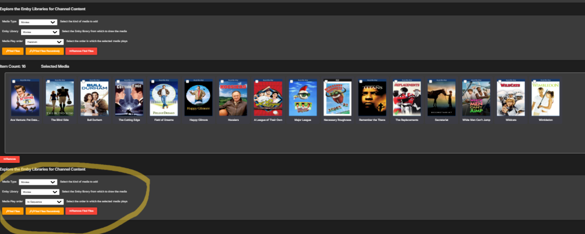

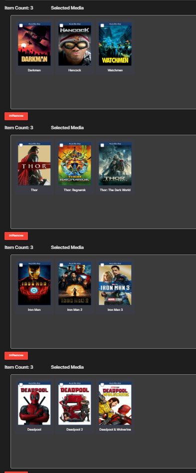

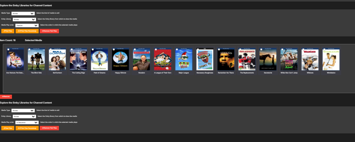

Jator 13 Posted April 26, 2025 Posted April 26, 2025 Still getting inconsistent "random" applicability. Seems like if I add films in several "Batches", it will randomize. This is because on some channels, my films are spread across multiple subfolders. However, if I have a channel with all films in the same folder and don't have to add several "batches", then I get the channel producing in alpha order no matter what I select. Marvel_DC Channels works fine, here's the marvel_dc channel setup (works as intended): Here's the sports that is still running alpha based:
roormonger 6 Posted April 26, 2025 Posted April 26, 2025 7 hours ago, Jator said: Still getting inconsistent "random" applicability. Seems like if I add films in several "Batches", it will randomize. This is because on some channels, my films are spread across multiple subfolders. However, if I have a channel with all films in the same folder and don't have to add several "batches", then I get the channel producing in alpha order no matter what I select. Marvel_DC Channels works fine, here's the marvel_dc channel setup (works as intended): Here's the sports that is still running alpha based: Does it have to do with that? Also have you tried making channels with metadata rather than choosing files? Like, to do marvel and dc movies you could do a search query for the studios. The sports movies channel you could manually add a "sport" tag to each of those movies than make a channel that uses a search query for tag. Would make it easier to remake the channels if you ever need to.
