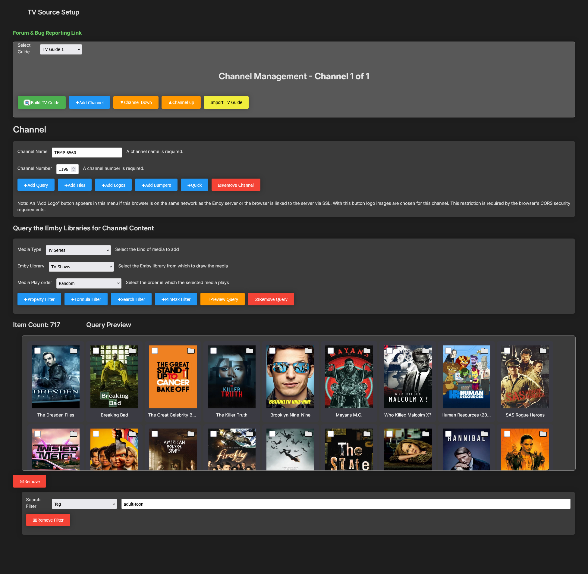

roormonger 6 Posted April 20, 2025 Posted April 20, 2025 4 hours ago, VicMoore said: Just to make sure we are all using the same code, the latest version is attached below. You can recognize that you are running this version by looking for the miss spelling of "import" on the Channel Management menu. If it is spelled as "inport" then you are on the old code. Vic myTV.dll 579 kB · 1 download Ok, so I installed the new version, deleted my tuner, made a new one. The first channel I tried to make was a tv series one. a search for only tag returned my whole tv library in the preview query. I am using Zen browser which is based on Firefox. Shouldn't matter though. It worked before.
VicMoore 755 Posted April 20, 2025 Author Posted April 20, 2025 (edited) OK, something is wrong. I will fix it asap. I know what the problem is: if you have no genre specified the query will return the entire library. In my thinking I just missed this use case. It's not hard to fix. I will work on it in the morning. Thanks so much for bringing this to my attention. Is everything else working OK? thanks @roormonger Vic Edited April 20, 2025 by VicMoore
roormonger 6 Posted April 20, 2025 Posted April 20, 2025 4 minutes ago, VicMoore said: OK, something is wrong. I will fix it asap. I know what the problem is: if you have no genre specified the query will return the entire library. In my thinking I just missed this use case. It's not hard to fix. I will work on it in the morning. Thanks so much for bringing this to my attention. Is everything else working OK? thanks @roormonger Vic I havent done too much messing with it other than testing the tag based search results.
VicMoore 755 Posted April 20, 2025 Author Posted April 20, 2025 @roormonger 10 hours ago, roormonger said: Ok, so I installed the new version, deleted my tuner, made a new one. The first channel I tried to make was a tv series one. a search for only tag returned my whole tv library in the preview query. I am using Zen browser which is based on Firefox. Shouldn't matter though. It worked before. In your test you made a TV Series, did you do this using the "Quick" menu? If not, which menu did you use? vic

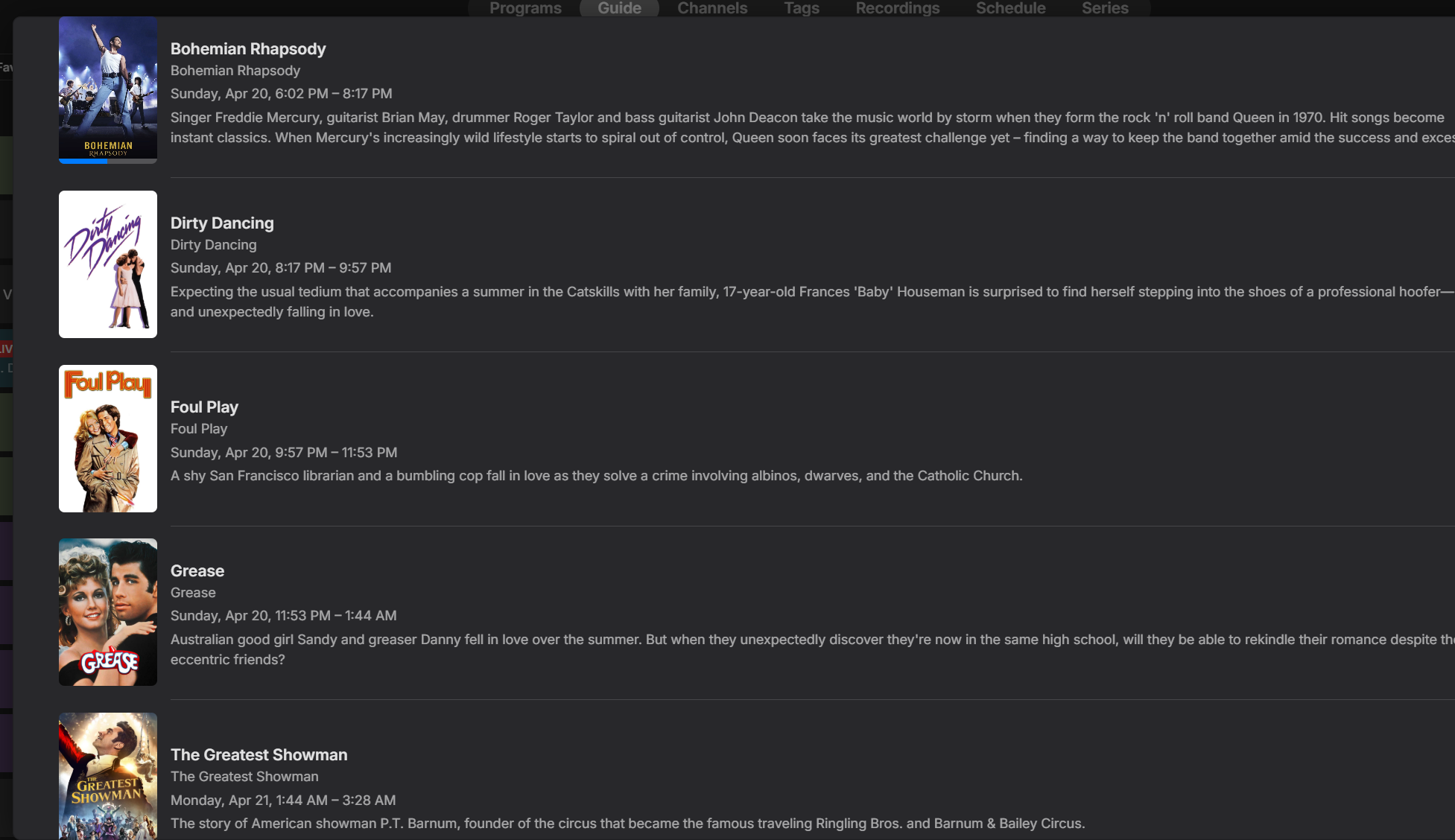

Jator 13 Posted April 20, 2025 Posted April 20, 2025 (edited) 11 hours ago, roormonger said: He means deleting the mytv tuner from the live tv section in Emby and then adding it again. This was a new channel (ie I wasn't just modifying an existing channel). I went ahead and deleted and re-added just to be on the safe side, but still am having the same results, I select random when creating the channel but the guide has the channels in alpha order. I also deleted all TV based channels and started fresh, same problem. Edited April 20, 2025 by Jator

VicMoore 755 Posted April 20, 2025 Author Posted April 20, 2025 @roormongerif you are using the query menu to select content to create a channel and with that menu you choose the media type to be "Tv Series" without choosing a filter you will receive all TV Series in the Emby libraries. This is normal. I am guessing that this is what you did. By the way, this would happen regardless of which media Type you choose. Is this what happened? Vic

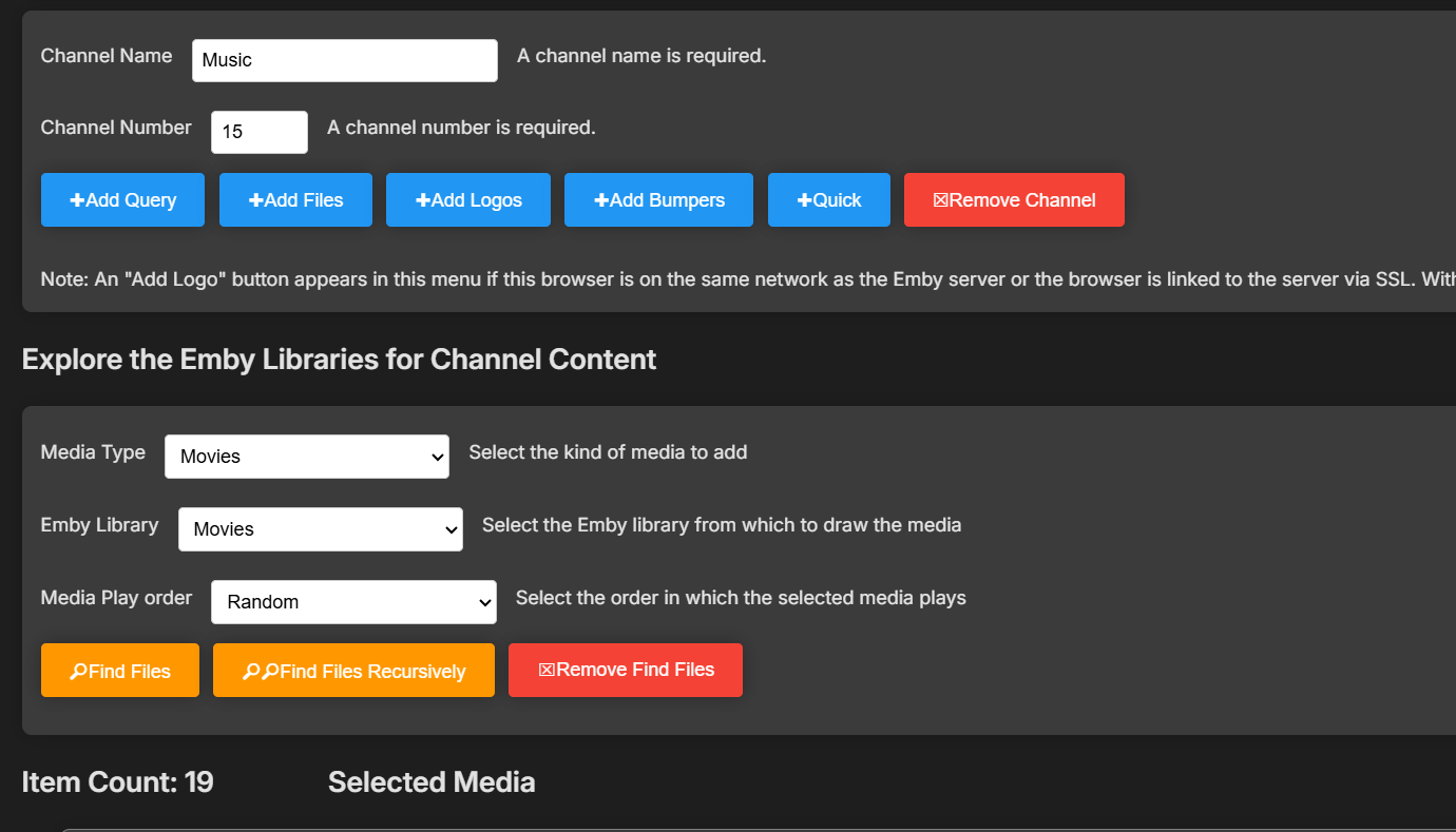

Jator 13 Posted April 20, 2025 Posted April 20, 2025 Not sure what happened, I had thought I had edited my last post but it's disappeared (the edits). I deleted all old channels and created new ones. Only 1 is using random order, all others are still alpha no matter what I select (air date, random, etc). Let me know if there's something I can share with you to see what's causing it to happen on my side:

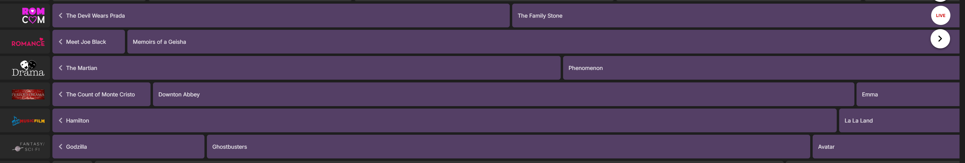

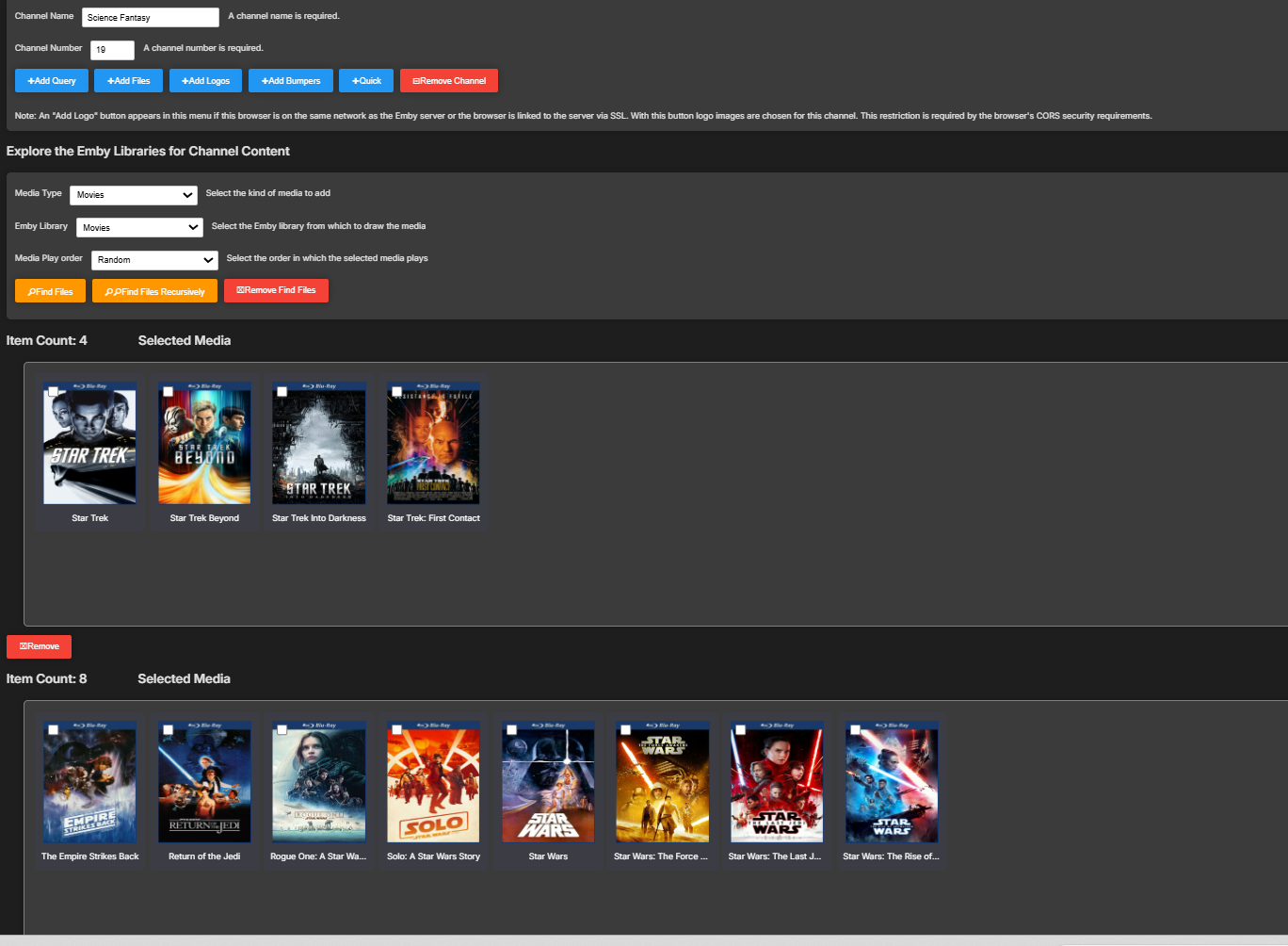

Jator 13 Posted April 21, 2025 Posted April 21, 2025 8 minutes ago, VicMoore said: @Jatoryou are doing a great job. Tonight, I will analyze your results and respond tomorrow. Vic Hey Vic, so here's the channels I have added (you can probably tell the one for me vs the ones for my wife). As you can see below, the one channel "Fantasy SciFi" is not in alpha order, but the other channels are. Very odd. Only thing I can tell you that is setup differently is that in Fantasy/SciFi, I have subfolders so I ended up having to add several "batches" of movies separately (basically each subfolder) as I couldn't find a way to select the movies in the subfolder, save and move over to a separate subfolder in the same navigation pane.
roormonger 6 Posted April 21, 2025 Posted April 21, 2025 7 hours ago, VicMoore said: @roormongerif you are using the query menu to select content to create a channel and with that menu you choose the media type to be "Tv Series" without choosing a filter you will receive all TV Series in the Emby libraries. This is normal. I am guessing that this is what you did. By the way, this would happen regardless of which media Type you choose. Is this what happened? Vic This is how I have always done it. It should have only returned a dozen or so shows.
VicMoore 755 Posted April 21, 2025 Author Posted April 21, 2025 @roormongerI have duplicated the problem. There is something wrong in the search filter. I will work on it tomorrow. Vic
VicMoore 755 Posted April 21, 2025 Author Posted April 21, 2025 (edited) @roormongerThanks so much for pointing this problem out. The key info was seeing that you were using the search filter. The problem was a typo. The new code is below. Vic myTV.dll Edited April 21, 2025 by VicMoore

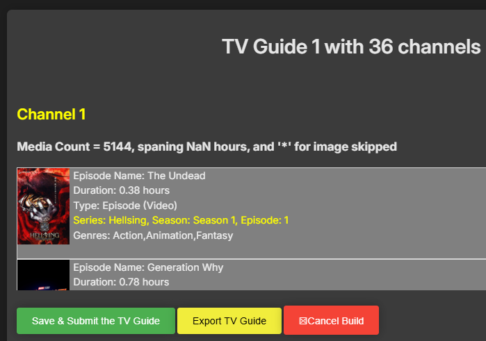

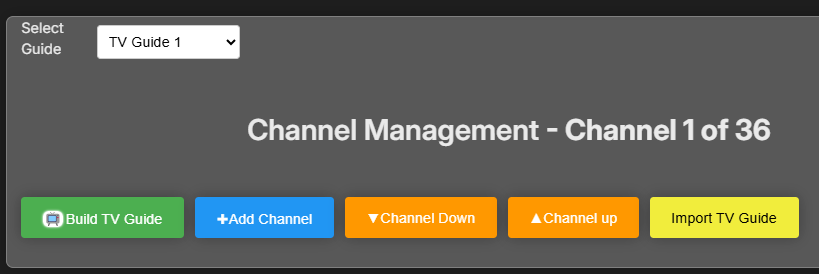

roormonger 6 Posted April 21, 2025 Posted April 21, 2025 (edited) 7 hours ago, VicMoore said: @roormongerThanks so much for pointing this problem out. The key info was seeing that you were using the search filter. The problem was a typo. The new code is below. Vic myTV.dll 579.5 kB · 1 download It's working again. Thank you so much. Also, How do I export my channels again? I only see an option to import. Does the exported data contain the whole generated EPG or does it just backup the rules used to make each channel? Edited April 21, 2025 by roormonger
VicMoore 755 Posted April 21, 2025 Author Posted April 21, 2025 (edited) @roormonger You export an EPG after you create it. Click the green button to create the EPG (build the TV Guide). Once the EPG is built you click the yellow button below to export it. Both the rules for building the EPG and the EPG data are exported. Vic Edited April 21, 2025 by VicMoore
roormonger 6 Posted April 22, 2025 Posted April 22, 2025 (edited) 2 hours ago, VicMoore said: @roormonger You export an EPG after you create it. Click the green button to create the EPG (build the TV Guide). Once the EPG is built you click the yellow button below to export it. Both the rules for building the EPG and the EPG data are exported. Vic Oh, I thought there was an option to export externally for backup reasons. Right after posting, I double checked. I'm dumb lol. Where does it export to? Edited April 22, 2025 by roormonger
