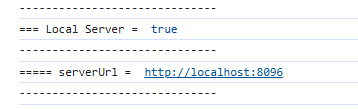

VicMoore 755 Posted March 10, 2025 Author Posted March 10, 2025 (edited) @Jator When you bring up "myTV" (the dll attached below) you should see in the browsers console the text below. If the "Local Server" is "true" then the logo menu will display and work properly, otherwise ("Local Server" is "false") the logo menu will not display. Because of the browsers security model (CORS), you can only add or change Channel Logos while using SSL or when the Emby server is local to the browser. This is why the "Get Image" button did not work for you. I decided not to mitigate this restriction, because Emby offers an easy way to add or change channel logo images. This restriction does not apply to Emby because Emby changes these images via server code, rather than browser code. Vic Edited March 16, 2025 by VicMoore

Jator 13 Posted March 11, 2025 Posted March 11, 2025 Here's the version I just tested: Here's the console log when I ty and add a logo: configurationpage?name=mytvappsjs&v=4.8.8.0:1027 === Fetch error = TypeError: window.showOpenFilePicker is not a function at openImageFile (configurationpage?name=mytvappsjs&v=4.8.8.0:1016:50) at Object.processTvChannelData (configurationpage?name=mytvappsjs&v=4.8.8.0:970:17) at eventCallback (configurationpage?name=mytvconfigjs&v=4.8.8.0:525:30) at Object.itemEventCatcher (configurationpage?name=mytvappsjs&v=4.8.8.0:925:52) at HTMLDivElement.catchClickEvent (configurationpage?name=mytvconfigjs&v=4.8.8.0:227:18) I'm trying to manage from my laptop on the same network (NAS is 192.168.0.2 and laptop is 192.168.0.250. Jay
VicMoore 755 Posted March 11, 2025 Author Posted March 11, 2025 @JatorThe problem is that your Emby server is not local to your browser. You can mitigate this problem by getting an SSL certificate for your server or by using a browser from the same server that's hosting Emby. I can fix this problem by adding code to the server (via the plugin) but chose not to because Emby already offers a server-based option for adding channel logos. I didn't want to replicate their work. Like you I also use Synology. But instead of hosting Emby within the Synology NAS, I chose to run Emby on a small server that attaches to the Synology Nas. My browser runs from that server. The CORS security model is very strict. This is a good thing. I hope this helps. Vic

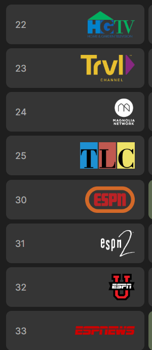

Jator 13 Posted March 13, 2025 Posted March 13, 2025 On 3/11/2025 at 10:38 PM, VicMoore said: Hello @JatorI think with virtualTV you enter in the path of the logo image. He then loads the image from the server. I did this once with a plugin called channels. I didn't want to do this because Emby lets you add logo images so easily. Give this built in Emby feature a try. I hope you visit often @Jatorand if you come to gainesville lets have a face to face meeting. Vic @VicMoore, I totally missed that I could manage the logo from the standard channel setup page. I've been updating several channel logos (I like the retro look, see examples below) and didn't even think to use that feature to include a logo for the myTV channels created. Full disclosure, Channels DVR doesn't have an easy way to change logos except within the "myTV equivalent" (channel collection in their app), so I was tuned in to "duplicating" how it works over there. That completely solves my issue and so I'm back.
