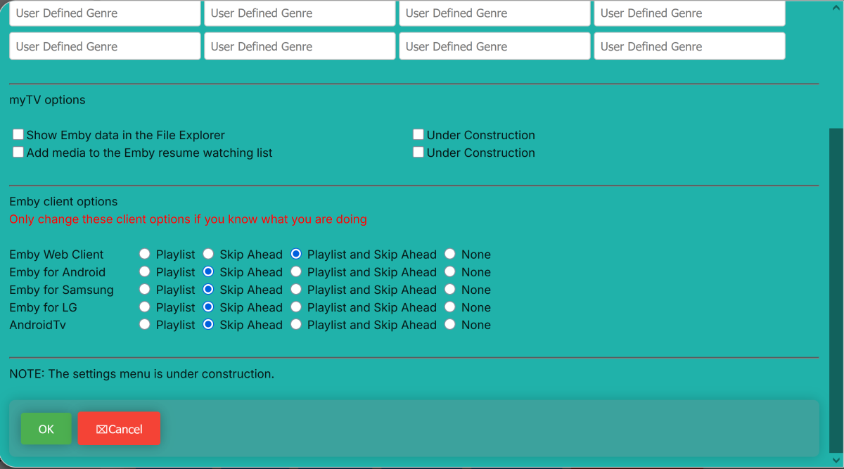

VicMoore 755 Posted September 29, 2025 Author Posted September 29, 2025 (edited) @sake8881What's happening is that a "Skip-Ahead" (also called SEEK) is not being sent. Go to the Settings Menu and for your client type click the "Skip-Ahead" radio button. This should fix the problem. Vic P.S. If you don't know your Emby client type, Play any media, then go to the Emby Dashboard. You will see the playing media added to the dashboard. It includes the client type that's playing the media. Edited September 29, 2025 by VicMoore

VicMoore 755 Posted October 18, 2025 Author Posted October 18, 2025 (edited) @Fulltiltgo into the settings and click the radio button for your client type to set "Playlist and Skip Ahead". If you don't know which client you have then set them all to "Playlist and Skip Ahead". Vic Edited October 18, 2025 by VicMoore

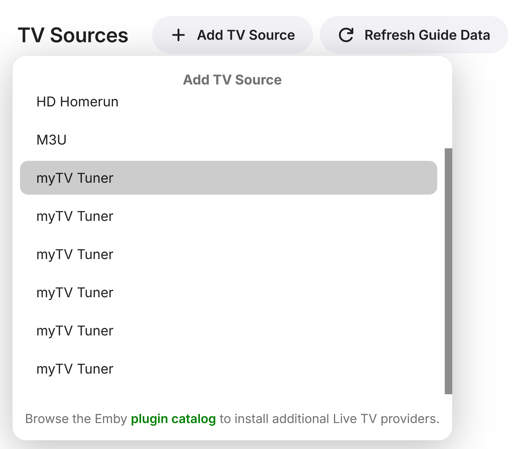

Fulltilt 4 Posted October 18, 2025 Posted October 18, 2025 (edited) HI, Thanks very much for the quick reply. I am using the web client. I also did a server restart, sorry to say ..still starting at the beginning of any media I play. Strange because it worked fine the first version I tried. I am sure I didn't change anything. Hope to figure this out. Also .. when you update from one myTV version to another and add a new TV source ..it looks like this. Maybe I missed it somewhere but is there a way to remove the old myTV sources from the list ..? Thanks again Vic for all the time on this plugin, I am enjoying it very much and appreciate all the effort. Edited October 18, 2025 by Fulltilt
VicMoore 755 Posted October 18, 2025 Author Posted October 18, 2025 @Fulltiltdo you have multiple copies of the myTV.dll in the plugin directory? When you copy a new dll to the plugin directory you should overwrite the old copy. Go to the plugin directory and delete all but the latest dll. Let me know if this solves your problem. Having multiple copies of the dll can mess thing up. Vic
Fulltilt 4 Posted October 19, 2025 Posted October 19, 2025 (edited) Yes Vic, that did solve the problem. I was just renaming the old versions. Now I also see the new IPTV button. I made sure now i have the latest download. I restarted the server and also removed and re-added myTV and setup the starter channels. Everything is working as it is supposed to. I am sorry about that. I will spend some time with this later after work, thanks again. Edited October 19, 2025 by Fulltilt
