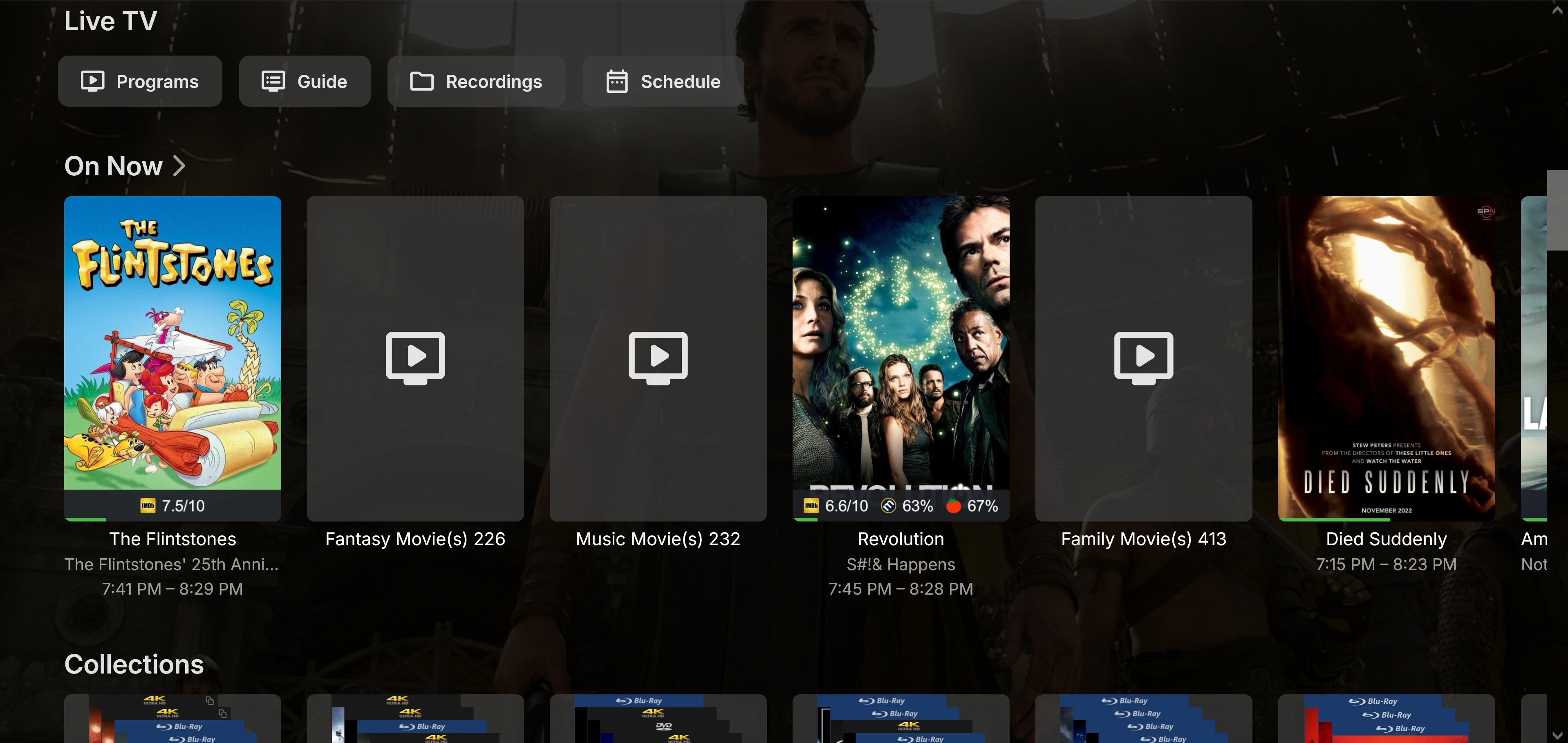

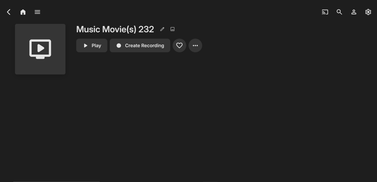

Fulltilt 4 Posted September 25, 2025 Posted September 25, 2025 Hi Vic, This is the only thing I have seen since the update which I am not sure about, I guess it could have happened before the update I just didn't test long enough. I am using the quick channel setup. I have kept everything the same .. nothing is customized. Seems all the media rotates correctly ..starts and resumes perfect. This is something I have seen a few times and not sure if its on my end or if anyone else has seen this too? 1
Fulltilt 4 Posted September 25, 2025 Posted September 25, 2025 So removing the myTV tuner and re-adding it ..then adding the starter channels again fixed the above. 1
