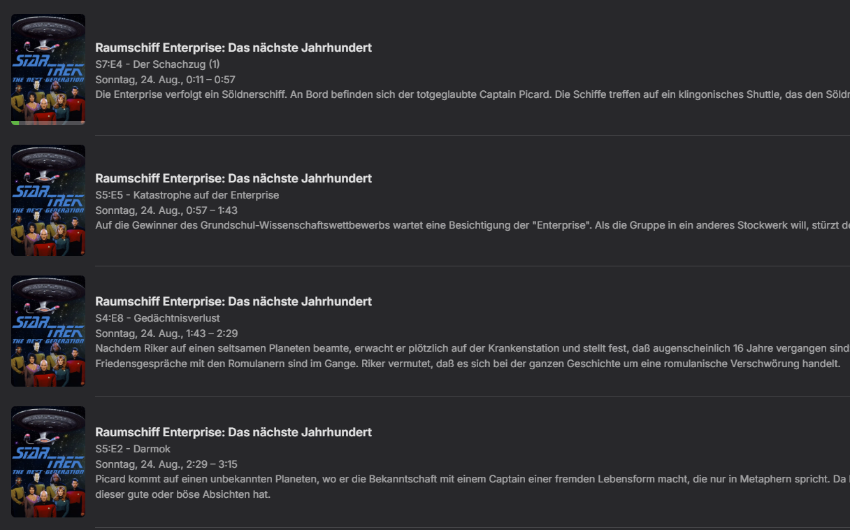

hdsuisse 14 Posted August 23, 2025 Posted August 23, 2025 ok, i put now the Radio and TV in TV Guide 1, and that works for me. the Random is playing from one Serie only, i think in the older version, it was playing a mix of all Series.
VicMoore 755 Posted August 24, 2025 Author Posted August 24, 2025 @hdsuisseI will check the random for all media types. I also fixed the interleave problem. I will post the new code in the morning. Vic
VicMoore 755 Posted August 24, 2025 Author Posted August 24, 2025 (edited) new code vic Edited August 27, 2025 by VicMoore
hdsuisse 14 Posted August 24, 2025 Posted August 24, 2025 (edited) Thank you Vic. -TV Channels with Random works with all Media now. -Radio Channels ok now. Great work. Your Plugin is very easy to handel and works like charm. Edited August 24, 2025 by hdsuisse

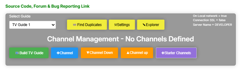

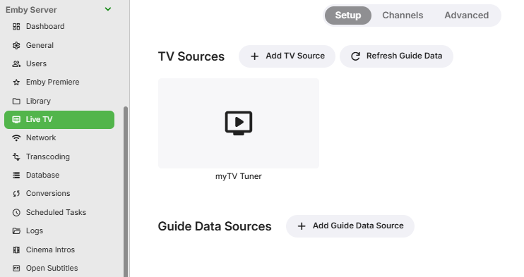

VicMoore 755 Posted September 7, 2025 Author Posted September 7, 2025 (edited) @Lyfesaver Good morning.... Yes it works for 4.9. The Emby strategy is that things that build the EPG are TV sources. Once you have loaded the plugin you must add it as a TV Source. To do so click "Live TV" in the Left Column and then click "Add TV Source." In this menu you click "MyTV Tuner." This is done just once. The next time that you click "Live TV" on the left panel the "MyTV" tuner will appear. Of course, this only happens if you defined an EPG. Click the "myTV Tuner" icon and the main screen for myTV appears. From here you can define your EPG. I suggest that you begin by clicking the "Starter Channels" followed by clicking "Build TV Guide" to build your first EPG. Let me know if you have any trouble. Vic Edited September 7, 2025 by VicMoore
