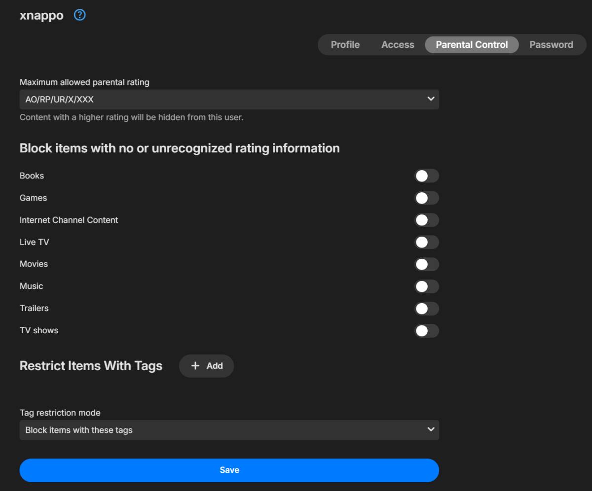

xnappo 1611 Posted January 13 Posted January 13 (edited) 15 minutes ago, Neminem said: Do you have any age restriction on the user you are using? I was going to get annoyed, because I already said I did not, but that was it - with a caveat! It was set like this: Note that unrecognized was set to NOT block. This item is setting a rating of '16' which I suppose wasn't recognized. I am guessing that in my previous cases, why it fixed it to turn off TVDB then back on is the rating was set to a recognized type by another service that did not get overriden when I turned it back on. Setting the rating to 'BLANK' fixed it. Please check the code on the 'unrecognized' option guys - but *THANK YOU* for the support in finding the problem. Edited January 13 by xnappo 1

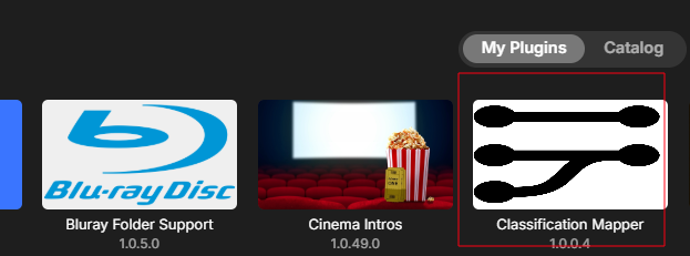

Neminem 1630 Posted January 13 Posted January 13 (edited) Have a look at this plugin That will help you with those classification that does not fit anywhere. Edited January 13 by Neminem

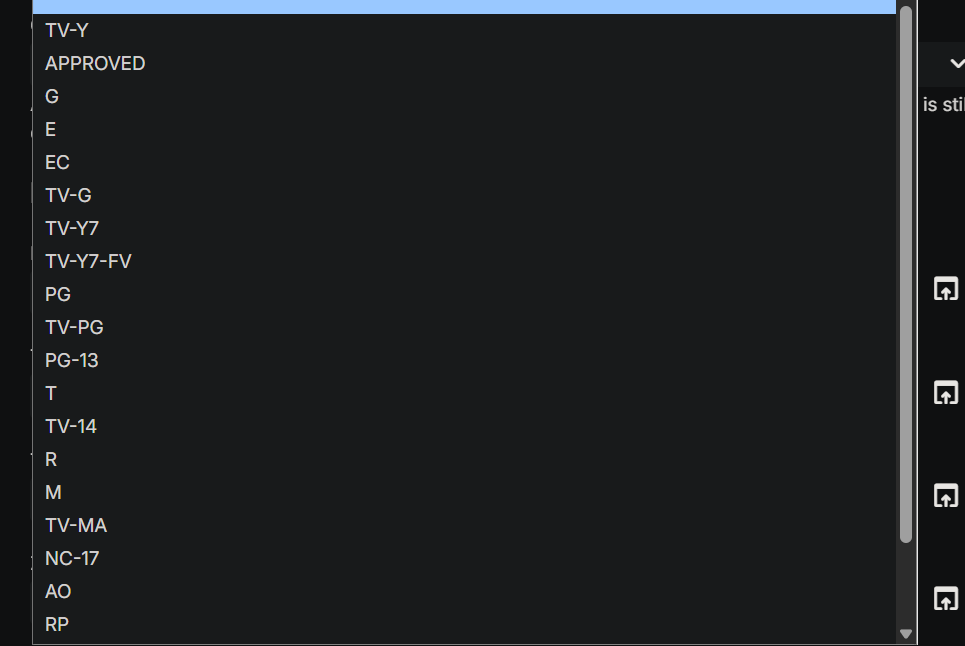

xnappo 1611 Posted January 14 Posted January 14 (edited) 17 hours ago, Luke said: What makes you so sure about it? Because it is the highest rating? Because the ratings are a fixed list and not an open input? Because '16' isn't listed as a known rating? Because no matter what you select in the ratings, '16' will never show, therefore it IS an unknown rating. Because Jellyfin had the same bug and fixed it? Known ratings exhibit A: Exhibit B: 16 is not in these lists, therefore it is an unknown rating. The code taking it as a known rating is a bug. Edited January 15 by xnappo
