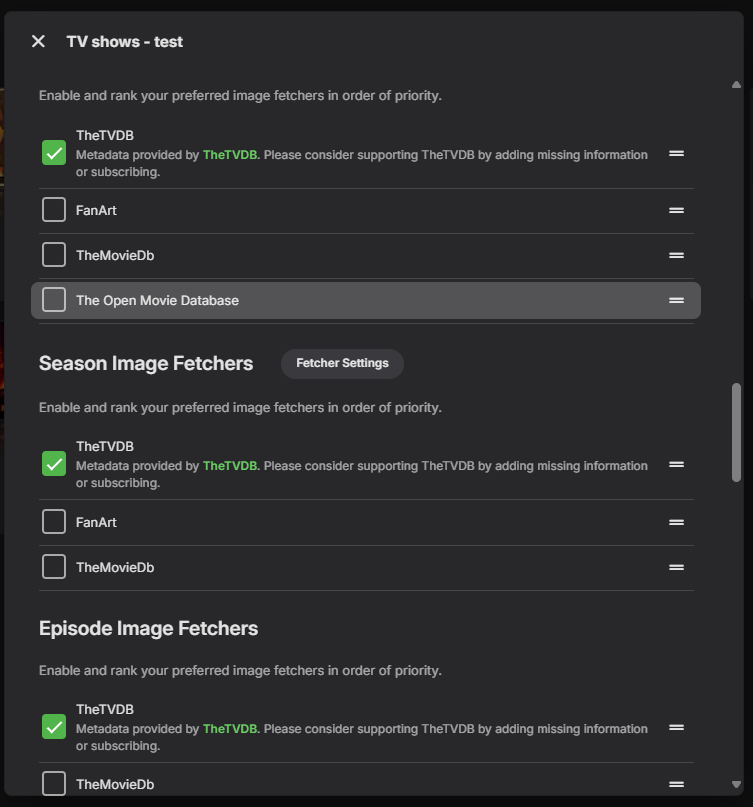

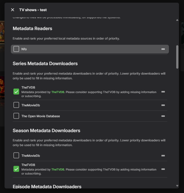

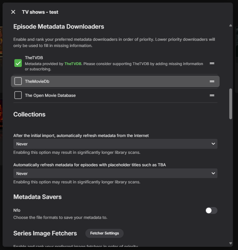

xnappo 1611 Posted June 6, 2025 Posted June 6, 2025 (edited) 5 minutes ago, GrimReaper said: Thanks, but I wanted tman247's result with no online meta-providers (at any level: series/season/episode) included, so we could write-off Emby server internal processing error. Next step would've been what you you've just observed yourself: to foucs on each provider (one by one) metadata/queries, eventually we would've likely come to that TVDB season-level observation, amongst others. The last log should have both before (no online providers) and after (turning back on thetvdb) in it. Anything else I can do to help? Edited June 6, 2025 by xnappo

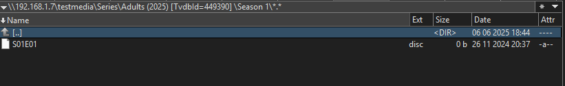

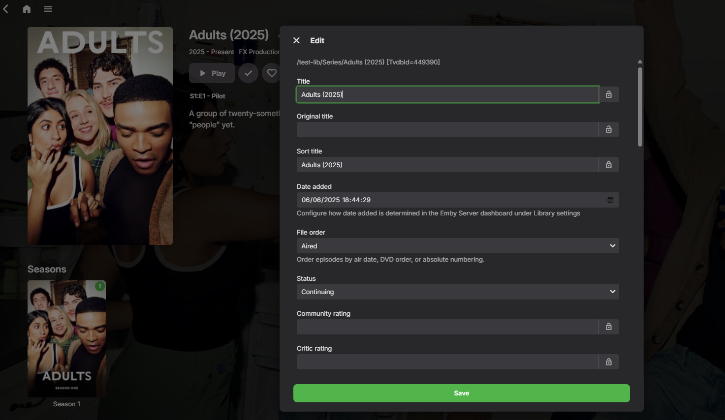

GrimReaper 4926 Posted June 6, 2025 Posted June 6, 2025 (edited) 6 minutes ago, xnappo said: The log should have both before (no online providers) and after (moviedb only) in it. Anything else I can do to help? As does Xnappo's example: 46 minutes ago, xnappo said: Okay, so I created a new library pointing to a folder with only 'Adults' in it with TVDB OFF and is scanned correctly and I could see it, but of course no meta data. Then I went and turned TVDB back on, did refresh metadata, and it disappeared Hence I've asked you to: 1 hour ago, GrimReaper said: 4. Scrape one item with TMM (both metadata and artwork) 5. Leave only that one item in your TV Shows root 6. Recreate the library with all Emby's internal meta-providers disabled, only NFO Reader enabled so it could be observed how is local metadata processed and would you be seeing that item compete with metadata afterwards or it would've also "disappear". Edit: Doh, thought I was replying to tman Sorry. Edited June 6, 2025 by GrimReaper
xnappo 1611 Posted June 6, 2025 Posted June 6, 2025 2 minutes ago, GrimReaper said: As does Xnappo's example: Hence I've asked you to: so it could be observed how is local metadata processed and would you be seeing that item compete with metadata afterwards or it would've also "disappear". Ok - I think I am missing this step? 4. Scrape one item with TMM (both metadata and artwork) Sorry - I don't know what TMM is.. This is something that makes local metadata?
tman247 0 Posted June 6, 2025 Author Posted June 6, 2025 Just jumping back in here (thanks for the comments @xnappo@Neminem) As hinted, I tried turning off TheTVDB as the metadata fetcher - infact, I turned it off for all settings for the 'TVShows' library. I did a rescan and still nothing. Only show that appears is one of my early ones and nothing new. I even tried renaming the show foldernames to; <showname> <(year)> [tvdbid=xxxxx] I did a full library rescan and it STILL only found the original show and not the new one. I'm stumped.
GrimReaper 4926 Posted June 6, 2025 Posted June 6, 2025 Just now, xnappo said: Sorry - I don't know what TMM is.. This is something that makes local metadata? Yes. And extremely powerful one.
tman247 0 Posted June 6, 2025 Author Posted June 6, 2025 Ok, some progress. I've created all the show metadata using TMM (which created the nfo file), then turned off all references for TVDB from the library. I left NFO as the only option for detecting shows. I did a library re-scan, and the show (finally) appeared. There's definately something amiss with TVDB support in TV Shows, but only for new shows added, but when this is from I don't know. I only had a few older shows in Emby until recently when I tried adding some new ones. I'll test a few more to see if this works. It's a bit painful, but if it works consistently, it will have to do.

GrimReaper 4926 Posted June 6, 2025 Posted June 6, 2025 (edited) 12 minutes ago, tman247 said: Ok, some progress. I've created all the show metadata using TMM (which created the nfo file), then turned off all references for TVDB from the library. I left NFO as the only option for detecting shows. I did a library re-scan, and the show (finally) appeared Yes, that was the intention: 40 minutes ago, GrimReaper said: Thanks, but I wanted tman247's result with no online meta-providers (at any level: series/season/episode) included, so we could write-off Emby server internal processing error. Next step would've been what you you've just observed yourself: to foucs on each provider (one by one) metadata/queries, eventually we would've likely come to that TVDB season-level observation, amongst others. 31 minutes ago, GrimReaper said: so it could be observed how is local metadata processed and would you be seeing that item compete with metadata afterwards or it would've also "disappear". So, if you want to dig deeper, you'd have to repeat the process (remove library-delete NFOs-recreate library) with each meta-provider separately and compare the behavior/narrow down the issues, see which provider with which settings work and which one does not - or if that satisfies you, use TMM for any shows that refuse to "appear". Edited June 6, 2025 by GrimReaper 1

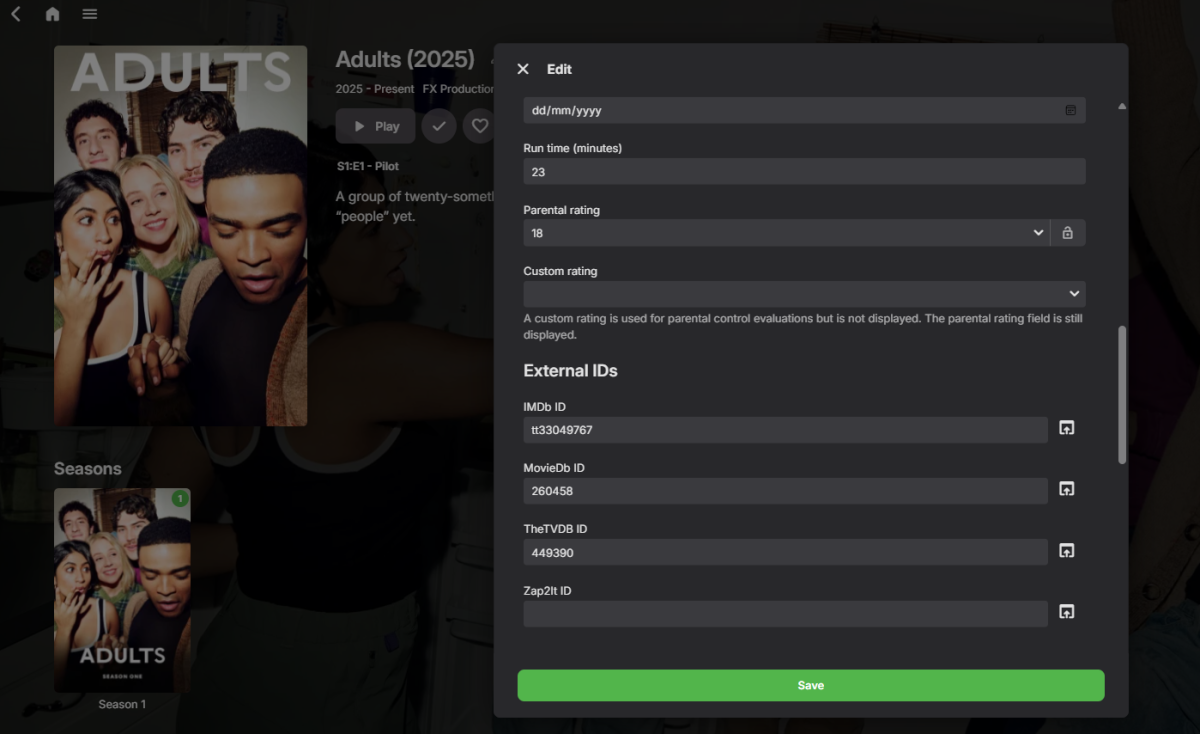

GrimReaper 4926 Posted June 6, 2025 Posted June 6, 2025 But that doesn't solve xnappo's issue. 2 hours ago, xnappo said: Interestingly, looking in the MediaItems table in the DB, it is there and everything looks good. See attached DB extract. Since you're querying DB, can you cross-check if any other item in your library shares same ProviderId, either TVDB or TMDB or IMDB?
xnappo 1611 Posted June 6, 2025 Posted June 6, 2025 12 minutes ago, GrimReaper said: But that doesn't solve xnappo's issue. Since you're querying DB, can you cross-check if any other item in your library shares same ProviderId, either TVDB or TMDB or IMDB? I did this: SELECT * FROM MediaItems WHERE ProviderIds LIKE '%449390%'; And it only found the one match So confused.
GrimReaper 4926 Posted June 6, 2025 Posted June 6, 2025 (edited) 10 minutes ago, xnappo said: So confused Ditto, as the only thing I could think of for the item not to be displayed/actually disappearing as per: 1 hour ago, xnappo said: I repeated the experiement, turning OFF thetvdb, but turning ON themoviedb and fanart. This worked correctly but with themoviedb's less-good metadata. Then turned thetvdb BACK on, and it disappeared. would be incorrectly linking to some other already existing item. Querying 2124941 also returns single hit? Edit: How about tt33049767? And 260458? 78680? Edited June 6, 2025 by GrimReaper
xnappo 1611 Posted June 6, 2025 Posted June 6, 2025 19 minutes ago, GrimReaper said: Ditto, as the only thing I could think of for the item not to be displayed/actually disappearing as per: would be incorrectly linking to some other already existing item. Querying 2124941 also returns single hit? Whelp, I am not going to be able to look into this anymore, because I can't recreate the problem now Something must have been screwy in the DB and then getting it to identify fixed it or something? 2

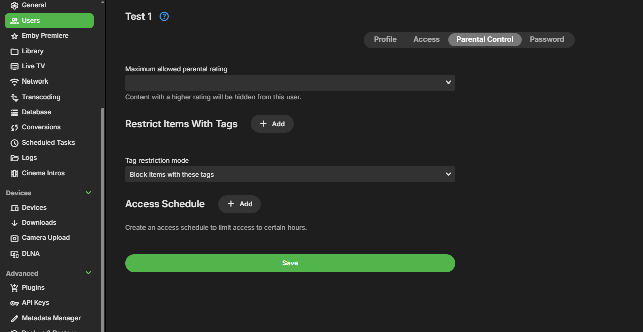

xnappo 1611 Posted January 13 Posted January 13 (edited) 15 minutes ago, Neminem said: Well it can be miss identified as something else. This is the path you use, S:\Video\TV Shows\The Asset Try with S:\Video\TV Shows\The Asset (2025) [TvdbId=459623] That should help Emby Identify the show. But it is already identifying it correctly - as can be seen from the DB. I tried it anyway, same result. It actually ONLY happens when it identifies correctly. If I change the folder name to 'Cheers' - it of course works. @Lukeit isn't even showing up in metadata manager->TV Shows->Folders. How can I tell in the DB if it is merged? Even if it did get merged, I would think it would show up in latest added or something as new episodes. Edited January 13 by xnappo
Neminem 1630 Posted January 13 Posted January 13 (edited) Do you have any age restriction on the user you are using? Edited January 13 by Neminem 1
