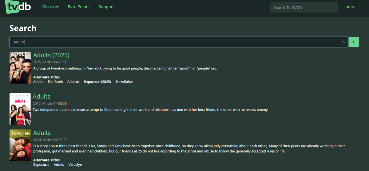

Neminem 1630 Posted June 6, 2025 Posted June 6, 2025 (edited) Do you have any of these shows also ? Search - TheTVDB.com Edited June 6, 2025 by Neminem

Neminem 1630 Posted June 6, 2025 Posted June 6, 2025 Try adding this to you folder naming "marked in red" Adults (2025) [TvdbId=449390] Assuming this is your tv show Adults (2025) - TheTVDB.com
xnappo 1611 Posted June 6, 2025 Posted June 6, 2025 (edited) 1 minute ago, Neminem said: Try adding this to you folder naming "marked in red" Adults (2025) [TvdbId=449390] Assuming this is your tv show Adults (2025) - TheTVDB.com Does not work. The problem isn't identification, you can see from the log it is identifying fine. It is even in the database just fine. Edited June 6, 2025 by xnappo
