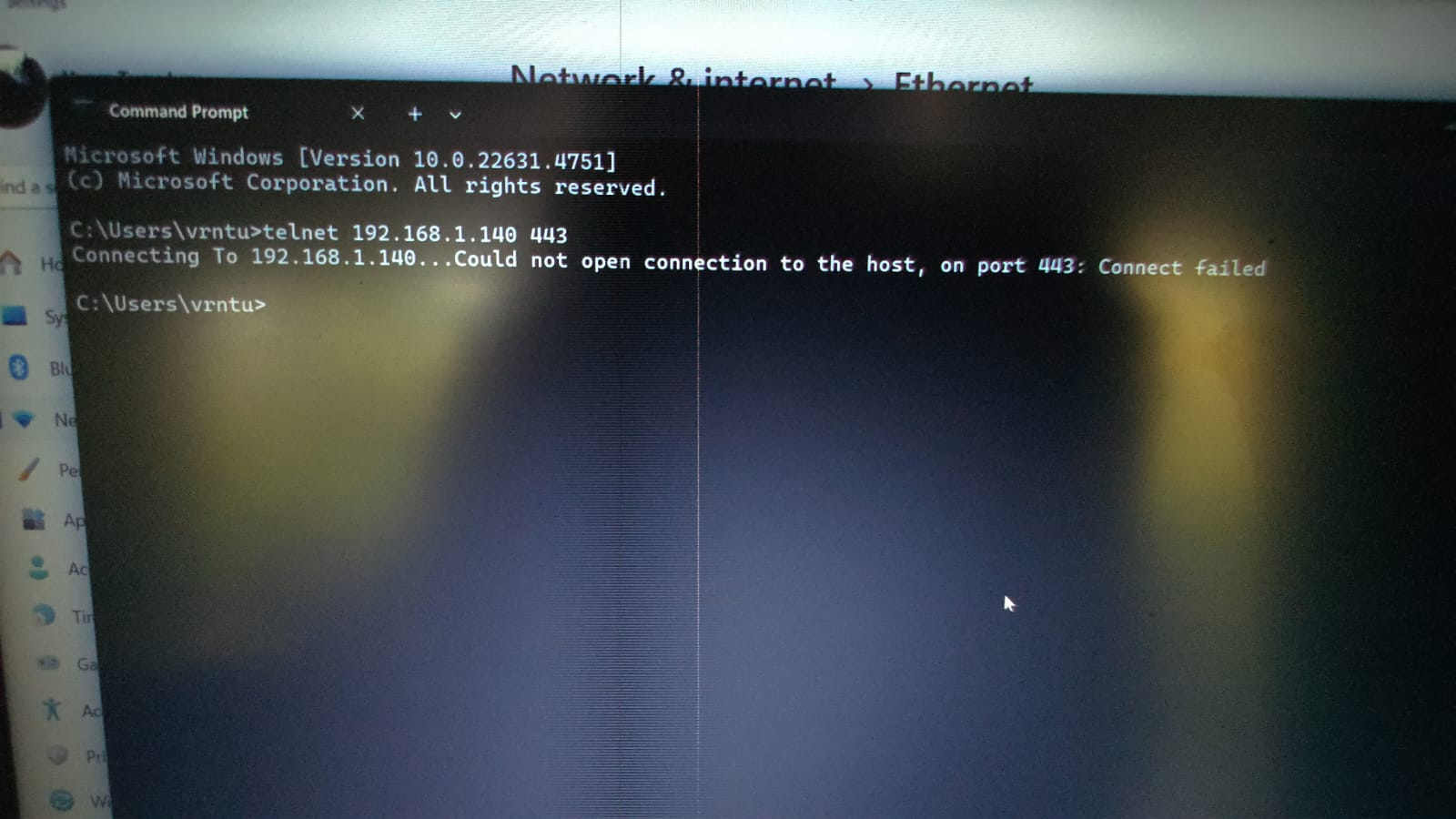

vrntu 3 Posted February 14, 2025 Posted February 14, 2025 Hello, Am back here - I had previously post another thread which was resolved here. I set up a domain, and it worked for about 2 weeks. However now it's shut off again from the remote access WAN. When I spoke to the person who did the network set up, he said that the IP isn't working on port 443 - and hence won't connect to 8096 and 8920.... Any support would be appreciated!
Luke 42289 Posted February 21, 2025 Posted February 21, 2025 Hi. This is a screenshot of a command prompt. What exactly is the issue that you’re having in Emby?

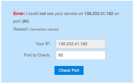

vrntu 3 Posted February 25, 2025 Author Posted February 25, 2025 So - I spoke to my ISP back-end support, they have guaranteed that they aren't blocking anything, especially since my connection is a business line. I have checked on canyouseeme.org and yougetsignal.com - interestingly enough, the 8096 and 8920 ports are open, but the 443 and 80 ports are not. Obviously, all of these ports are unblocked on my firewall, etc. So.... I'm afraid I'm at a bit of an impasse for the moment....

Q-Droid 1011 Posted February 26, 2025 Posted February 26, 2025 8 hours ago, vrntu said: So - I spoke to my ISP back-end support, they have guaranteed that they aren't blocking anything, especially since my connection is a business line. I have checked on canyouseeme.org and yougetsignal.com - interestingly enough, the 8096 and 8920 ports are open, but the 443 and 80 ports are not. Obviously, all of these ports are unblocked on my firewall, etc. So.... I'm afraid I'm at a bit of an impasse for the moment.... Do you have something actively listening on ports 80 and 443 or at the very least forwarded from WAN 80/443 to LAN something/something? In your case perhaps WAN:80 -> LAN:8096 and WAN:443 -> LAN:8920?

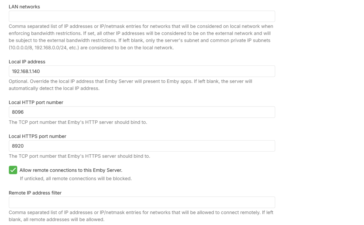

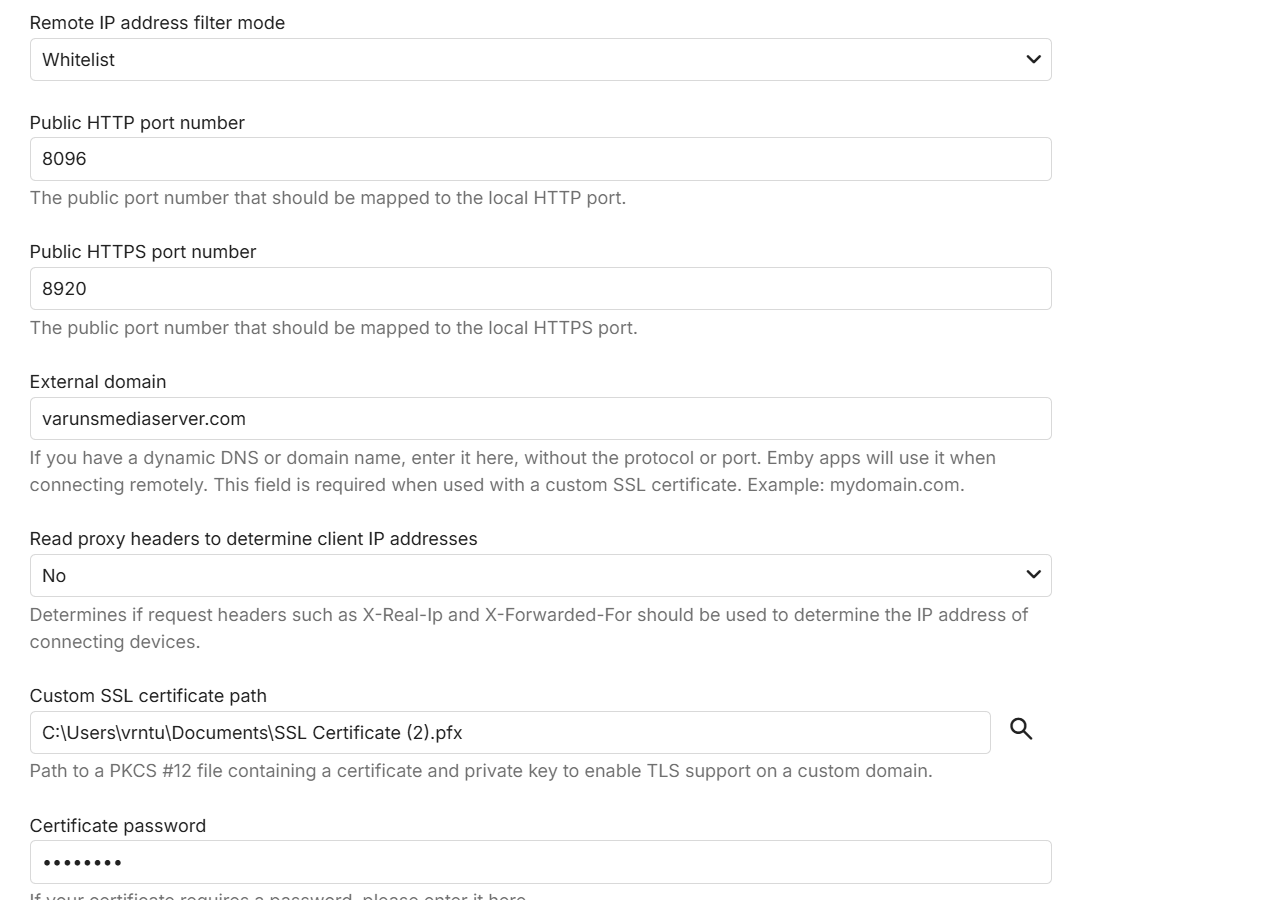

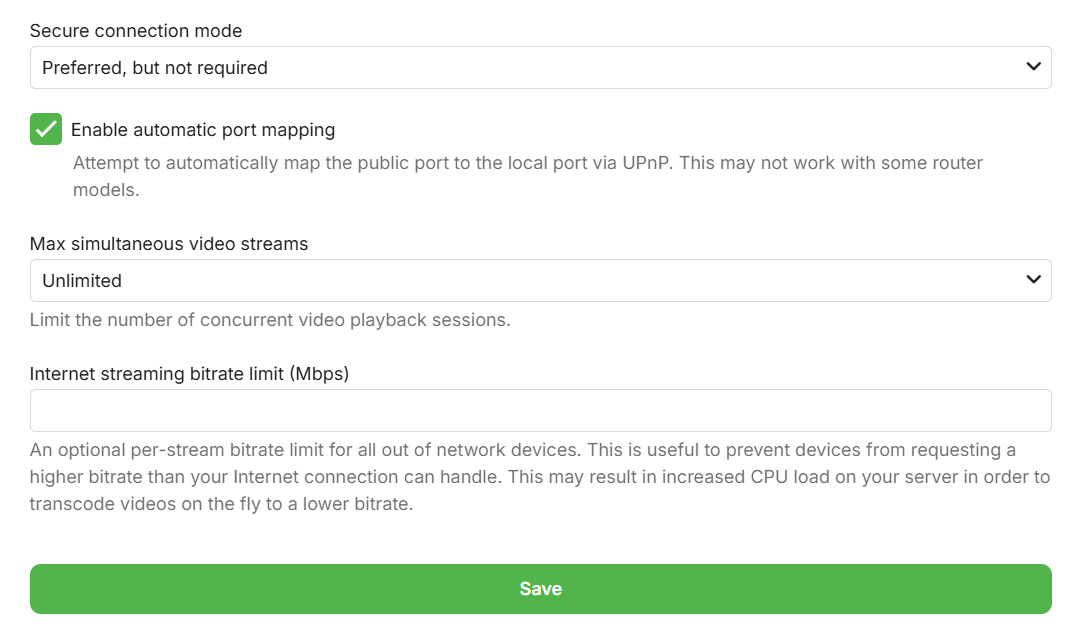

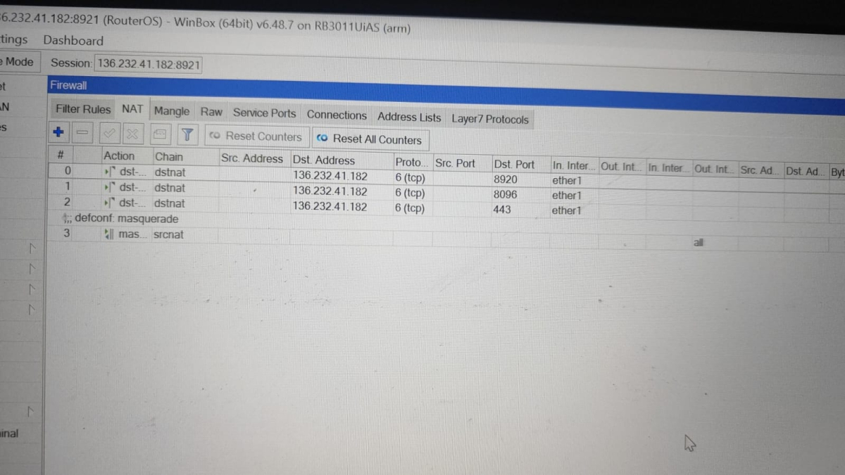

vrntu 3 Posted March 4, 2025 Author Posted March 4, 2025 Hello, apologies! I was travelling and away from my server device. I am attaching here the screenshot forwarding rules on my router, my server network set up, and the server log on startup. embyserver.txt
rbjtech 5345 Posted March 4, 2025 Posted March 4, 2025 (edited) I'm not familiar with the device you are using for the f/w and/or router - but you need to port forward from your public WAN address to the emby server (192.168.1.140) (and implied in that is to do a NAT (WAN > LAN) and also a PAT (443 > 8096 (http) or 8920 (https)) A DNS lookup of your fqdn (which you should probably remove..) comes back with two IP addresses - so that is not helping things as you will need to accomodate for both. Remove Automatic Port mapping from the Emby Config above. Unless you have other services on 443 - it may well be easier just to ask Emby to listen on 443 and then you don't have to PAT - ie change local HTTPS port to 443 and restart emby. -edit- Ah - the two WAN IP's on the fqdn are godaddy - both are listening on TCP 443 - as the fqdn is a parked domain and godaddy is replying. the 136.232.x.y is replying on 443, 8096 & 8920 So you need to sort out the DNS/Domain registration - so the fqdn replies with your WAN address (DDNS needed) and then it will likely work fine. Edited March 4, 2025 by rbjtech

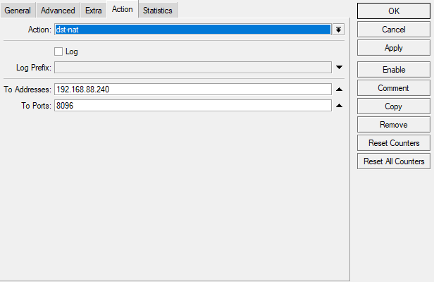

daldana 126 Posted March 4, 2025 Posted March 4, 2025 @vrntu, three things to check in RouterOS. 1. When you double click on one of those rules, do you see this on the "Action" tab? 2. RouterOS is picky about the order of rules, so you should move the masquerade rule to the top. 3. You probably don't need to have any entries in the "In Inter" column.
rbjtech 5345 Posted March 4, 2025 Posted March 4, 2025 (edited) 2 minutes ago, daldana said: @vrntu, three things to check in RouterOS. 1. When you double click on one of those rules, do you see this on the "Action" tab? 2. RouterOS is picky about the order of rules, so you should move the masquerade rule to the top. 3. You probably don't need to have any entries in the "In Inter" column. nat etc is working fine - all the ports listed are listening - thus nat/port forwarding is working. I think the issue is the DNS/TLS/Cert as that domain does not belong to the user ... but at the TCP layer - it's working just fine. Edited March 4, 2025 by rbjtech
