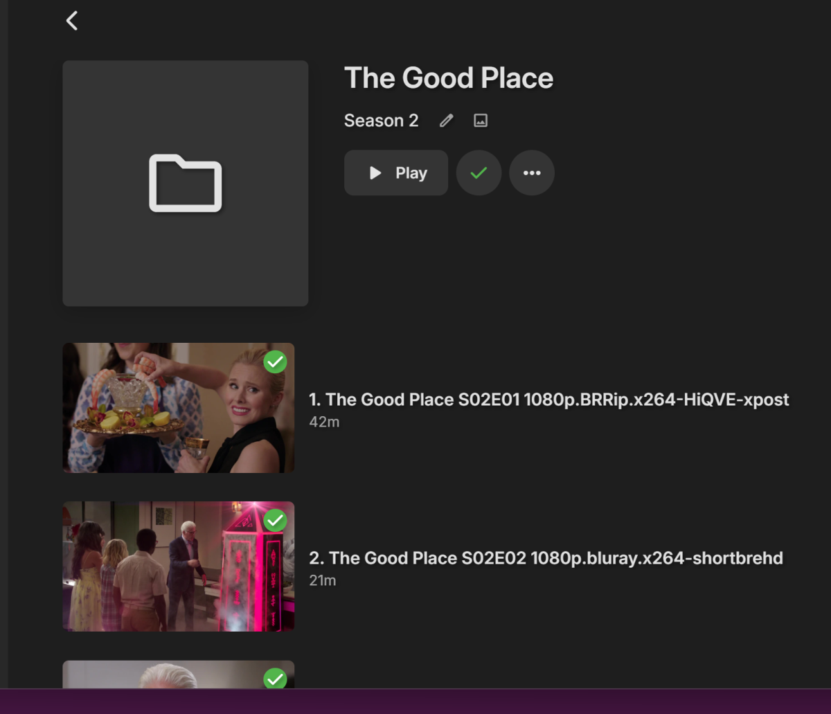

sangej01 0 Posted February 13, 2025 Posted February 13, 2025 I am seeing the filenames listed as episode names .... struggling to figure out why. My Emby is running in a docker container on a Synology NAS (perhaps this is germane). I made a small test library with this folder structure: Test Folder - TV / The Good Place (2016) / Season 1 Season 2 And have files that are within the Season 1 and Season 2 folders. These files are named along these lines: The.Good.Place.S01E01.1080p.BluRay.X264-SHORTBREHD.mkv The Good Place S01E01 1080p.BluRay.X264-SHORTBREHD.mkv I thought I was following the rules, but the names of the episodes come up as: (not to mention that the folder art is also missing for some reason). I also am not sure that performing a Library Scan on a single library (using the three dots... menu) actually works. Any help would be DEEPLY appreciated! I have been struggling with this for weeks. Hate to have to try and go back and make Plex work!
GrimReaper 4896 Posted February 13, 2025 Posted February 13, 2025 (edited) That show doesn't seem to be identified at all - maybe something is blocking your outgoing connections or you're geoblocked? If you three-dot>Identify on show level, are you getting any results? Post server log. How to Report a Problem Edit: What content-type is that library? What did you insert as library path(s)? Edited February 13, 2025 by GrimReaper Append

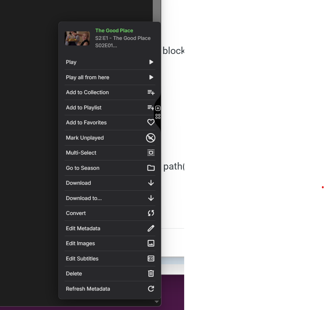

sangej01 0 Posted February 13, 2025 Author Posted February 13, 2025 Thanks so much for rapid reply. Here is a typical 'three dot' selection on one of the episodes; I don't see the 'Identify' option: I am not sure how to determine outgoing connections or geoblock .... I certainly have an outside user seeing much the same as I do. Content type is Tv Shows, as you can see. Uploaded Log. Again, thanks a lot! embyserver.txt
GrimReaper 4896 Posted February 13, 2025 Posted February 13, 2025 1 minute ago, sangej01 said: Here is a typical 'three dot' selection on one of the episodes; I don't see the 'Identify' option: 13 minutes ago, GrimReaper said: If you three-dot>Identify on show level, are you getting any results? You can't identify episodes (or seasons), just TV shows. Try it again on TV show level three-dot menu. 15 minutes ago, GrimReaper said: maybe something is blocking your outgoing connections or you're geoblocked? All of your outgoing connections are timing-out. Quote 2025-02-13 00:00:50.533 Error SecurityManager: Error checking registration status of MBSupporter *** Error Report *** Version: 4.8.10.0 Command line: /system/EmbyServer.dll -programdata /config -ffdetect /bin/ffdetect -ffmpeg /bin/ffmpeg -ffprobe /bin/ffprobe -restartexitcode 3 Operating system: Linux version 4.4.302+ (root@build6) (gcc version 12.2.0 (GCC) ) #72806 SMP Thu Sep 5 13:41:01 CST 2024 Framework: .NET 6.0.31 OS/Process: x64/x64 Runtime: system/System.Private.CoreLib.dll Processor count: 4 Data path: /config Application path: /system MediaBrowser.Model.Net.HttpException: MediaBrowser.Model.Net.HttpException: Connection to https://mb3admin.com/admin/service/registration/validate timed out ---> System.Threading.Tasks.TaskCanceledException: The request was canceled due to the configured HttpClient.Timeout of 20 seconds elapsing. 2025-02-13 00:09:36.972 Error Server: Error processing request *** Error Report *** Version: 4.8.10.0 Command line: /system/EmbyServer.dll -programdata /config -ffdetect /bin/ffdetect -ffmpeg /bin/ffmpeg -ffprobe /bin/ffprobe -restartexitcode 3 Operating system: Linux version 4.4.302+ (root@build6) (gcc version 12.2.0 (GCC) ) #72806 SMP Thu Sep 5 13:41:01 CST 2024 Framework: .NET 6.0.31 OS/Process: x64/x64 Runtime: system/System.Private.CoreLib.dll Processor count: 4 Data path: /config Application path: /system MediaBrowser.Model.Net.HttpException: MediaBrowser.Model.Net.HttpException: Connection to https://www.thetvdb.com/banners/episodes/77345/238311.jpg timed out ---> System.Threading.Tasks.TaskCanceledException: The request was canceled due to the configured HttpClient.Timeout of 20 seconds elapsing. 2025-02-13 00:17:01.187 Error App: Error in TheMovieDb *** Error Report *** Version: 4.8.10.0 Command line: /system/EmbyServer.dll -programdata /config -ffdetect /bin/ffdetect -ffmpeg /bin/ffmpeg -ffprobe /bin/ffprobe -restartexitcode 3 Operating system: Linux version 4.4.302+ (root@build6) (gcc version 12.2.0 (GCC) ) #72806 SMP Thu Sep 5 13:41:01 CST 2024 Framework: .NET 6.0.31 OS/Process: x64/x64 Runtime: system/System.Private.CoreLib.dll Processor count: 4 Data path: /config Application path: /system MediaBrowser.Model.Net.HttpException: MediaBrowser.Model.Net.HttpException: Connection to https://api.themoviedb.org/3/configuration?api_key=f6bd687ffa63cd282b6ff2c6877f2669 timed out ---> System.Threading.Tasks.TaskCanceledException: The request was canceled due to the configured HttpClient.Timeout of 20 seconds elapsing.

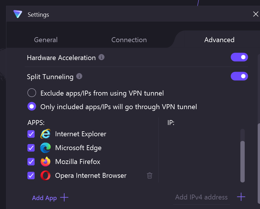

sangej01 0 Posted February 13, 2025 Author Posted February 13, 2025 I am running Proton VPN, but I _think_ that these are the only apps actually using it:
sangej01 0 Posted February 13, 2025 Author Posted February 13, 2025 Sorry, thought 'show' meant 'episode'. You are correct, NOTHING in the Identify section. My Emby instance on the NAS ... should connect out through my router without touching any of my browsers which are in the VPN inclusion list, right? Nothing to do with the Emby instance on the server?
GrimReaper 4896 Posted February 13, 2025 Posted February 13, 2025 (edited) 12 minutes ago, sangej01 said: My Emby instance on the NAS ... should connect out through my router without touching any of my browsers which are in the VPN inclusion list, right? Nothing to do with the Emby instance on the server? In theory - yes, though it is impossible to know how all the routers and all the VPNs in the world would/will behave. For starters, I'd check connections with VPN excluded/out of the equation. There might be something else in your particular system that's blocking those outgoing requests, but you have to start troubleshooting somewhere - VPN seems like an obvious choice. Edited February 13, 2025 by GrimReaper

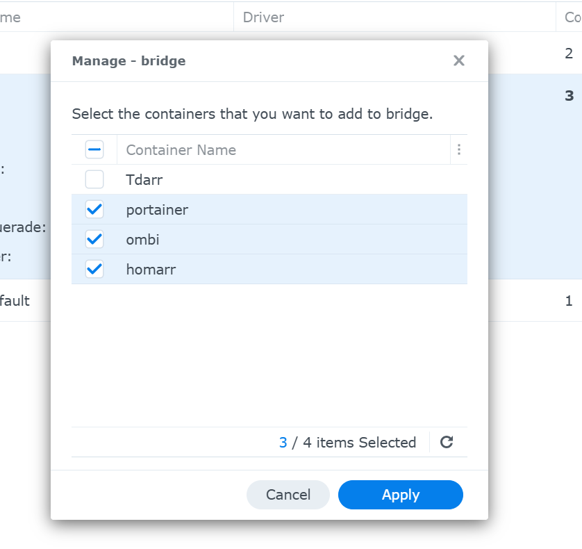

GrimReaper 4896 Posted February 13, 2025 Posted February 13, 2025 (edited) 3 minutes ago, sangej01 said: OK: let's stick with identify, now that I know where it is and it seems like a fundamental function that needs to work! No joy; nothing filling in despite me turning off VPN. That would indicate your requests are still timing out. You can check (or post) your server log. Edit: Is your docker instance in host or bridge mode? Edited February 13, 2025 by GrimReaper Append

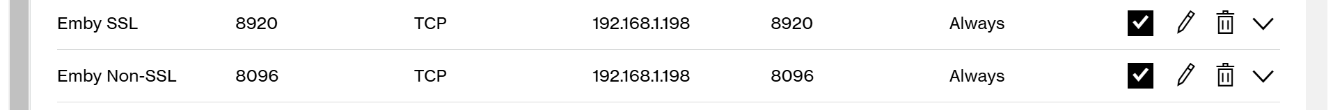

sangej01 0 Posted February 13, 2025 Author Posted February 13, 2025 LOL. I'm flattered that you think I can answer your Docker question. The only Emby related stuff i entered into my router was port forwarding: You know, I would probably feel better if I started fresh on a dedicated mini-pc ... run Emby on it, rather than in a mysterious Docker container on my NAS. Is that feasible? To actually completely start from scratch, using a mapped network drive on the mini-PC to access the media files? embyserver.txt
sangej01 0 Posted February 13, 2025 Author Posted February 13, 2025 It would appear that the Emby docker is NOT in bridge mode:
