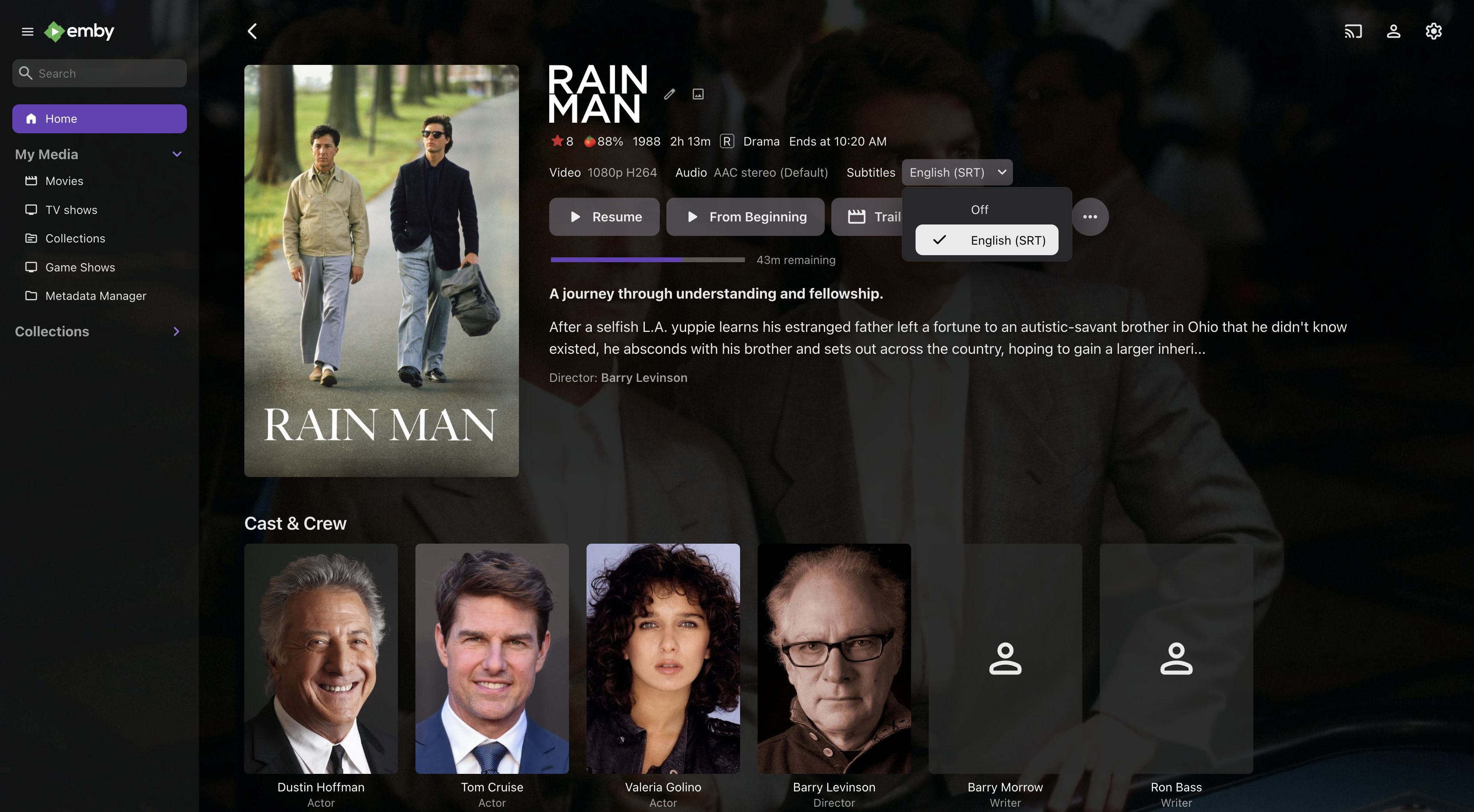

trevoragifford 1 Posted February 13, 2025 Posted February 13, 2025 Recently I've been experiencing a strange issue with media playback through the Roku app. I've found the easiest way to reproduce the issue is if I start playback and then try to choose subtitles. After I make my subtitle selection the playback starts to buffer, then it gets stuck on 13% for a bit before displaying 'Playback Error - The connection timed out.'. Then shortly afterwards it boots me of the media details back to the list page and displays 'ContentNotAvailable'. Then if I attempt to start playback for that movie again, I'll get the same buffering and error behavior indefinitely. Other movies will play fine, however (unless I try to select subtitles for them too...). Only seems to be for external subtitles. MKV files with embedded subtitles seem to work fine.The only way I've found to get playback for the affected movie to work again is to reboot the server. I've tested on the web app and iOS app and I don't experience this behavior in either -- it seems to only be on Roku. I've tested on two different Roku devices and experienced the same behavior in each. I've attached my server log files. I sent the Roku logs ~10:47 PM tonight, 2/17/2025. The movie that was attempted to play was 'Rain Man' by user Trevor. embyserver-63874987488.txt ffmpeg-transcode-bc8d048d-ece8-4086-8202-6f933fbf04e6_1.txt ffmpeg-transcode-20b68a3a-e61f-4859-b94a-4634e4193f52_1.txt embyserver.txt hardware_detection-63874987490.txt

trevoragifford 1 Posted February 13, 2025 Author Posted February 13, 2025 Odd ... that was the Rain Man example? Its definitely supposed to be SRT. That one was in 480p in .MKV format with embedded DVD_SUB subtitles until recently when i removed it and replaced it with a 1080p version and SRT subs. Could that be related?
ebr 16332 Posted February 13, 2025 Posted February 13, 2025 11 minutes ago, trevoragifford said: until recently when i removed it and replaced it with a 1080p version Try doing a full refresh metadata on that item.

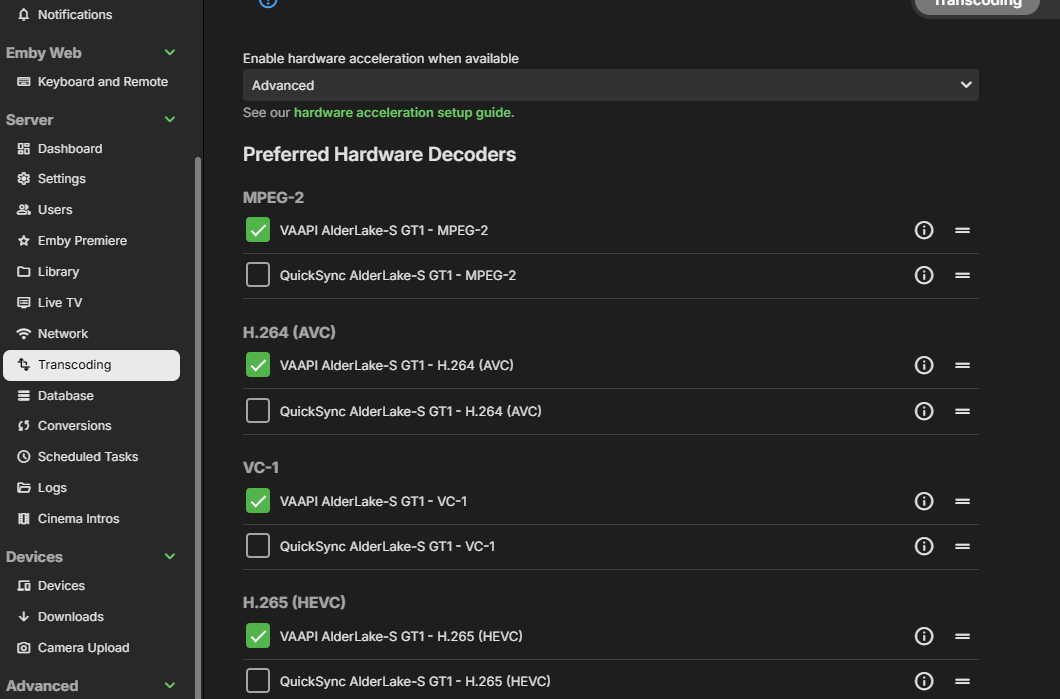

Neminem 1621 Posted February 13, 2025 Posted February 13, 2025 @trevoragiffordcan you do a full metadata refresh of the movie. Also switch to vaapi instead of qsv. Your hardware is old and cant hack it. 1
trevoragifford 1 Posted February 13, 2025 Author Posted February 13, 2025 11 minutes ago, Neminem said: can you do a full metadata refresh of the movie. Unfortunately this doesnt help 11 minutes ago, Neminem said: Also switch to vaapi instead of qsv. Your hardware is old and cant hack it. I can't find a setting for this, how do i make this change?
Neminem 1621 Posted February 13, 2025 Posted February 13, 2025 Your logs suggests you are using linux
Neminem 1621 Posted February 13, 2025 Posted February 13, 2025 What OS are you running on ? Linux version 4.19.0-18-amd64
trevoragifford 1 Posted February 13, 2025 Author Posted February 13, 2025 15 minutes ago, Neminem said: What OS are you running on ? Operating System: Debian GNU/Linux 10 (buster) Kernel: Linux 4.19.0-18-amd64 QuickSync isn't an option for me anyway

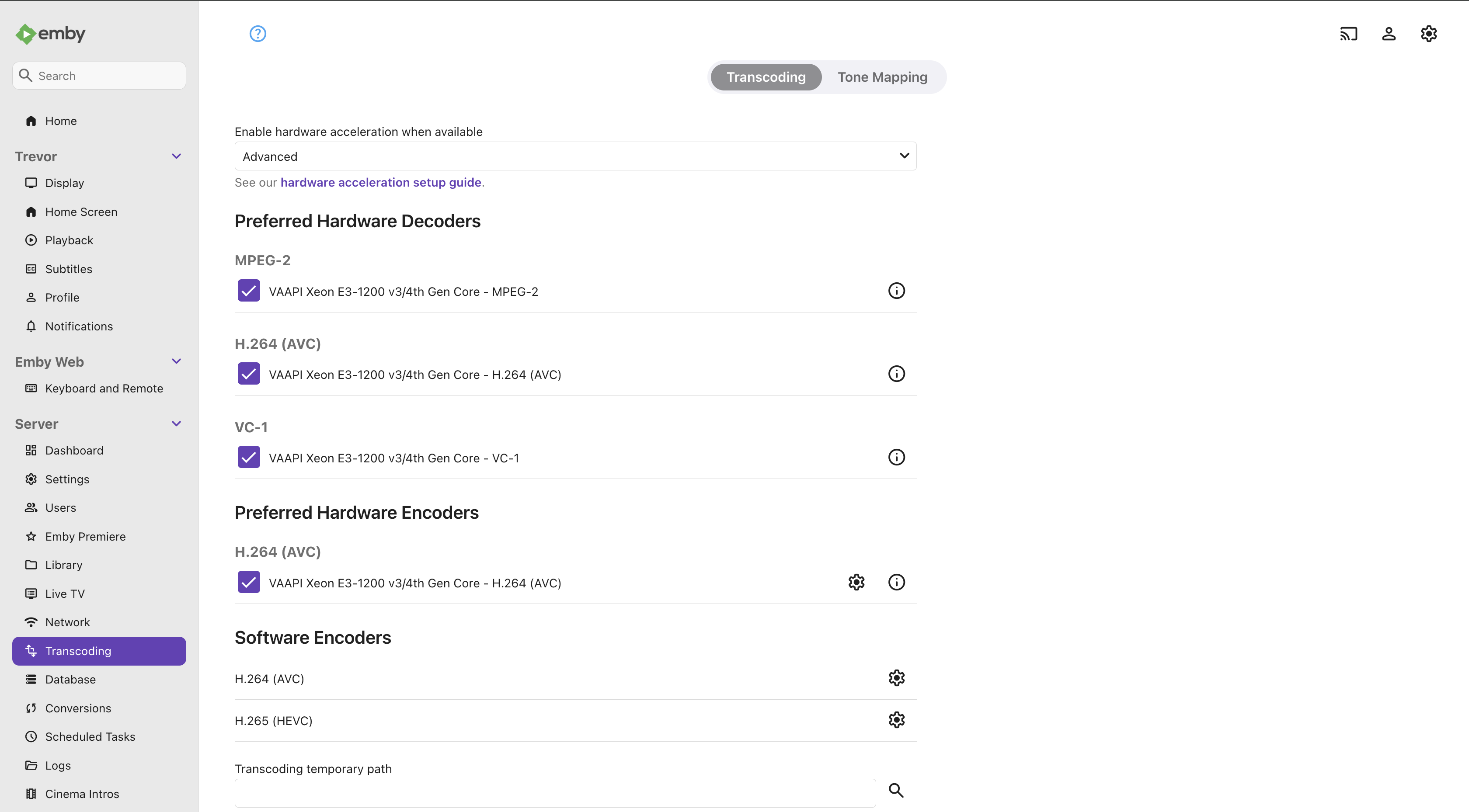

Neminem 1621 Posted February 14, 2025 Posted February 14, 2025 9 hours ago, Neminem said: Your hardware is old and cant hack it. Can you try without hardware transcoding.
trevoragifford 1 Posted February 16, 2025 Author Posted February 16, 2025 On 2/13/2025 at 10:04 PM, Neminem said: Can you try without hardware transcoding. Same result with hardware transcoding disabled.
