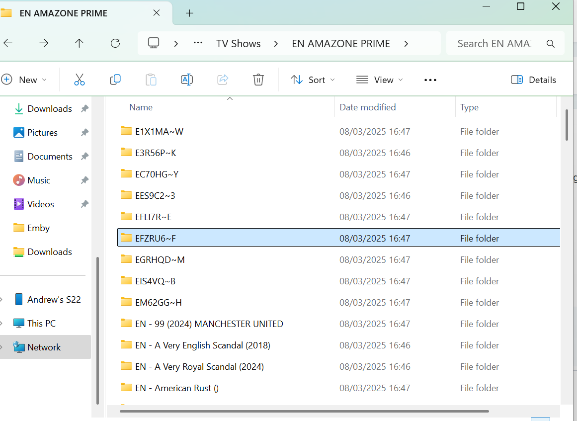

gillmacca01 220 Posted March 8, 2025 Posted March 8, 2025 I've have just deleted the m3u files and vods created by the plugin. Ran the plugin from the scheduled task, still took 5 minutes to start creating files, but completed in 8 mins 22 secs - I am more than happy with that duration I do have another issue though (i'm sure your not suprised). not all the vod's are titled correctly

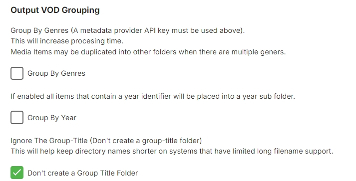

sftech13 25 Posted March 8, 2025 Posted March 8, 2025 (edited) 44 minutes ago, gillmacca01 said: I've have just deleted the m3u files and vods created by the plugin. Ran the plugin from the scheduled task, still took 5 minutes to start creating files, but completed in 8 mins 22 secs - I am more than happy with that duration I do have another issue though (i'm sure your not suprised). not all the vod's are titled correctly @mickle026have you considered writing just the folder of the show/movie instead of the group then show? Or is it as designed? I was on the fence of this also and decided to go without writing the group to the folder structure. Curious if you thought about it and why you decided this route. I decided to go the show/movie route with a parent directory to act like a library folder. Just curious I'm going to load this up this week and try it out. Edited March 8, 2025 by sftech13
mickle026 653 Posted March 8, 2025 Author Posted March 8, 2025 (edited) 1 hour ago, gillmacca01 said: I've have just deleted the m3u files and vods created by the plugin. Ran the plugin from the scheduled task, still took 5 minutes to start creating files, but completed in 8 mins 22 secs - I am more than happy with that duration I do have another issue though (i'm sure your not suprised). not all the vod's are titled correctly Is this on the qnap? This looks like a long filename substitution, like win95 used to do. Another hurdle LOL As @sftech13mentioned I may have to include an option to leave out the group name and thus make the directory name shorter. The limit on the qnap must be shorter than my Netgear nas. Adding this as an option is not a problem. Found this https://forum.qnap.com/viewtopic.php?t=141919 Which sheds a bit of light on windows > qnap network behaviour, can you enter your qnap webui and check if the filenames are correct there? See if it's windows or the qnap that's doing this. Edited March 8, 2025 by mickle026
gillmacca01 220 Posted March 8, 2025 Posted March 8, 2025 5 minutes ago, mickle026 said: Is this on the qnap? This looks like a long filename substitution, like win95 used to do. Another hurdle LOL As @sftech13mentioned I may have to include an option to leave out the group name and thus make the directory name shorter. The limit on the qnap must be shorter than my Netgear nas. Adding this as an option is not a problem. Yes, it's on my QNAP
mickle026 653 Posted March 8, 2025 Author Posted March 8, 2025 Edited the post above, read the qnap forum page in the link and check yours, see if it's windows networking or the qnap.
gillmacca01 220 Posted March 8, 2025 Posted March 8, 2025 Using qfile (QNAP File Explorer app) and in the QNAP's filestation, the files are titled correctly
mickle026 653 Posted March 8, 2025 Author Posted March 8, 2025 1 hour ago, gillmacca01 said: Using qfile (QNAP File Explorer app) and in the QNAP's filestation, the files are titled correctly So this is neither the plugin or the qnap, it's how windows views long filenames on network drives. That's a registry setting needs toggling, I can't remember offhand which but you can Google it. I can add an option though as I said before to make the directory path shorter.
gillmacca01 220 Posted March 8, 2025 Posted March 8, 2025 (edited) No point adding an option just for me, unless you think it could happen to others. The main thing is that it displays correctly in Emby Edited March 8, 2025 by gillmacca01

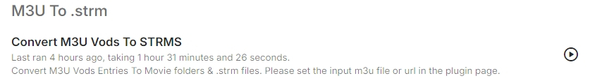

mickle026 653 Posted March 9, 2025 Author Posted March 9, 2025 Difference now with full verbose logging 1 hr 31 minutes 26 seconds This is where I am seeing a massive gain in performance! 33 minutes ago, fbrassin said: I run the plugin yesterday night with api enable: TMDB one. Finished this import. 08.mar.2025 - 22:53:13 Task Ended at: 08/03/2025 22:53:13 08.mar.2025 - 22:53:13 Task Duration: 06:00:27.33 But i don't see any refereces [imdb-tt0120855] at the end of the file name. It is enough to put api key or something else has to be set? I don't see any check box. I haven't tested this yet , maybe there is something wrong with my logic and its not fetching them properly. Yes I should add a checkbox to enable and disable, rather than using if the key exists to enable it I have done the programming logic, but not checked it yet. I will try to check it today, update it if necessary, check it again... 1
gillmacca01 220 Posted March 9, 2025 Posted March 9, 2025 The option to not create a group-title works, I just haven't decided if I'm going to use it yet. Depends on how I'm going to add the VODs to Emby

mickle026 653 Posted March 9, 2025 Author Posted March 9, 2025 5 hours ago, gillmacca01 said: The option to not create a group-title works, I just haven't decided if I'm going to use it yet. Depends on how I'm going to add the VODs to Emby This is why I like options, it's your choice
