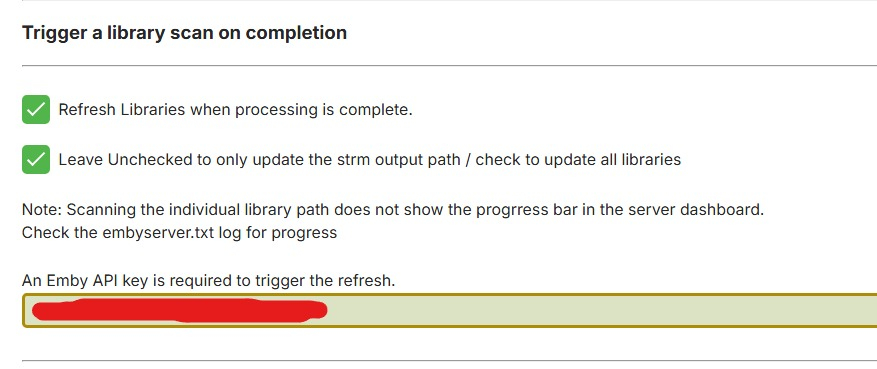

fbrassin 47 Posted May 9, 2025 Posted May 9, 2025 I have a question. I would like to start Scan library After plugin finishes. Do you think i can set It in the script and put It in the plugin config? In this case Is there a terminal command to run It? Tnx
goin3d 4 Posted May 9, 2025 Posted May 9, 2025 not sure about the plugin part but i use the Emby Scripter X plugin to run scripts after a scheduled task complete. If you wanted a script to update all emby libraries you could: #!/bin/bash # Emby server configuration EMBY_URL="http://xxx.xxx.xxx.xxx:8096" API_KEY="EMBY API KEY" # Trigger full Emby library scan curl -s -X POST "$EMBY_URL/emby/Library/Refresh" \ -H "X-Emby-Token: $API_KEY" echo "Emby library refresh triggered at $(date)" 1
mickle026 653 Posted May 9, 2025 Author Posted May 9, 2025 (edited) 2 hours ago, goin3d said: not sure about the plugin part but i use the Emby Scripter X plugin to run scripts after a scheduled task complete. If you wanted a script to update all emby libraries you could: #!/bin/bash # Emby server configuration EMBY_URL="http://xxx.xxx.xxx.xxx:8096" API_KEY="EMBY API KEY" # Trigger full Emby library scan curl -s -X POST "$EMBY_URL/emby/Library/Refresh" \ -H "X-Emby-Token: $API_KEY" echo "Emby library refresh triggered at $(date)" I have added this into the plugin - it needs an api-key though, even running it from the server itself. Scanning All libraries triggers the progressbar in the dashboard - triggers a library refresh the same as goig3d does with the curl command But scanning the single path does not - triggers a library update (path only) 2025-05-10 00:06:21.277 Info Server: http/1.1 Response 204 to ::1. Time: 2ms. POST http://localhost:8096/emby/Library/Media/Updated?api_key=xxxxxxxxx with a post body This will only updated the path if the path is an Emby Library! Also note this will store the Api Key in plain text in your config files, so be careful about posting them. (not in the log though) This is what it will write to the log, so that is safe from being exposed in there. 09.May.2025 - 23:52:43 Finished this import. 09.May.2025 - 23:52:43 Task Ended at: 09/05/2025 23:52:43 09.May.2025 - 23:52:43 Task Duration: 00:00:01.60 09.May.2025 - 23:52:44 Triggering Full Library Scan Update 09.May.2025 - 23:52:44 Library refresh triggered successfully! 09.May.2025 - 23:52:44 Task completed. 09.May.2025 - 23:52:44 CreateMovieStrmsFromM3UTaskStarter method completed. 09.May.2025 - 23:52:44 Finished. VODtoSTRMscheduledTask.dll I have a week off work now, although I have other things to do I will be able to do some more on this. Edited May 9, 2025 by mickle026 1
goin3d 4 Posted May 10, 2025 Posted May 10, 2025 did you put the library update ability in the version with your new processing method?
mickle026 653 Posted May 10, 2025 Author Posted May 10, 2025 (edited) 51 minutes ago, goin3d said: did you put the library update ability in the version with your new processing method? In the one posted above your last post (2 above this one) build 1.0.0.175 I already knew how to do the updating, so I just added it in because it seemed as if it was something you guys wanted based on your last few posts about triggering scripts to update. 51 minutes ago, goin3d said: new processing method only the file output writing is new and a couple of log entries at the start of the log, I don't know why its running slower on @jaspalgillsetup than it was before, if anything it should be a little faster as it starts writing earlier than it did before and the write tasks fire off on different threads and are not waited for completion before triggering the next. 10.May.2025 - 00:27:29 Write TVShow strms: True 10.May.2025 - 00:27:29 Write Movie strms: True 10.May.2025 - 00:27:29 Write LiveTV strms: False These are at the top of the log, so I could see if @sundevil67 had no output selected or was misunderstanding something in the config. Edited May 10, 2025 by mickle026 1

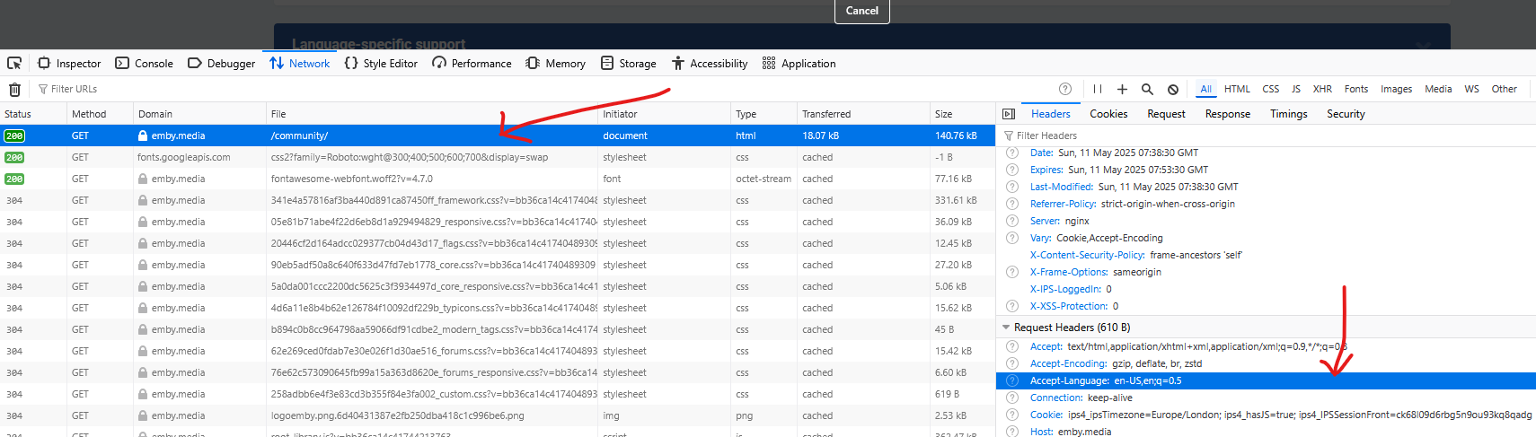

goin3d 4 Posted May 11, 2025 Posted May 11, 2025 I've added a 3rd file to my run to test out and i've been having trouble loading it. If i download the M3U locally it runs, but if i use the web address it fails to load: 10.May.2025 - 23:32:49 Include [Contains]: 10.May.2025 - 23:32:49 Include [StartsWith]: 10.May.2025 - 23:32:49 Use URL for tvgtype detection: True 10.May.2025 - 23:32:49 Task Started at: 5/10/2025 11:32:49 PM 10.May.2025 - 23:32:49 ----------------------------------------------------------------------- 10.May.2025 - 23:32:49 Create Movie Stream Files From M3U Scheduled Task Triggered. 10.May.2025 - 23:32:49 ----------------------------------------------------------------------- 10.May.2025 - 23:32:49 Input File 1: https://xxx/get.php?username=xxx&password=xxx&type=m3u_plus&output=mpegts 10.May.2025 - 23:32:49 Loading M3U file. 10.May.2025 - 23:32:49 Attempting to download file: https://xxx.xxx/get.php?username=xxxx&password=xxxxx&type=m3u_plus&output=mpegts 10.May.2025 - 23:32:49 Failed to download file: https://xxxx.xxx/get.php?username=xxxx&password=xxxxx&type=m3u_plus&output=mpegts. Error: Name or service not known (xx.xx:443) 10.May.2025 - 23:32:49 No lines found in the M3U file. 10.May.2025 - 23:32:49 Debugging: IsAoolloTV=False 10.May.2025 - 23:32:49 No Input File 2 10.May.2025 - 23:32:49 No Input File 3 10.May.2025 - 23:32:49 Total Input Files: 1 10.May.2025 - 23:32:49 Total m3u Items: 0 10.May.2025 - 23:32:49 Loading m3u File failed, exiting. 10.May.2025 - 23:32:49 Task Ended at: 5/10/2025 11:32:49 PM 10.May.2025 - 23:32:49 Task Duration: 00:00:00.03 In looking at the M3Us i've been running this one has a 2nd line in it that the others don't (in bold below). Could that be causing it to fail? It's really weird that using the URL fails, but using that same URL to download the file locally and then run it works. #EXTM3U #EXT-X-SESSION-DATA:DATA-ID="com.xui.1_5_13" #EXTINF:-1 tvg-id="somename" tvg-name="somename" tvg-logo="https://abc.123:443/images/LjMxooJdLoUjs_tBLxgrV0mr491X6WYzBJN9ILOmpaO-l9-Z28XxT-gT2DScS1c-.png" group-title="4K / UHD",somename https://xxx.xx:443/xxx/xxxx/abc123
mickle026 653 Posted May 11, 2025 Author Posted May 11, 2025 (edited) 3 hours ago, goin3d said: Error: Name or service not known This means that the name or url was not contactable, In other words, your computer tried to reach a website or server, but it didn’t recognize the name or couldn’t find the corresponding address. Can you ping that address and port? Typo maybe? The timeout for downloading is set at 10 minutes per file port 443 is a secure port for encrypting the data set back from the server - maybe ssl or tls. It could also be that specific headers are required to download from that site/port and the plugin might not be using them If you can capture the headers from the web browser F12 console that will help me check that, response and request to do this, press F12 before loading the page or reload it when the console is open. When the page has loaded or the browser starts to download the file, click the link to the file in the console and copy the headers on the right pane For your security, this data will be better sent via pm rather than posting it here. This is an example (this site) { "responseHeaders": { "headers": [ { "name": "Cache-Control", "value": "no-cache=\"Set-Cookie\", max-age=900, public, s-maxage=900, stale-while-revalidate, stale-if-error" }, { "name": "Connection", "value": "keep-alive" }, { "name": "Content-Encoding", "value": "gzip" }, { "name": "Content-Length", "value": "17409" }, { "name": "Content-Security-Policy", "value": "frame-ancestors 'self'" }, { "name": "Content-Security-Policy", "value": "upgrade-insecure-requests;" }, { "name": "Content-Type", "value": "text/html;charset=UTF-8" }, { "name": "Date", "value": "Sun, 11 May 2025 07:38:30 GMT" }, { "name": "Expires", "value": "Sun, 11 May 2025 07:53:30 GMT" }, { "name": "Last-Modified", "value": "Sun, 11 May 2025 07:38:30 GMT" }, { "name": "Referrer-Policy", "value": "strict-origin-when-cross-origin" }, { "name": "Server", "value": "nginx" }, { "name": "Vary", "value": "Cookie,Accept-Encoding" }, { "name": "X-Content-Security-Policy", "value": "frame-ancestors 'self'" }, { "name": "X-Frame-Options", "value": "sameorigin" }, { "name": "X-IPS-LoggedIn", "value": "0" }, { "name": "X-XSS-Protection", "value": "0" } ] } } { "requestHeaders": { "headers": [ { "name": "Accept", "value": "text/html,application/xhtml+xml,application/xml;q=0.9,*/*;q=0.8" }, { "name": "Accept-Encoding", "value": "gzip, deflate, br, zstd" }, { "name": "Accept-Language", "value": "en-US,en;q=0.5" }, { "name": "Connection", "value": "keep-alive" }, { "name": "Cookie", "value": "ips4_ipsTimezone=Europe/London; ips4_hasJS=true; ips4_IPSSessionFront=ck68l09d6rbg5n9ou93kq8qadg" }, { "name": "Host", "value": "emby.media" }, { "name": "If-Modified-Since", "value": "Sun, 11 May 2025 07:37:42 GMT" }, { "name": "Priority", "value": "u=0, i" }, { "name": "Sec-Fetch-Dest", "value": "document" }, { "name": "Sec-Fetch-Mode", "value": "navigate" }, { "name": "Sec-Fetch-Site", "value": "none" }, { "name": "Sec-Fetch-User", "value": "?1" }, { "name": "Upgrade-Insecure-Requests", "value": "1" }, { "name": "User-Agent", "value": "Mozilla/5.0 (Windows NT 10.0; Win64; x64; rv:138.0) Gecko/20100101 Firefox/138.0" } ] } } 3 hours ago, goin3d said: #EXT-X-SESSION-DATA:DATA-ID="com.xui.1_5_13" This line will not make it fail, the m3u once downloaded is "cleaned" of entries like this, so that all that is in the file when it loads is the extinf line and the urls private string[] CleanLines(string[] lines, string currentlog, IO.FileLogging log, PluginConfiguration config, CancellationToken cancellationToken) { // Check for cancellation if (cancellationToken.IsCancellationRequested) { log.LogToMyFile( currentlog, DateTime.Now.ToString("dd.MMM.yyy - HH':'mm':'ss") + " Task was cancelled.", 2 ).ConfigureAwait(false); cancellationToken.ThrowIfCancellationRequested(); } return lines.Where(line => { string trimmedLine = line?.Trim(); HashSet<string> EqualsWholeStrings = new HashSet<string> { "#EXTINF", "#EXTM3U", "#EXTINF:-1", "#EXTINF:0" }; HashSet<string> StartsWithStrings = new HashSet<string>(StringComparer.OrdinalIgnoreCase) { "#EXTM3U", "#EXTGRP:", "rem", "#EXT-X", "#EXTENC", "#EXT-X-STREAM-INF", "#EXT-X-MEDIA", "#EXT-X-PLAYLIST", "#PLAYLIST", "#EXTGRP", "#EXTALB", "#EXTART", "#EXTGENRE", "#EXTM3A", "#EXTBYT", "#EXTBIN", "#EXTIMG" }; // Check if the line is in the set of whole strings if (EqualsWholeStrings.Contains(trimmedLine)) return false; // Check if the line starts with any of the specified strings if (StartsWithStrings.Any(s => trimmedLine.StartsWith(s, StringComparison.OrdinalIgnoreCase))) return false; // Remove empty or whitespace lines if (string.IsNullOrWhiteSpace(trimmedLine)) return false; // Retain the line if it passes all conditions return true; }).ToArray(); } Edited May 11, 2025 by mickle026
goin3d 4 Posted May 11, 2025 Posted May 11, 2025 (edited) Thanks! I’ll try that. Edited May 11, 2025 by goin3d
mickle026 653 Posted May 11, 2025 Author Posted May 11, 2025 (edited) Although the plugin does upgrade secure requests, it might need a security protocol such as TLS explicitly defined. I have come across this before in another app, but not needed to switch on/off on demand. I should be able to tell from the headers... I sent a DLL via pm for you to test Edited May 11, 2025 by mickle026
goin3d 4 Posted May 11, 2025 Posted May 11, 2025 (edited) Thanks! that fixed it up for me! Doing a full run now of all 3 of my connections. Not sure how long it will take but we'll see what happens! In the latest versions is the reading of streams now single core? can't remember if i imagined that or you had mentioned it before? Edited May 11, 2025 by goin3d
mickle026 653 Posted May 11, 2025 Author Posted May 11, 2025 11 minutes ago, goin3d said: Thanks! that fixed it up for me! Doing a full run now of all 3 of my connections. Not sure how long it will take but we'll see what happens! In the latest versions is the reading of streams now single core? can't remember if i imagined that or you had mentioned it before? No, I havent changed that, its still multicore, i have only changed the writing of the strms, and now the http downloader to support secure sockets and tls in the version sent via pm
