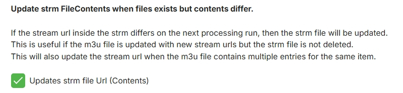

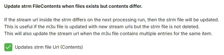

mickle026 653 Posted May 2, 2025 Author Posted May 2, 2025 42 minutes ago, jaspalgill said: If I upgrade to .170 but keep the directory output from .161 and then the strm folders get updated fine using the new logic. If I then re-enable the M3U extraction they work but then the strms stop being updated. If I delete them then they are lost and won't be re-created. not quite understanding what this means 44 minutes ago, jaspalgill said: disable the M3U extraction This is what changed at that time, so not re-writing files that exist. Quote If I delete them then they are lost and won't be re-created. if you point to a new folder are they created again?

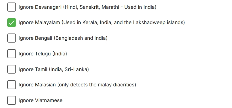

goin3d 4 Posted May 2, 2025 Posted May 2, 2025 (edited) Currently, have Japanese, Chinese, and Arabic selected with the latest version and it they are still written out for me: EDITED: my fault! had Koren and Chinese confused. Is it possible to add കമപളങങി നൈററസ - 2019 (I think it's Hindi?) Edited May 2, 2025 by goin3d

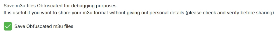

Apotropaic 62 Posted May 2, 2025 Posted May 2, 2025 1 hour ago, mickle026 said: I would check first if they are being filtered incorrectly. Are they being identified as Live TV for example and you don't have output for that checked? Any chance you can send me your m3u? There is an option to write it obfuscated now. not quite understanding what this means 1 hour ago, jaspalgill said: disable the M3U extraction Just as I hit submit I came to the same conclusion! Went to the chippy so just left it and was about to reboot the server when the file writer process kicked in and the strms have been written this time, correctly identified as Movies and TV Shows I'm going to give it another go with everything turned on in an empty folder structure, maybe in my new server it's only ever allocating itself 1-2gb so it's just taking longer than expected, looking as if it's not doing anything. When I meant disabling the M3U extraction, I just meant when it splits the playlists into separate Movies, TV Shows, Live TV M3U's.
mickle026 653 Posted May 2, 2025 Author Posted May 2, 2025 (edited) 1 hour ago, goin3d said: s it possible to add കമപളങങി നൈററസ - 2019 (I think it's Hindi?) Added Malayalam (India) with some others Protector of deep desires - കമപളങങി നൈററസ Edited May 2, 2025 by mickle026

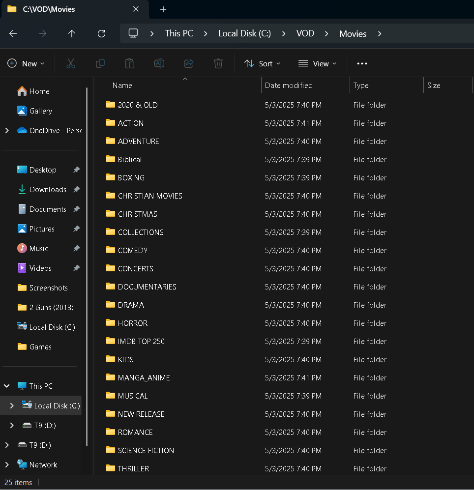

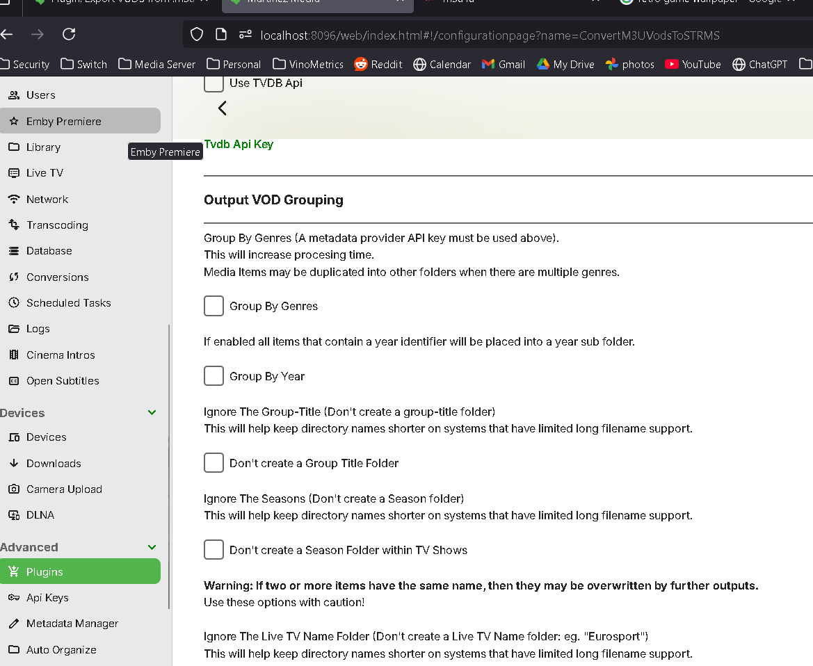

BigIrn 10 Posted May 2, 2025 Posted May 2, 2025 Anyone having issues where they can't turn GENRE off from outputting the streams even though it's not checked? @mickle026
mickle026 653 Posted May 2, 2025 Author Posted May 2, 2025 (edited) 22 minutes ago, BigIrn said: Anyone having issues where they can't turn GENRE off from outputting the streams even though it's not checked? @mickle026 You must have had use tmbd api turned on, and populating the genres, I have added a check to null it if the checkbox is not selected. VODtoSTRMscheduledTask.dll Edited May 2, 2025 by mickle026 1

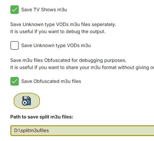

sundevil67 30 Posted May 3, 2025 Posted May 3, 2025 19 hours ago, mickle026 said: @sundevil67as suspected, they are all detected as Live TV urls For testing you can enable Save Live TV output because yours are all tv shows anyway. It will output them all to a Live TV folder, but they wont get mixed if you are never loading a live tv m3u file. Its only a folder name! it wont make any difference to the content I ran your m3u here (the one you sent via pm) and they detect properly as tv shows with that turned on you only need your first url in the first url box, it will download the rest automatically, you dont need to use url 2 or url3 https://****************/1 A new build is attached - can you enable this? It will output an obfuscated split m3u files Internally they should look like this #EXTM3U #EXTINF:-1 tvg-id="tt8332798" tvg-name="tt8332798" tvg-type="tvshows" group-title="Long Bright River (2025)" ,Long Bright River (2025) S01 E01 https://*************/*************/*************/tvshow/tt8332798/1/1 #EXTINF:-1 tvg-id="tt8332798" tvg-name="tt8332798" tvg-type="tvshows" group-title="Long Bright River (2025)" ,Long Bright River (2025) S01 E02 https://*************/*************/*************/tvshow/tt8332798/1/2 #EXTINF:-1 tvg-id="tt8332798" tvg-name="tt8332798" tvg-type="tvshows" group-title="Long Bright River (2025)" ,Long Bright River (2025) S01 E03 https://*************/*************/*************/tvshow/tt8332798/1/3 #EXTINF:-1 tvg-id="tt8332798" tvg-name="tt8332798" tvg-type="tvshows" group-title="Long Bright River (2025)" ,Long Bright River (2025) S01 E04 https://*************/*************/*************/tvshow/tt8332798/1/4 #EXTINF:-1 tvg-id="tt8332798" tvg-name="tt8332798" tvg-type="tvshows" group-title="Long Bright River (2025)" ,Long Bright River (2025) S01 E05 https://*************/*************/*************/tvshow/tt8332798/1/5 #EXTINF:-1 tvg-id="tt8332798" tvg-name="tt8332798" tvg-type="tvshows" group-title="Long Bright River (2025)" ,Long Bright River (2025) S01 E06 https://*************/*************/*************/tvshow/tt8332798/1/6 #EXTINF:-1 tvg-id="tt8332798" tvg-name="tt8332798" tvg-type="tvshows" group-title="Long Bright River (2025)" ,Long Bright River (2025) S01 E07 https://*************/*************/*************/tvshow/tt8332798/1/7 #EXTINF:-1 tvg-id="tt8332798" tvg-name="tt8332798" tvg-type="tvshows" group-title="Long Bright River (2025)" ,Long Bright River (2025) S01 E08 https://*************/*************/*************/tvshow/tt8332798/1/8 #EXTINF:-1 tvg-id="tt36108218" tvg-name="tt36108218" tvg-type="tvshows" group-title="Soviet Storm: WWII in the East (2025)" ,Soviet Storm: WWII in the East (2025) S01 E01 https://*************/*************/*************/tvshow/tt36108218/1/1 #EXTINF:-1 tvg-id="tt36108218" tvg-name="tt36108218" tvg-type="tvshows" group-title="Soviet Storm: WWII in the East (2025)" ,Soviet Storm: WWII in the East (2025) S01 E02 https://*************/*************/*************/tvshow/tt36108218/1/2 #EXTINF:-1 tvg-id="tt36108218" tvg-name="tt36108218" tvg-type="tvshows" group-title="Soviet Storm: WWII in the East (2025)" ,Soviet Storm: WWII in the East (2025) S01 E03 https://*************/*************/*************/tvshow/tt36108218/1/3 #EXTINF:-1 tvg-id="tt36108218" tvg-name="tt36108218" tvg-type="tvshows" group-title="Soviet Storm: WWII in the East (2025)" ,Soviet Storm: WWII in the East (2025) S01 E04 https://*************/*************/*************/tvshow/tt36108218/1/4 #EXTINF:-1 tvg-id="tt36108218" tvg-name="tt36108218" tvg-type="tvshows" group-title="Soviet Storm: WWII in the East (2025)" ,Soviet Storm: WWII in the East (2025) S01 E05 https://*************/*************/*************/tvshow/tt36108218/1/5 This will allow you to send me a full version of all the parts in one file. VODtoSTRMscheduledTask.dll 911 kB · 3 downloads I still can't get it to write any strm files ScheduledTask-[M3UToStrm]_02.May.2025-17.13.03.txt

BigIrn 10 Posted May 4, 2025 Posted May 4, 2025 (edited) On 5/1/2025 at 4:56 PM, mickle026 said: OK, I think all your requests are now complete @goin3d Now an option whether or not to re-write files that differ, there is not a huge lot I can do here. I have created a test for files that exist, if they do it wont overwrite them, but what is left is these duplicate entries that have a different url. You choose either to update urls or not. This will affect if anything else is updated to a new url location. So now if the output file already exists you can choose by unchecking the box, not to write the second file with a different url over it, this will affect any other urls that have changed. 01.May.2025 - 14:38:41 Debugging: [scanM3UFileAsync] m3uContents Contains: 26 Items. 01.May.2025 - 14:38:41 -----------------------[ Updating Output Folder ]------------------------------- 01.May.2025 - 14:38:41 Debugging: Setting Filesystem Update to 12 of 16 cores/threads to prevent system freeze. 01.May.2025 - 14:38:41 Debugging: Remove Obsolete Files: True. 01.May.2025 - 14:38:41 Debugging: Files to check: 15. 01.May.2025 - 14:38:41 Debugging: Remove Obsolete Files - Progress: 7.69%, Memory used: 26 MB. 01.May.2025 - 14:38:41 Debugging: Remove Obsolete Files - Progress: 46.15%, Memory used: 26 MB. 01.May.2025 - 14:38:41 Starting FileRemover: 0 Items to delete. 01.May.2025 - 14:38:41 Checking for folder deletion Tasks. 01.May.2025 - 14:38:41 Skipped root folder: D:\VODS\goig3d-test.m3u (contains .strm files or subfolders containing them). 01.May.2025 - 14:38:41 All delete tasks completed. 01.May.2025 - 14:38:41 All Updating tasks completed. 01.May.2025 - 14:38:41 Debugging: Item(s) count: 1 01.May.2025 - 14:38:41 Debugging: StrmsToWriteBag.Count=1 01.May.2025 - 14:38:41 Starting File Writer: 1 Items to write/update. 01.May.2025 - 14:38:41 Item [1] Already Exists! - I/O Queued for Overwwriting [TV Shows]: D:\VODS\goig3d-test.m3u\TV Shows\Mystery\Big Mouth\Season 01\Big_Mouth_S01_E08.strm 01.May.2025 - 14:38:41 Debugging: Fetch Images: False. 01.May.2025 - 14:38:41 Finished this import. 01.May.2025 - 14:38:41 Task Ended at: 01/05/2025 14:38:41 01.May.2025 - 14:38:41 Task Duration: 00:00:01.93 @BigIrn Finally found a place to put the string manipulations after ignore/includes so they behave as before adding underscores etc. The extra manipulations here were added when trying to find out what was causing re-writes so not much thought was given to where it should happen, but it seems ok now. Please test away VODtoSTRMscheduledTask.dll 905.5 kB · 5 downloads Womp womp... still in genres. embyserver(8).txt ScheduledTask-[M3UToStrm]03.May.2025 - 10.41.08.txt Edited May 4, 2025 by GrimReaper Attachment removed
mickle026 653 Posted May 4, 2025 Author Posted May 4, 2025 (edited) 9 hours ago, BigIrn said: Womp womp... still in genres. embyserver(8).txt 26.85 MB · 0 downloads ScheduledTask-[M3UToStrm]03.May.2025 - 10.41.08.txt 39.25 MB · 0 downloads Are you sure this is not a group-title in your m3u file? the log you posted does not show any of the m3u elements being read so I cannot tell. but with group-title being unchecked, it should create one so my suspicion is this is group-title in your m3u file and your provider has used genres there. Try "Don't Create a group title folder" in the screenshot above and see if its the same Can you send me a copy of your m3u via pm. Obfuscated is fine. Select obfuscated output and a type and it'll create it for you in your split strm directory Screenshot below shows how to do this If you have Extra Verbose logging on, Constructed Folder Name [2]: groupTitle= if this is a genre then turn on "Don't create a Group Title Folder" Edited May 4, 2025 by GrimReaper Edited Quote 1

Apotropaic 62 Posted May 4, 2025 Posted May 4, 2025 7 hours ago, mickle026 said: Are you sure this is not a group-title in your m3u file? the log you posted does not show any of the m3u elements being read so I cannot tell. but with group-title being unchecked, it should create one so my suspicion is this is group-title in your m3u file and your provider has used genres there. Try "Don't Create a group title folder" in the screenshot above and see if its the same I think @mickle026is right here, they look like the same Group Titles that I have in mine, so are more like categories the provider has set. @BigIrnif you follow what was recommended it will put all the movies into the root of the folder, for me the list is just too big and I prefer to pick and choose which film 'category' I import into my library. 1
