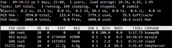

Apotropaic 62 Posted April 29, 2025 Posted April 29, 2025 1 hour ago, fbrassin said: Moreover, with this new version after running the plugin emby becames unresponding. It happened after the first run, but i thought it was casually, but it happened also after second and third time a run this latest version. The third time i run it on an empty dir. I'm getting the same issue, I'm presuming @mickle026hasn't enabled the low memory function so it's running wild The memory usage seems to jump when it's at the 'Updating Output Folder' stage. It might just be the way memory management works in linux systems when compared to windows, as well as a function of how much memory your system has and the size of your M3U file. I'm sure if we all had 32gb we would be fine! My system is in a loop where the memory management (kswapd0) is using 100% of the CPU just moving memory around, which is starving emby of CPU, which may explain why on some systems the scans take so long. I'll let this try and finish, then give my VM a bit more memory and see what happens. Update: After 20 minutes emby is getting around 33-35% CPU as kswapd0 is now hovering around 97-100% but the emby GUI is still unresponsive. Also, I'm only running the first log events debug setting. No additional debugging.
mickle026 653 Posted April 29, 2025 Author Posted April 29, 2025 updated output settings to use memory & cpu limiter when the limit option is selected within this function, I simply set to use 80% cores (or nearest value) instead of wait for resources for now as it is less complicated and will work on all systems 29.Apr.2025 - 12:51:16 Debugging: Setting Filesystem Update to 12 of 16 cores/threads to prevent system freeze. 29.Apr.2025 - 12:51:16 Debugging: StrmsToWriteBag.Count=0 29.Apr.2025 - 12:51:16 Starting File Writer: 0 Items to write/update. 29.Apr.2025 - 12:51:16 All write tasks completed. 29.Apr.2025 - 12:51:16 Debugging: Fetch Images: False. 29.Apr.2025 - 12:51:16 Debugging: Remove Obsolete Files: True. 29.Apr.2025 - 12:51:16 Debugging: Files to check: 2353. 29.Apr.2025 - 12:51:16 Debugging: Remove Obsolete Files - Progress: 4.04%, Memory used: 34 MB. 29.Apr.2025 - 12:51:16 Debugging: Remove Obsolete Files - Progress: 9.08%, Memory used: 34 MB. 29.Apr.2025 - 12:51:16 Debugging: Remove Obsolete Files - Progress: 14.12%, Memory used: 34 MB. 29.Apr.2025 - 12:51:16 Debugging: Remove Obsolete Files - Progress: 19.16%, Memory used: 34 MB. 29.Apr.2025 - 12:51:16 Debugging: Remove Obsolete Files - Progress: 24.20%, Memory used: 34 MB. 29.Apr.2025 - 12:51:16 Debugging: Remove Obsolete Files - Progress: 29.28%, Memory used: 34 MB. 29.Apr.2025 - 12:51:16 Debugging: Remove Obsolete Files - Progress: 34.32%, Memory used: 34 MB. 29.Apr.2025 - 12:51:16 Debugging: Remove Obsolete Files - Progress: 39.36%, Memory used: 34 MB. 29.Apr.2025 - 12:51:16 Debugging: Remove Obsolete Files - Progress: 44.40%, Memory used: 34 MB. 29.Apr.2025 - 12:51:16 Debugging: Remove Obsolete Files - Progress: 49.44%, Memory used: 34 MB. 29.Apr.2025 - 12:51:16 Debugging: Remove Obsolete Files - Progress: 54.48%, Memory used: 34 MB. 29.Apr.2025 - 12:51:16 Debugging: Remove Obsolete Files - Progress: 59.56%, Memory used: 34 MB. 29.Apr.2025 - 12:51:16 Debugging: Remove Obsolete Files - Progress: 64.60%, Memory used: 34 MB. 29.Apr.2025 - 12:51:17 Debugging: Remove Obsolete Files - Progress: 69.64%, Memory used: 34 MB. 29.Apr.2025 - 12:51:17 Debugging: Remove Obsolete Files - Progress: 74.68%, Memory used: 34 MB. 29.Apr.2025 - 12:51:17 Debugging: Remove Obsolete Files - Progress: 79.72%, Memory used: 34 MB. 29.Apr.2025 - 12:51:17 Debugging: Remove Obsolete Files - Progress: 84.96%, Memory used: 34 MB. 29.Apr.2025 - 12:51:17 Debugging: Remove Obsolete Files - Progress: 90.00%, Memory used: 34 MB. 29.Apr.2025 - 12:51:17 Debugging: Remove Obsolete Files - Progress: 95.04%, Memory used: 34 MB. 29.Apr.2025 - 12:51:17 Starting FileRemover: 0 Items to delete. 29.Apr.2025 - 12:51:17 Checking for folder deletion Tasks. 29.Apr.2025 - 12:51:17 Skipped root folder: D:\VODS\ (contains .strm files or subfolders containing them). 29.Apr.2025 - 12:51:17 All delete tasks completed. 29.Apr.2025 - 12:51:17 All Updating tasks completed. 29.Apr.2025 - 12:51:17 Finished this import. VODtoSTRMscheduledTask.dll
Apotropaic 62 Posted April 29, 2025 Posted April 29, 2025 5 hours ago, mickle026 said: updated output settings to use memory & cpu limiter when the limit option is selected within this function, I simply set to use 80% cores (or nearest value) instead of wait for resources for now as it is less complicated and will work on all systems Something in the .167 build is crashing Emby, I've tried it a few times now and sometimes the emby process dies after 20-30 minutes or sometimes the server hangs. Note: this is for the first initial run with empty directories. I don't have a test setup so I'll wait until tonight to do another run with a debug turned on. This is probably why I should setup a test environment!

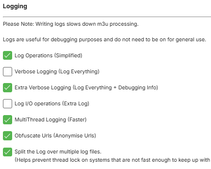

Apotropaic 62 Posted April 29, 2025 Posted April 29, 2025 Just now, mickle026 said: What is it doing when it crashes, where does it get to? I only have the 'Log Operations' ticked right now, it gets to this stage within 3 minutes of the start. It's at this point the CPU/memory usage jumps and the crashes happen around 20 minutes after. I've just started another run but with Verbose & Debug on. 29.Apr.2025 - 16:42:47 -----------------------[ Scanning Current Folders ]---------------------------- 29.Apr.2025 - 16:42:47 Memory used: 792 MB 29.Apr.2025 - 16:42:47 Scanning Output Directory for content: /home/emby/Testing/Test3a/Library. 29.Apr.2025 - 16:42:47 Debugging: Attempt 1: scannedcount = -1, strmfilescount = 0 29.Apr.2025 - 16:42:47 Found 0 folders in Output path. Scanning... 29.Apr.2025 - 16:42:48 The output directory is empty. 29.Apr.2025 - 16:42:48 ----------------------[ Reading M3U File Contents ]---------------------------- 29.Apr.2025 - 16:45:39 Saved '/home/emby/Testing/Test3a/M3U/LiveTV/LiveTV.m3u' 29.Apr.2025 - 16:45:39 Saved '/home/emby/Testing/Test3a/M3U/Movies/Movies.m3u' 29.Apr.2025 - 16:45:40 Saved '/home/emby/Testing/Test3a/M3U/TV Shows/TV Shows.m3u' 29.Apr.2025 - 16:45:40 Unknown M3U Items found: 0. 29.Apr.2025 - 16:45:40 Debugging: M3U file processing completed. 29.Apr.2025 - 16:45:40 Debugging: [scanM3UFileAsync] m3uContents Contains: 317049 Items. 29.Apr.2025 - 16:45:40 -----------------------[ Updating Output Folder ]-------------------------------
Apotropaic 62 Posted April 29, 2025 Posted April 29, 2025 (edited) I started the task at 18:36 and at 19:07 it stopped logging anything new, I checked the sever at 21:00 and it was unresponsive. I had the following debug settings. Task started at 29.Apr.2025-18:36:04. 29.Apr.2025 - 19:07:05 Debugging: [AddToContentListAsync] Memory used: 799 MB 29.Apr.2025 - 19:07:05 [AddToContentListAsync] Adding to m3uContents - Count = 317056 29.Apr.2025 - 19:07:05 ====================================== 29.Apr.2025 - 19:07:05 Saved '/home/emby/Testing/Test3a/M3U/LiveTV/LiveTV.m3u' 29.Apr.2025 - 19:07:05 Live TV M3U Items found: 10332. 29.Apr.2025 - 19:07:05 Saved '/home/emby/Testing/Test3a/M3U/Movies/Movies.m3u' 29.Apr.2025 - 19:07:05 Movies M3U Items found: 35630. 29.Apr.2025 - 19:07:05 Saved '/home/emby/Testing/Test3a/M3U/TV Shows/TV Shows.m3u' 29.Apr.2025 - 19:07:05 TV Show M3U Items found: 271094. 29.Apr.2025 - 19:07:05 Unknown M3U Items found: 0. 29.Apr.2025 - 19:07:05 ====================================== 29.Apr.2025 - 19:07:05 Debugging: Memory used: 799 MB 29.Apr.2025 - 19:07:05 Debugging: Time taken to process M3U file: 00:30:32 29.Apr.2025 - 19:07:05 Debugging: M3U file processing completed. 29.Apr.2025 - 19:07:05 Debugging: [scanM3UFileAsync] m3uContents Contains: 317056 Items. 29.Apr.2025 - 19:07:05 -----------------------[ Updating Output Folder ]------------------------------- Edited April 29, 2025 by jaspalgill
mickle026 653 Posted April 30, 2025 Author Posted April 30, 2025 3 hours ago, jaspalgill said: I started the task at 18:36 and at 19:07 it stopped logging anything new, I checked the sever at 21:00 and it was unresponsive. I had the following debug settings. Task started at 29.Apr.2025-18:36:04. 29.Apr.2025 - 19:07:05 Debugging: [AddToContentListAsync] Memory used: 799 MB 29.Apr.2025 - 19:07:05 [AddToContentListAsync] Adding to m3uContents - Count = 317056 29.Apr.2025 - 19:07:05 ====================================== 29.Apr.2025 - 19:07:05 Saved '/home/emby/Testing/Test3a/M3U/LiveTV/LiveTV.m3u' 29.Apr.2025 - 19:07:05 Live TV M3U Items found: 10332. 29.Apr.2025 - 19:07:05 Saved '/home/emby/Testing/Test3a/M3U/Movies/Movies.m3u' 29.Apr.2025 - 19:07:05 Movies M3U Items found: 35630. 29.Apr.2025 - 19:07:05 Saved '/home/emby/Testing/Test3a/M3U/TV Shows/TV Shows.m3u' 29.Apr.2025 - 19:07:05 TV Show M3U Items found: 271094. 29.Apr.2025 - 19:07:05 Unknown M3U Items found: 0. 29.Apr.2025 - 19:07:05 ====================================== 29.Apr.2025 - 19:07:05 Debugging: Memory used: 799 MB 29.Apr.2025 - 19:07:05 Debugging: Time taken to process M3U file: 00:30:32 29.Apr.2025 - 19:07:05 Debugging: M3U file processing completed. 29.Apr.2025 - 19:07:05 Debugging: [scanM3UFileAsync] m3uContents Contains: 317056 Items. 29.Apr.2025 - 19:07:05 -----------------------[ Updating Output Folder ]------------------------------- Can you run again with IO logging on and inspect that to see if file writes are failing so we might have a clue why it is stopping? That might possibly have a clue in it.

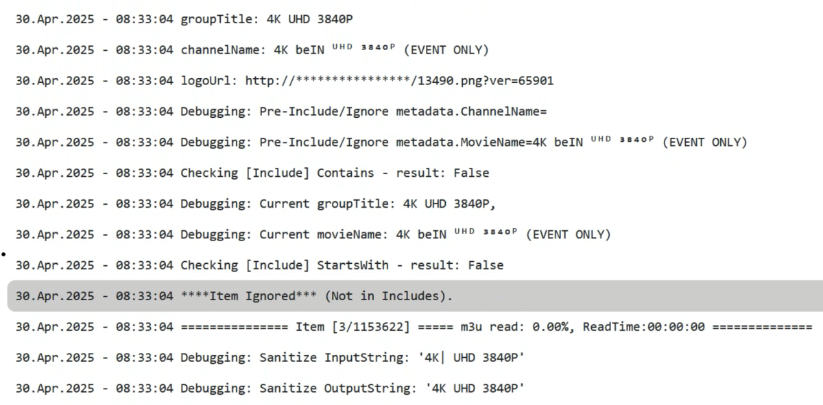

BigIrn 10 Posted April 30, 2025 Posted April 30, 2025 (edited) Not sure what I did wrong. ver 167. It is not writing to an empty new folder (c:vods). ScheduledTask-[M3UToStrm]_29.Apr.2025-22.38.13_Part[6].zip Edited April 30, 2025 by BigIrn
mickle026 653 Posted April 30, 2025 Author Posted April 30, 2025 (edited) 3 hours ago, BigIrn said: Not sure what I did wrong. ver 167. It is not writing to an empty new folder (c:vods). ScheduledTask-[M3UToStrm]_29.Apr.2025-22.38.13_Part[6].zip 54.63 MB · 1 download ****Item Ignored*** (Not in Includes) Everything is filtered out by your Includes, so you are looking for only this/these item(s) and do not have any. What is your config here? I think you have replace spaces with underscores ON, so you probably need to add "EN_,EN_|,US_,US_|" etc to includes, the same variants with no spaces but underscores Example: EN ,EN -,EN|,EN_,US ,US|,US_,UK,|EN|,EN_|,US_| I would need to check though, but no time right now. Edited April 30, 2025 by mickle026

BigIrn 10 Posted April 30, 2025 Posted April 30, 2025 11 minutes ago, mickle026 said: can you give me an example? I am not sure what you mean by this question so an example would help. What is the order of operation? Does it pull metadata first before it determines whether to keep or ignore the stream? Why not exclude first before sending an api call if it will ultimately not be used? I hope that makes sense.
mickle026 653 Posted April 30, 2025 Author Posted April 30, 2025 3 hours ago, BigIrn said: What is the order of operation? Does it pull metadata first before it determines whether to keep or ignore the stream? Why not exclude first before sending an api call if it will ultimately not be used? I hope that makes sense. So basically you would like the underscores applying after the includes/ignores?
BigIrn 10 Posted April 30, 2025 Posted April 30, 2025 4 hours ago, mickle026 said: So basically you would like the underscores applying after the includes/ignores? Yeah. Exclude and retain the strms that are going to be outputted AFTER all of the filtering and THEN do all the file/string changes/manipulation, especially any api calls if we use the TMDB. I don't know if this is possible but just a thought. I'm running the latest version and it's at 54% and we are at the 10 hour mark. I'm trying to convert 1,153,232 possible urls and I have all the logging turned on so I know it will take a long time.
