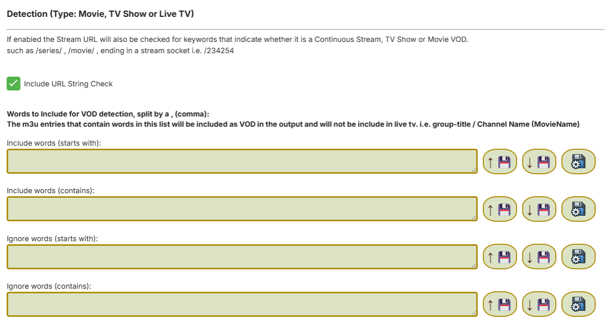

goin3d 4 Posted April 16, 2025 Posted April 16, 2025 @mickle026apologies if this was covered elsewhere. While processing if I would like to skip an entire group and everything under it from processing, for example under Series: "Belgium Kids (FR)" would i just add the group name here, or am i totally off base?

mickle026 653 Posted April 16, 2025 Author Posted April 16, 2025 4 minutes ago, goin3d said: @mickle026apologies if this was covered elsewhere. While processing if I would like to skip an entire group and everything under it from processing, for example under Series: "Belgium Kids (FR)" would i just add the group name here, or am i totally off base? You can put that in either ignore box. The first one ignore it only if its at the start of the line, the second one ignores it anywhere in the data So if you ignore words (contains) "(FR)" Then anything - including subtitled or dubbed that contained (FR)anywhere in the string would get ignored, but if you put "Belgium Kids (FR)" Then only this group would get ignored. Its pretty flexible I suggest you create a few smaller m3u files and test the output in another directory until you can achieve what you desire

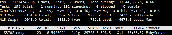

mickle026 653 Posted April 16, 2025 Author Posted April 16, 2025 (edited) OK, I have added cpu limiter. 50% CPU (8 of 16 cores) 16.Apr.2025 - 23:56:44 Saved 'D:\splitm3ufiles\TV Shows\TV Shows.m3u' 16.Apr.2025 - 23:56:44 TV Show M3U Items found: 5000. 16.Apr.2025 - 23:56:44 Unknown M3U Items found: 0. 16.Apr.2025 - 23:56:44 ====================================== 16.Apr.2025 - 23:56:44 Debugging: Memory used: 112 MB 16.Apr.2025 - 23:56:44 Debugging: Time taken to process M3U file: 00:01:19 16.Apr.2025 - 23:56:44 Debugging: M3U file processing completed. 16.Apr.2025 - 23:56:44 Debugging: [scanM3UFileAsync] m3uContents Contains: 5000 Items. 16.Apr.2025 - 23:56:44 -----------------------[ Updating Output Folder ]------------------------------- 16.Apr.2025 - 23:56:44 Using; 8 cores/threads. 16.Apr.2025 - 23:56:44 Starting File Writer: 0 Items to write/update. 16.Apr.2025 - 23:56:44 Starting FileRemover: 0 Items to delete. 16.Apr.2025 - 23:56:44 Checking for folder deletion Tasks. 16.Apr.2025 - 23:56:45 Skipped root folder: D:\VODS3 (contains .strm files or subfolders containing them). 16.Apr.2025 - 23:56:45 All delete tasks completed. 16.Apr.2025 - 23:56:45 Finished this import. 16.Apr.2025 - 23:56:45 Task Ended at: 16/04/2025 23:56:45 16.Apr.2025 - 23:56:45 Task Duration: 00:01:23.47 16.Apr.2025 - 23:56:45 Task completed. 16.Apr.2025 - 23:56:45 CreateMovieStrmsFromM3UTaskStarter method completed. 16.Apr.2025 - 23:56:45 Finished. No changes detected on second scan, so nothing updated and nothing deleted VODtoSTRMscheduledTask.dll Edited April 16, 2025 by mickle026

goin3d 4 Posted April 16, 2025 Posted April 16, 2025 3 hours ago, mickle026 said: You can put that in either ignore box. The first one ignore it only if its at the start of the line, the second one ignores it anywhere in the data So if you ignore words (contains) "(FR)" Then anything - including subtitled or dubbed that contained (FR)anywhere in the string would get ignored, but if you put "Belgium Kids (FR)" Then only this group would get ignored. Its pretty flexible I suggest you create a few smaller m3u files and test the output in another directory until you can achieve what you desire thanks! conversely if i add something to the "Include Words (start with)" would it ignore everything else? for example lets say you had a file with 50 VOD categories and you only wanted 2 of them. would you include the two or have to exclude the other 48?
mickle026 653 Posted April 16, 2025 Author Posted April 16, 2025 (edited) 13 minutes ago, goin3d said: thanks! conversely if i add something to the "Include Words (start with)" would it ignore everything else? for example lets say you had a file with 50 VOD categories and you only wanted 2 of them. would you include the two or have to exclude the other 48? Depends what you want, Put the 2 of them in include and it will ignore the rest (it will ignore live tv and movies too though) Put something like: "EN - ","Action VOD" in includes and "XXX" in excludes in includes and it will include all "EN - ", so all live tv, movies etc, but then only include "Action VOD" and it will ignore all "XXX" Have a play on a smaller m3u file, copy some of what you want and some of what you dont want into a new txt file and run it on another output folder further down in the options you can choose only to output movies, only live tv, only tv shows, or a combination, its up to you! Edited April 16, 2025 by mickle026
