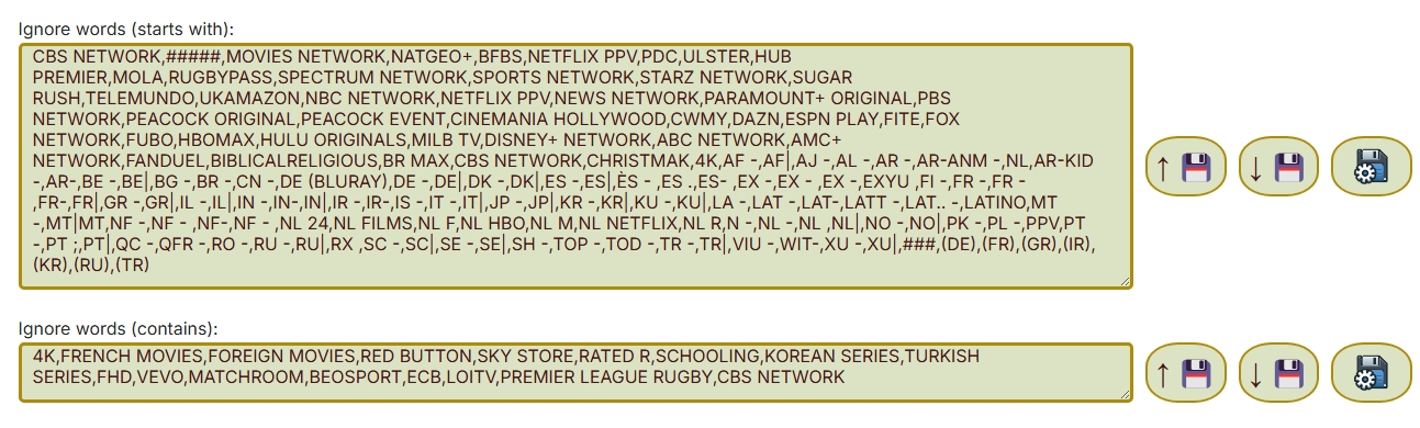

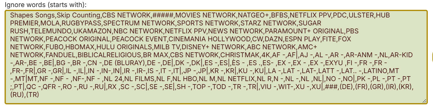

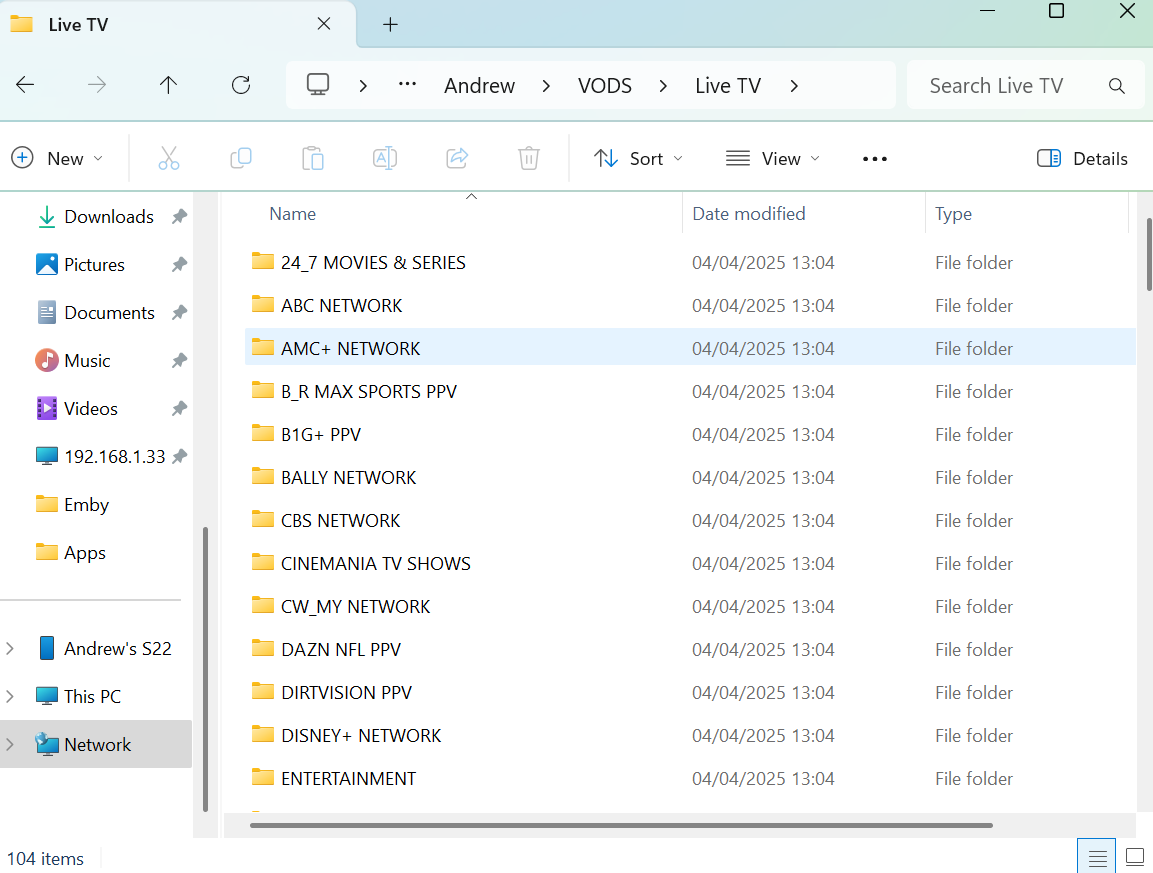

gillmacca01 220 Posted April 4, 2025 Posted April 4, 2025 Also LiveTV output folder is still showing content that is in my ignore list. example: CBS Network

mickle026 653 Posted April 4, 2025 Author Posted April 4, 2025 2 hours ago, gillmacca01 said: Also LiveTV output folder is still showing content that is in my ignore list. example: CBS Network I can see it getting through in the logs 04.Apr.2025 - 15:59:03 Debugging: Sanitize InputString: 'US| CBS NETWORK' 04.Apr.2025 - 15:59:03 Debugging: Sanitize OutputString: 'US CBS NETWORK' 04.Apr.2025 - 15:59:03 Debugging: Sanitize InputString: 'US| CBS 4 DOTHAN AL (WTVY)' 04.Apr.2025 - 15:59:03 Debugging: Sanitize OutputString: 'US CBS 4 DOTHAN AL (WTVY)' 04.Apr.2025 - 15:59:03 Removed Country code: Input: 'US CBS 4 DOTHAN AL (WTVY)', Output: 'CBS 4 DOTHAN AL (WTVY)' 04.Apr.2025 - 15:59:03 Debugging: Called from=ExtractMetadataAsync:metadata.MovieName 04.Apr.2025 - 15:59:03 Removed Country code: Input: 'US CBS NETWORK', Output: 'CBS NETWORK' 04.Apr.2025 - 15:59:03 Debugging: Called from=ExtractMetadataAsync:metadata.GroupTitle 04.Apr.2025 - 15:59:03 tvgId: loc.CBS (WTVY) Dothan, AL 04.Apr.2025 - 15:59:03 tvgName: US| CBS 4 DOTHAN AL (WTVY) 04.Apr.2025 - 15:59:03 groupTitle: CBS NETWORK 04.Apr.2025 - 15:59:03 channelName: CBS 4 DOTHAN AL (WTVY) 04.Apr.2025 - 15:59:03 logoUrl: http://**********/CBS-4-EL-PASO-TX-KDBC.png 04.Apr.2025 - 15:59:03 Debugging: Pre-Include/Ignore metadata.ChannelName= 04.Apr.2025 - 15:59:03 Debugging: Pre-Include/Ignore metadata.MovieName=CBS 4 DOTHAN AL (WTVY) 04.Apr.2025 - 15:59:03 Checking [Include] Contains 04.Apr.2025 - 15:59:03 Checking [Include] StartsWith 04.Apr.2025 - 15:59:03 **FILTER** Keeping [groupTitle] [6120]: US CBS NETWORK :Filtered by: 'US ' 04.Apr.2025 - 15:59:03 Checking [Include] StartsWith, Include: True 04.Apr.2025 - 15:59:03 Debugging: Keep=True. 04.Apr.2025 - 15:59:03 Checking [Ignore] Contains 04.Apr.2025 - 15:59:03 Checking [Ignore] StartsWith 04.Apr.2025 - 15:59:03 Debugging: Ignore=False. 04.Apr.2025 - 15:59:03 Include / Ignore checking passed succesfully. 04.Apr.2025 - 15:59:03 Ingnore/Include Total execution time: 2 ms 04.Apr.2025 - 15:59:03 Debugging: [ProcessContentAsync] sanitizedMovieName=CBS 4 DOTHAN AL (WTVY), unsantised Name=CBS 4 DOTHAN AL (WTVY) 04.Apr.2025 - 15:59:03 Debugging: Inside GetShowTitle, Before Season Removal, Input=CBS 4 DOTHAN AL (WTVY) 04.Apr.2025 - 15:59:03 Debugging: Inside GetShowTitle, IsitAnEdgeCaseTVShow?, Input=CBS 4 DOTHAN AL (WTVY) 04.Apr.2025 - 15:59:03 Debugging: Inside GetShowTitle, after moviePattern regex, Input=CBS 4 DOTHAN AL (WTVY) 04.Apr.2025 - 15:59:03 Debugging: Inside GetShowTitle, after volumePattern regex, Input=CBS 4 DOTHAN AL (WTVY) 04.Apr.2025 - 15:59:03 Debugging: Inside GetShowTitle, after seasonEpisodePattern regex, Input=CBS 4 DOTHAN AL (WTVY) 04.Apr.2025 - 15:59:03 Debugging: Inside GetShowTitle, after parentheses with year ranges regex, Input=CBS 4 DOTHAN AL (WTVY) 04.Apr.2025 - 15:59:03 Debugging: Inside GetShowTitle, after Season Removal, Input=CBS 4 DOTHAN AL (WTVY) 04.Apr.2025 - 15:59:03 Debugging: [ProcessContentAsync] Pre build Path, ShowTitle=CBS 4 DOTHAN AL (WTVY) 04.Apr.2025 - 15:59:03 Debugging: [ProcessContentAsync] Pre build Path, GroupTitle=CBS NETWORK 04.Apr.2025 - 15:59:03 Debugging - Checking for URL strings.. 04.Apr.2025 - 15:59:03 Type: Live TV - Detected a Stream Url: '173123' 04.Apr.2025 - 15:59:03 Debugging: tvgType after AdjustContent=Live TV. 04.Apr.2025 - 15:59:03 Debugging: filename1=CBS 4 DOTHAN AL (WTVY).strm 04.Apr.2025 - 15:59:03 Debugging: GroupTitle1=CBS NETWORK 04.Apr.2025 - 15:59:03 Debugging: AddContentAsync Inputs: outputDirectory=D:\VODS2, tvgType=Live TV, groupTitle=CBS NETWORK, showTitle=CBS 4 DOTHAN AL (WTVY), season=NULL, fileName=CBS 4 DOTHAN AL (WTVY).strm, fileContents=http://**********/CBS-4-EL-PASO-TX-KDBC.png, year=unknown_year, genres= 04.Apr.2025 - 15:59:03 Debugging: [IsitAnEdgeCaseMovie] Detection Result: (False),(CBS 4 DOTHAN AL (WTVY)) 04.Apr.2025 - 15:59:03 sanitized groupTitle [ Path.Combine() folderName]: CBS NETWORK 04.Apr.2025 - 15:59:03 Constructed Folder Name [2]: D:\VODS2\Live TV\CBS NETWORK\CBS 4 DOTHAN AL (WTVY) 04.Apr.2025 - 15:59:03 Constructed Folder Name [2]: groupTitle=CBS NETWORK 04.Apr.2025 - 15:59:03 Constructed Folder Name [2]: showTitle=CBS 4 DOTHAN AL (WTVY) 04.Apr.2025 - 15:59:03 Debugging AddToContentListAsync: folderName=D:\VODS2\Live TV\CBS NETWORK\CBS 4 DOTHAN AL (WTVY), fileName=CBS 4 DOTHAN AL (WTVY).strm, fileContents=http://**********/173123 04.Apr.2025 - 15:59:03 Item [12238] Adding to Folder: D:\VODS2\Live TV\CBS NETWORK\CBS 4 DOTHAN AL (WTVY) I will see if I can fathom out why
gillmacca01 220 Posted April 4, 2025 Posted April 4, 2025 I've just tried running it twice and both times Emby crashed with out of memory message in the logs
mickle026 653 Posted April 4, 2025 Author Posted April 4, 2025 4 hours ago, gillmacca01 said: Also LiveTV output folder is still showing content that is in my ignore list. example: CBS Network Did you try putting CBS NETWORK into "Ignore Contains"? You are filtering "starts with" but they don't start with CBS NETWORK, they start with "US" 04.Apr.2025 - 17:50:43 Debugging: Sanitize InputString: 'US| CBS NETWORK' 04.Apr.2025 - 17:50:43 Debugging: Sanitize OutputString: 'US CBS NETWORK' 04.Apr.2025 - 17:50:43 Debugging: Sanitize InputString: 'US| CBS 3 PHILADELPHIA PA (KYW)' 04.Apr.2025 - 17:50:43 Debugging: Sanitize OutputString: 'US CBS 3 PHILADELPHIA PA (KYW)' 04.Apr.2025 - 17:50:43 Removed Country code: Input: 'US CBS 3 PHILADELPHIA PA (KYW)', Output: 'CBS 3 PHILADELPHIA PA (KYW)' 04.Apr.2025 - 17:50:43 Debugging: Called from=ExtractMetadataAsync:metadata.MovieName 04.Apr.2025 - 17:50:43 Removed Country code: Input: 'US CBS NETWORK', Output: 'CBS NETWORK' 04.Apr.2025 - 17:50:43 Debugging: Called from=ExtractMetadataAsync:metadata.GroupTitle 04.Apr.2025 - 17:50:43 tvgId: loc.CBS (KYW) Philadelphia, PA 04.Apr.2025 - 17:50:43 tvgName: US| CBS 3 PHILADELPHIA PA (KYW) 04.Apr.2025 - 17:50:43 groupTitle: CBS NETWORK 04.Apr.2025 - 17:50:43 channelName: CBS 3 PHILADELPHIA PA (KYW) 04.Apr.2025 - 17:50:43 logoUrl: http://**********/CBS-3-NORFOLK-VA-WTKR.png 04.Apr.2025 - 17:50:43 Debugging: Pre-Include/Ignore metadata.ChannelName= 04.Apr.2025 - 17:50:43 Debugging: Pre-Include/Ignore metadata.MovieName=CBS 3 PHILADELPHIA PA (KYW) 04.Apr.2025 - 17:50:43 Checking [Include] Contains - result: False 04.Apr.2025 - 17:50:43 **FILTER** Keeping [groupTitle] [162]: US CBS NETWORK :Filtered by: 'US ' 04.Apr.2025 - 17:50:43 Checking [Include] StartsWith - result: True 04.Apr.2025 - 17:50:43 Debugging: Keep=True. 04.Apr.2025 - 17:50:43 **FILTER** Ignoring [groupTitle] [162]: US CBS NETWORK :Filtered by: 'CBS NETWORK' 04.Apr.2025 - 17:50:43 Checking [Ignore] Contains - result: True 04.Apr.2025 - 17:50:43 ****Item Ignored*** (Item in Ignores). Posted this DLL as some debugging lines have been added / updated VODtoSTRMscheduledTask.dll
mickle026 653 Posted April 4, 2025 Author Posted April 4, 2025 ahh, I see where this has been deduced! After the Group Title has been altered it would be "CBS NETWORK", so logically if you are following the flow in the logs that's what you would think is correct when infact the includes and ignores are checking the "ORIGINAL" Group Title string. I will think about adding checking it in both the original & the modified Group Titles, then "CBS NETWORK" would capture in either.
mickle026 653 Posted April 4, 2025 Author Posted April 4, 2025 (edited) Streamlined a bit of code and add some debug lines to the ignores to show strings being checked 04.Apr.2025 - 19:02:23 Debugging: Pre-Include/Ignore metadata.ChannelName= 04.Apr.2025 - 19:02:23 Debugging: Pre-Include/Ignore metadata.MovieName=CBS 4 DOTHAN AL (WTVY) 04.Apr.2025 - 19:02:23 Checking [Include] Contains - result: False 04.Apr.2025 - 19:02:23 Debugging: Current groupTitle: US CBS NETWORK, 04.Apr.2025 - 19:02:23 Debugging: Current movieName: US CBS 4 DOTHAN AL (WTVY) 04.Apr.2025 - 19:02:23 **FILTER** Keeping [groupTitle] [2]: US CBS NETWORK :Filtered by: 'US ' 04.Apr.2025 - 19:02:23 Checking [Include] StartsWith - result: True 04.Apr.2025 - 19:02:23 Debugging: Keep=True. 04.Apr.2025 - 19:02:23 Debugging: Current groupTitle: US CBS NETWORK, 04.Apr.2025 - 19:02:23 Debugging: Current movieName: US CBS 4 DOTHAN AL (WTVY) 04.Apr.2025 - 19:02:23 **FILTER** Ignoring [groupTitle] [2]: US CBS NETWORK :Filtered by: 'CBS NETWORK' 04.Apr.2025 - 19:02:23 Checking [Ignore] Contains - result: True 04.Apr.2025 - 19:02:23 ****Item Ignored*** (Item in Ignores). VODtoSTRMscheduledTask.dll Edited April 4, 2025 by mickle026
