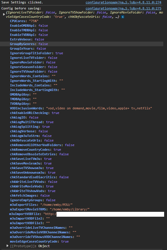

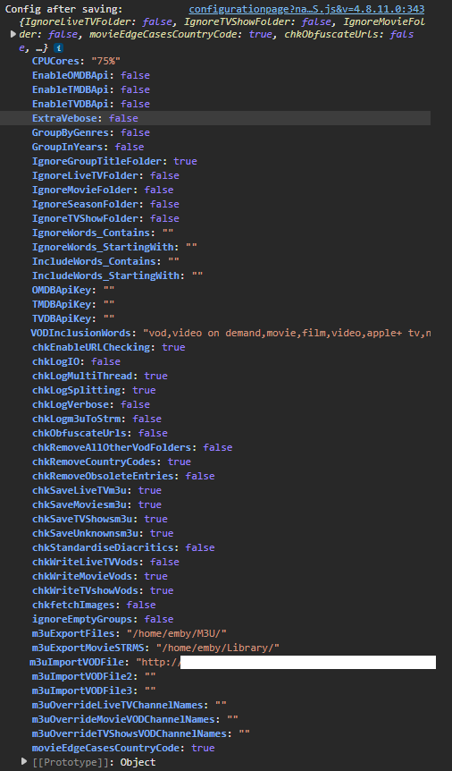

Apotropaic 62 Posted April 1, 2025 Posted April 1, 2025 2 hours ago, mickle026 said: Saving the config xml file is obviously not happening. I cannot replicate here. can you press F12 to open the browser console and see if there are any errors reported when you click save. No that's not how that works, that protects titles from being removed like "IT - It (yyyy)", you would put "It (YYYY)" and it would make sure only the first "IT -" was removed and it doesn't become "(YYYY)" But I will take on board what you are asking and maybe add the ability to do that later after the current issues are resolved. Thanks for explaining it, I have a lot VOD content that adds these silly tags all over the place so it would be appreciated if you do have the time. I tried to add the keyword 'test' and save but I can't see anything useful in the console, I can't even find the Country Code field. I did the same thing adding 'xxxxxxx' so it would jump out better but can't see that either. If there's a particular place in the console you want to see just let me know.
mickle026 653 Posted April 2, 2025 Author Posted April 2, 2025 (edited) 8 hours ago, jaspalgill said: Thanks for explaining it, I have a lot VOD content that adds these silly tags all over the place so it would be appreciated if you do have the time. I tried to add the keyword 'test' and save but I can't see anything useful in the console, I can't even find the Country Code field. I did the same thing adding 'xxxxxxx' so it would jump out better but can't see that either. If there's a particular place in the console you want to see just let me know. I think I found the error, sorted it. And added a custom string removal function as requested. This is below the country code box. ( I have NOT tested it to check it works as intended!) The plugin is now getting way more advanced than originally intended! VODtoSTRMscheduledTask.dll Edited April 2, 2025 by mickle026 1

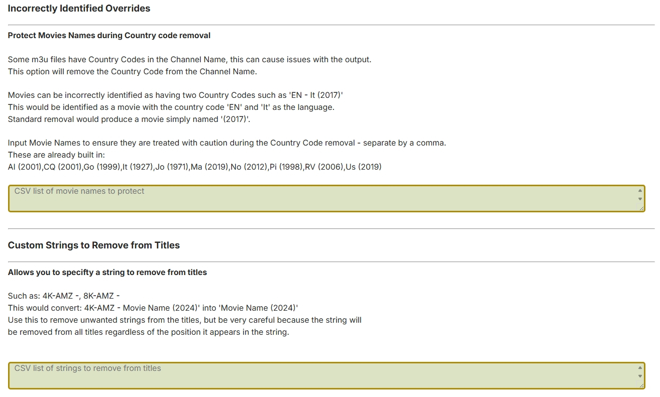

Apotropaic 62 Posted April 3, 2025 Posted April 3, 2025 On 02/04/2025 at 05:15, mickle026 said: I think I found the error, sorted it. And added a custom string removal function as requested. This is below the country code box. ( I have NOT tested it to check it works as intended!) The plugin is now getting way more advanced than originally intended! VODtoSTRMscheduledTask.dll 771 kB · 8 downloads I’ll give this a test tonight when I get home and feed back. Thanks for your effort here, much appreciated!
graytinc 1 Posted April 3, 2025 Posted April 3, 2025 On 01/04/2025 at 22:15, mickle026 said: I think I found the error, sorted it. And added a custom string removal function as requested. This is below the country code box. ( I have NOT tested it to check it works as intended!) The plugin is now getting way more advanced than originally intended! VODtoSTRMscheduledTask.dll 771 kB · 8 downloads I tried it , it worked well on removing the strings on the folders (only) but the same strings remained inside the folder content
mickle026 653 Posted April 3, 2025 Author Posted April 3, 2025 (edited) 1 hour ago, graytinc said: I tried it , it worked well on removing the strings on the folders (only) but the same strings remained inside the folder content Try this DLL, and here is some removal strings that might be useful, you can now download them as a text file, and upload them into the plugin from the text file 1080p,720p,480p,2160p,4K,8K,WEBRip,WEB-DL,BluRay,BRRip,BDRip,HDRip,HDCAM,DVDRip,DVD-SCREENER,H.264,x264,x265,HEVC,DivX,XviD,CAMRip,SD,HD,HQ,AAC,MP3,AC3,DTS,FLAC,TrueHD,Atmos,Dual Audio,Subbed,Dubbed,MULTI,Directors Cut,Extended Edition,Special Edition,Collector's Edition,Ultimate Edition,IMAX,Unrated,UNCUT,Remastered,Re-release,Redux,ENG,HINDI,FRENCH,GERMAN,SPANISH,ITALIAN,JAPANESE,KOREAN,CHINESE,RUSSIAN,PORTUGUESE,NORWEGIAN,SWEDISH,Season,S01E01,Episode,Part 1,Part 2,Pt 3,Prequel,Sequel,Final Chapter,PROPER,REPACK,NEW,REMASTERED,READNFO,FS,WS,STV,Complete,Limited,Official,Sample,Promo,Trailer,Teaser,RARBG,YIFY,EVO,FUM,LOL,ETRG,KiNGDOM,TorrentGalaxy,MKVCage,SPARKS,GalaxyRG,AMZN,NF,HULU,HMAX,WEBRip-AMZN,WEBRip-NF,CAMRip-HQ,PRE,WEB,HDTV,CAM-HD,TVRip,TeleSync VODtoSTRMscheduledTask.dll customRemovalStrings.txt Edited April 3, 2025 by mickle026
graytinc 1 Posted April 3, 2025 Posted April 3, 2025 2 hours ago, mickle026 said: Try this DLL, and here is some removal strings that might be useful, you can now download them as a text file, and upload them into the plugin from the text file 1080p,720p,480p,2160p,4K,8K,WEBRip,WEB-DL,BluRay,BRRip,BDRip,HDRip,HDCAM,DVDRip,DVD-SCREENER,H.264,x264,x265,HEVC,DivX,XviD,CAMRip,SD,HD,HQ,AAC,MP3,AC3,DTS,FLAC,TrueHD,Atmos,Dual Audio,Subbed,Dubbed,MULTI,Directors Cut,Extended Edition,Special Edition,Collector's Edition,Ultimate Edition,IMAX,Unrated,UNCUT,Remastered,Re-release,Redux,ENG,HINDI,FRENCH,GERMAN,SPANISH,ITALIAN,JAPANESE,KOREAN,CHINESE,RUSSIAN,PORTUGUESE,NORWEGIAN,SWEDISH,Season,S01E01,Episode,Part 1,Part 2,Pt 3,Prequel,Sequel,Final Chapter,PROPER,REPACK,NEW,REMASTERED,READNFO,FS,WS,STV,Complete,Limited,Official,Sample,Promo,Trailer,Teaser,RARBG,YIFY,EVO,FUM,LOL,ETRG,KiNGDOM,TorrentGalaxy,MKVCage,SPARKS,GalaxyRG,AMZN,NF,HULU,HMAX,WEBRip-AMZN,WEBRip-NF,CAMRip-HQ,PRE,WEB,HDTV,CAM-HD,TVRip,TeleSync VODtoSTRMscheduledTask.dll 833 kB · 1 download customRemovalStrings.txt 766 B · 0 downloads Thank you @mickle026, i am testing the files right now, my output file was like this with a "★" which I want off. I will update after the testing.
mickle026 653 Posted April 3, 2025 Author Posted April 3, 2025 (edited) 13 minutes ago, graytinc said: Thank you @mickle026, i am testing the files right now, my output file was like this with a "★" which I want off. I will update after the testing. I have already added that symbol to the country code removal. "EN ★" or "EN★" (EN is just an example) would get removed with the country codes removal. However with the addition of string removal, you can add a ★ there also. Every build has more and more options, its now gone past a simple tool and is rather advanced - LOL Edited April 3, 2025 by mickle026

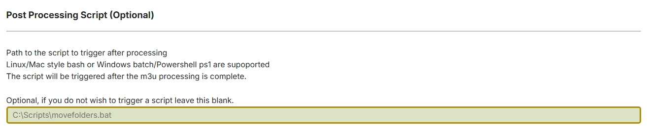

mickle026 653 Posted April 3, 2025 Author Posted April 3, 2025 I am about finished with this plugin, I have added the ability to call/trigger as script to it after processing Is there any thing else you guys need before I call it a release version? v1.0.0.141 is attached VODtoSTRMscheduledTask.dll

gillmacca01 220 Posted April 4, 2025 Posted April 4, 2025 OK, m3u is being processed, but it looks like it is getting stuck on 'post script trigger path' I can also see the error for unknown year. I will dm you the log file

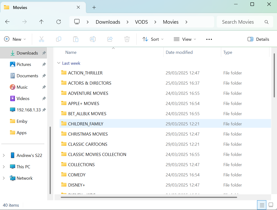

Apotropaic 62 Posted April 4, 2025 Posted April 4, 2025 13 hours ago, graytinc said: It's now working perfectly, Well done !!! Hi, did you test this only with Movies or with TV Shows as well? It's removing the prefix from TV Shows for me fine but it is isn't placing the season folders into a single TV Show folder like it does for everything else. It's not an issue as Emby handles them fine, just makes the folder layout messy.
mickle026 653 Posted April 4, 2025 Author Posted April 4, 2025 1 hour ago, gillmacca01 said: OK, m3u is being processed, but it looks like it is getting stuck on 'post script trigger path' I can also see the error for unknown year. I will dm you the log file 2 hours ago, gillmacca01 said: The input string 'unknown_year' was not in a correct format. Thanks for pointing this out. Before adding the Emby Content Query, I wrote the code so that the Year Data contained a text string for creating the Year folders when organising by Year. This all worked as it should until I added the Emby Content Query, that expects the Year as a numeric string , not an alpha string - I missed that ! I have also added an error trap for the post script trigger VODtoSTRMscheduledTask.dll
