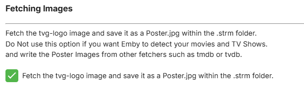

fbrassin 47 Posted March 30, 2025 Posted March 30, 2025 Hello, 'till now i disabled this option, but i wanted to try it and enabled it and run plugin, but no .jpg file has been created. With that option enabled is it supposed it downloads this jpg? https://image.tmdb.org/t/p/w600_and_h900_bestv2/flnNtMaDTEB1aHryiBkXqeBnA2V.jpg #EXTINF:-1 tvg-id="" tvg-name="Rendel II - Il cerchio della vendetta (2024)" tvg-logo="https://image.tmdb.org/t/p/w600_and_h900_bestv2/flnNtMaDTEB1aHryiBkXqeBnA2V.jpg" group-title="Azione",Rendel II - Il cerchio della vendetta (2024) http://XXXXXXXXXXXXXXXXXXXXXXXXXXX.mkv
gillmacca01 220 Posted March 30, 2025 Posted March 30, 2025 1 minute ago, fbrassin said: Hello, 'till now i disabled this option, but i wanted to try it and enabled it and run plugin, but no .jpg file has been created. With that option enabled is it supposed it downloads this jpg? https://image.tmdb.org/t/p/w600_and_h900_bestv2/flnNtMaDTEB1aHryiBkXqeBnA2V.jpg #EXTINF:-1 tvg-id="" tvg-name="Rendel II - Il cerchio della vendetta (2024)" tvg-logo="https://image.tmdb.org/t/p/w600_and_h900_bestv2/flnNtMaDTEB1aHryiBkXqeBnA2V.jpg" group-title="Azione",Rendel II - Il cerchio della vendetta (2024) http://XXXXXXXXXXXXXXXXXXXXXXXXXXX.mkv Strangely enough, I have it unticked, but when importing into Emby with no metadata providers ticked, I have poster images. I'm presuming Emby is reading the image.tmdb line and automatically importing (could be wrong though)
fbrassin 47 Posted March 30, 2025 Posted March 30, 2025 I have posters in emby because emby scans for them, but posters.jpg files are not in the folder together with .strm files.
mickle026 653 Posted March 30, 2025 Author Posted March 30, 2025 6 hours ago, fbrassin said: I have posters in emby because emby scans for them, but posters.jpg files are not in the folder together with .strm files. Hi, Thanks - I know I broke this when I rewrote the plugin to be multithreaded, I haven't fixed it yet. It is on my "to do" list, but other things are taking priority. I will get to it eventually. I am currently re-writing large sections of code due to some changes I have made in order to try and clip back the running time again. some minor changes have had a big effect and I am currently tracing where they are affected and correcting them. Current status is that I am making good progress but not quite ready to post the DLL 1
