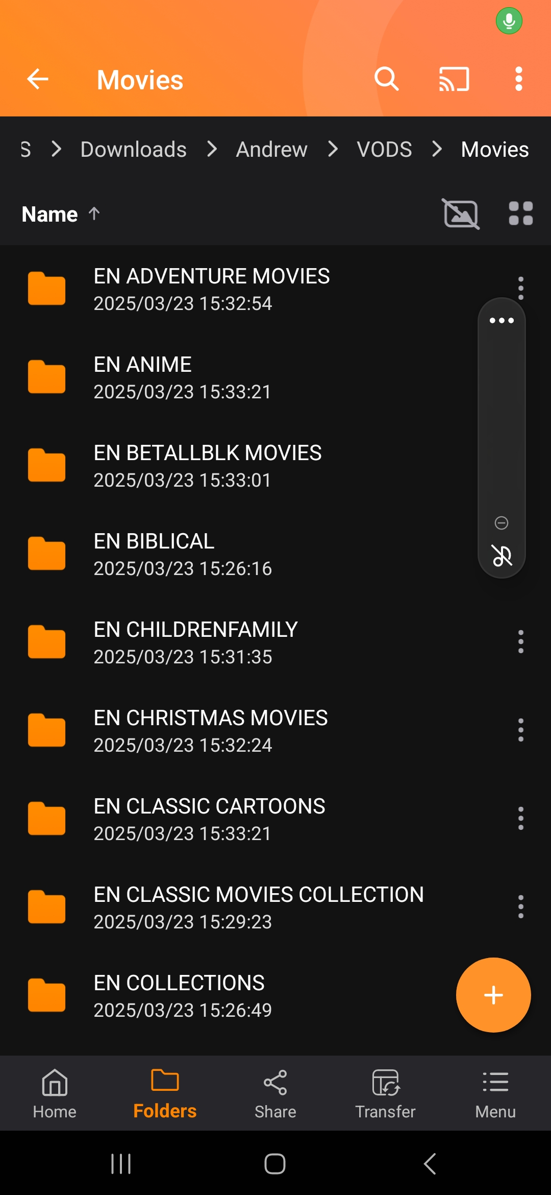

mickle026 653 Posted March 23, 2025 Author Posted March 23, 2025 (edited) 12 hours ago, gillmacca01 said: AAARRRGGHHH. Solve one problem, and another one appears (although it may have already been there, but I was looking at others stuff) I have a folder created called 'EN CHILDRENFAMILY'. m3u calls the folder |EN| CHILDREN/FAMILY Entered in the override field, but still be detected as tv shows I think I have identified this error. It was due to the channel name parsing, which worked flawlessly until your latest m3u file. There was a line that was causing issues, I have modified the code to handle this situation as well as the others. Let me know if the issue persists Altered the descriptive text, I hope this makes sense now - if not let me know VODtoSTRMscheduledTask.dll Edited March 23, 2025 by mickle026

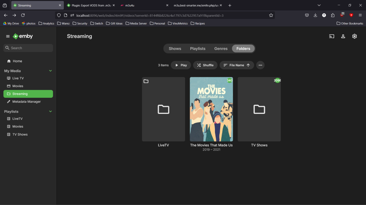

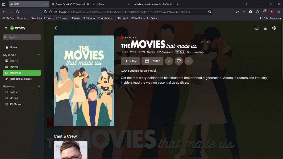

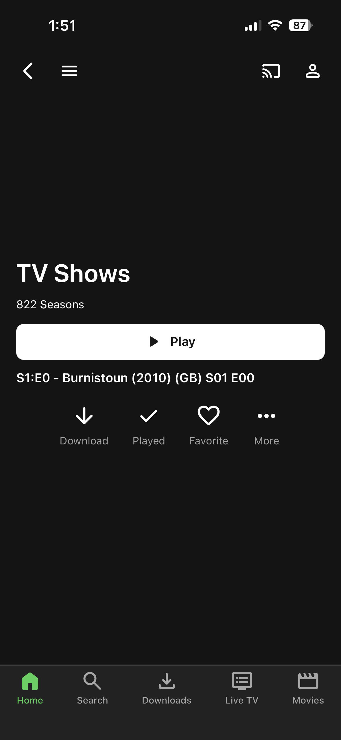

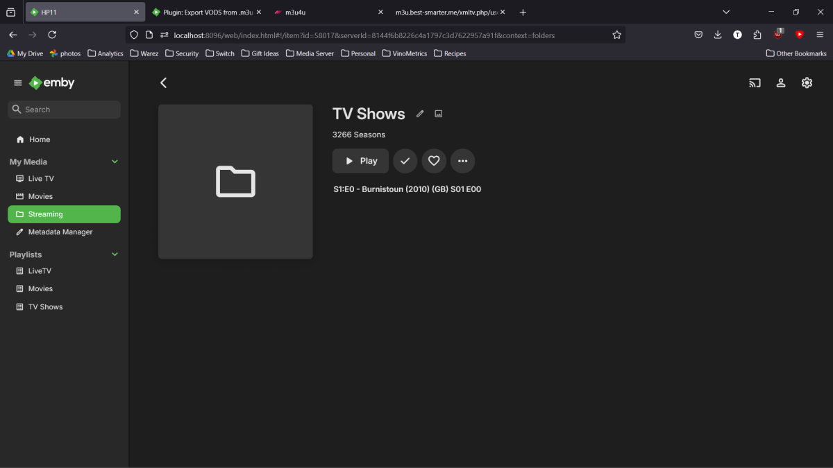

BigIrn 10 Posted March 23, 2025 Posted March 23, 2025 Damn I thought I was in the clear. TV shows under VOD look like this:
mickle026 653 Posted March 23, 2025 Author Posted March 23, 2025 1 hour ago, BigIrn said: Damn I thought I was in the clear. TV shows under VOD look like this: I have reproduced, All folders written, but not many strm files from the latest dll Checking it.....

mickle026 653 Posted March 23, 2025 Author Posted March 23, 2025 3 hours ago, gillmacca01 said: I might have jumped the gun. It turns out, for some reason, that it is deleting all my VODs. Re-running it again to see what happens, but will now take hrs because it had deleted so much. Not sure if the deleting is the plugin, or some issue with the m3u If its the last DLL I posted, I altered the name sanitising function to: instead of removing / , it replaces it with _, So EN| CHILDREN/FAMILY will change from EN CHILDRENFAMILY to EN CHILDREN_FAMILY It would delete all the previous and re-write them with their newer formatted names
gillmacca01 220 Posted March 23, 2025 Posted March 23, 2025 I have run the latest dll and this is what i see for that folder
