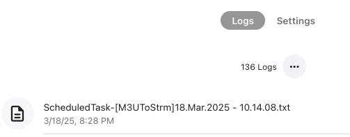

mickle026 653 Posted March 18, 2025 Author Posted March 18, 2025 (edited) 28 minutes ago, BigIrn said: You are right. My bad. I thought I had pasted over line 1 with the URL. Instead I pasted line 3 which kept the URL in line 1 so now it's checking both. It's still running right now at 2% It might not be at 2% actually, because of the loading error I described above the progress counter in scheduled tasks would jump back to 2% at the processing of the second file. It could actually be above 50%. Its ok though your little oversight there made me find the error I fixed, so its all good Edited March 18, 2025 by mickle026

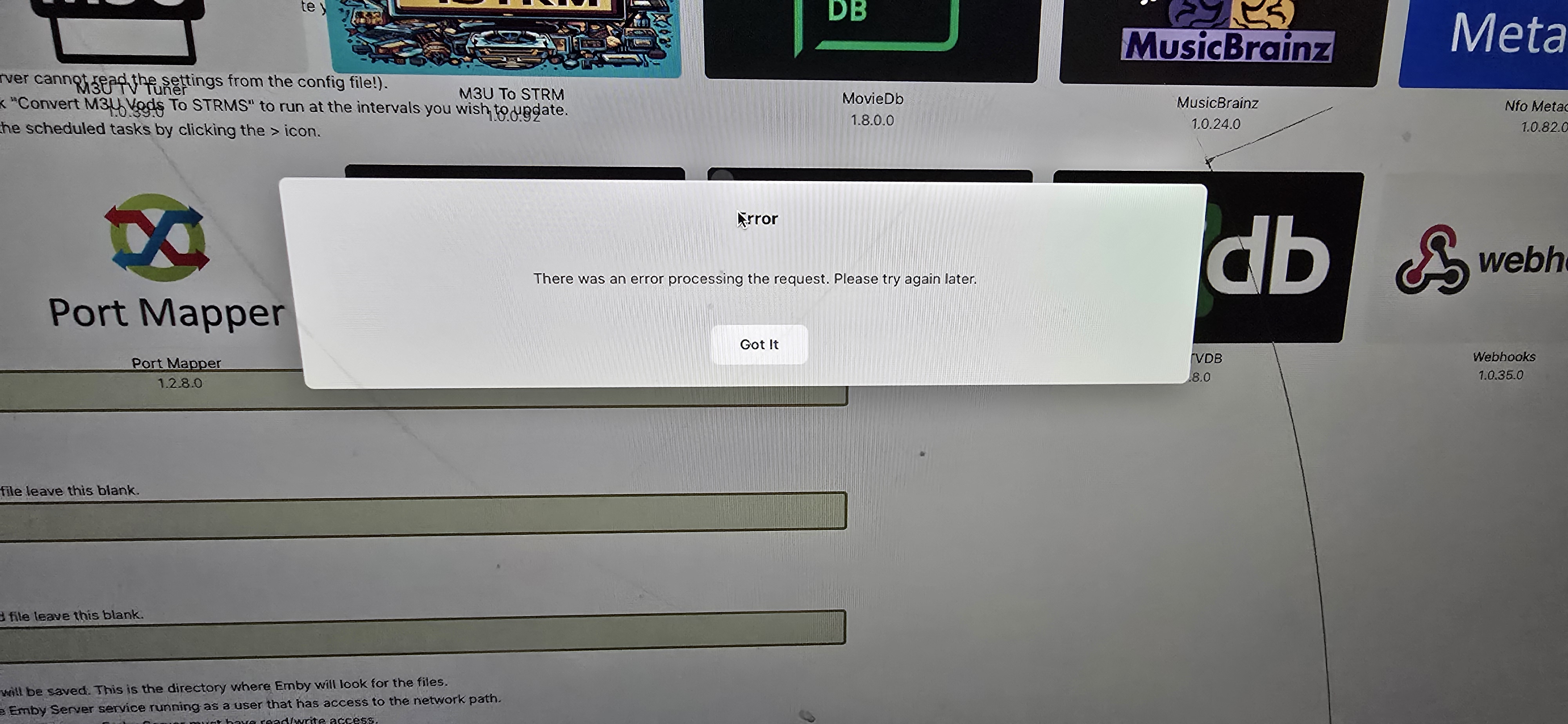

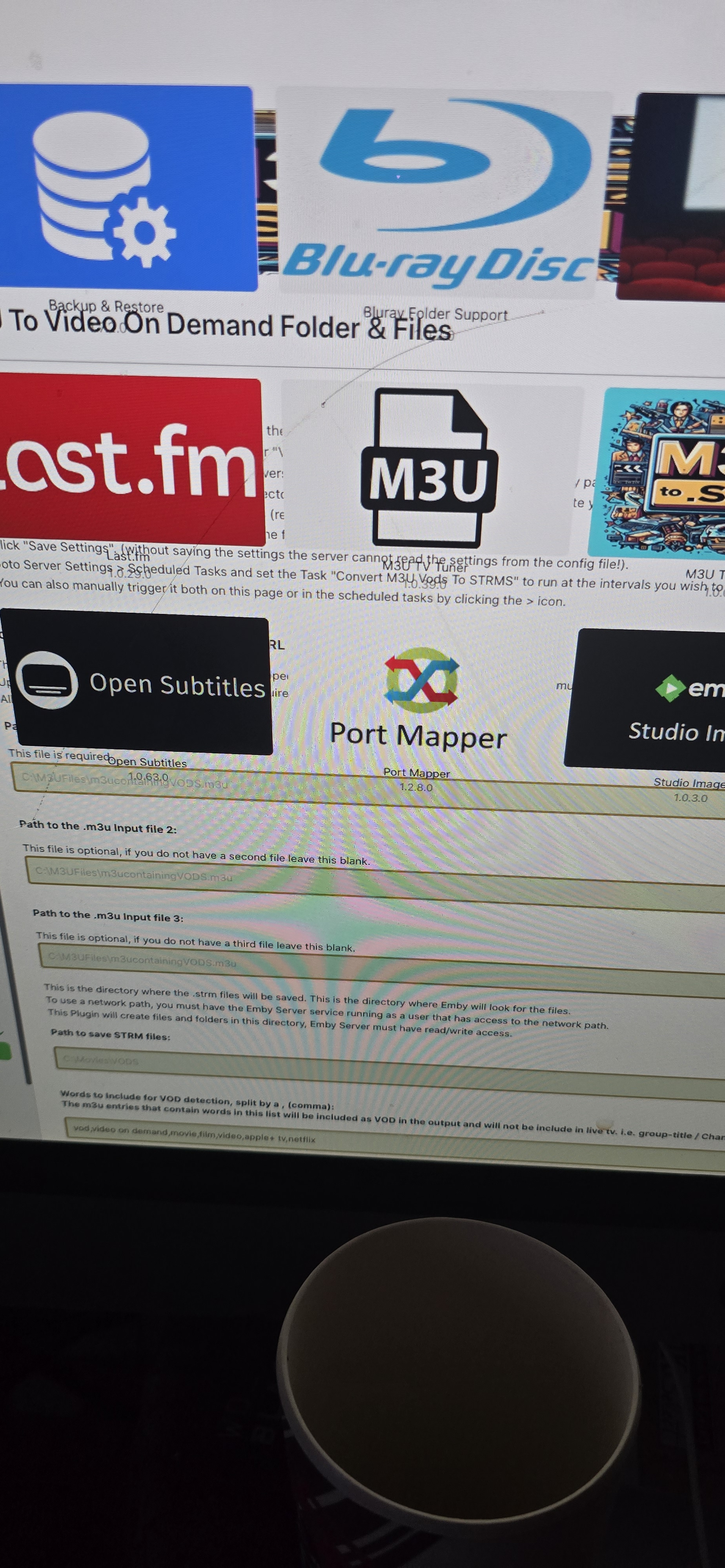

DebGigs 0 Posted March 19, 2025 Posted March 19, 2025 Hi, when I launch this plugin for settings it says there is an error. Then the screen where you configure everything is over top of everything and can not remove it.
Chadstratts 0 Posted March 19, 2025 Posted March 19, 2025 Hi two of us just tried it on two different machines and are getting this. Copied to plugins folder and see it show up in plugins. But then when I go to settings it gives and error and then I can't do anything.

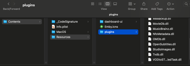

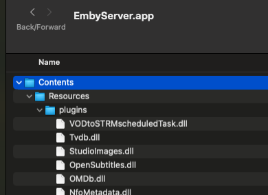

BigIrn 10 Posted March 19, 2025 Posted March 19, 2025 The DLL goes in 3 folders for me. 2 under plugin folders in the app folder and one in my user folder that is hidden. I’m on macOS so that might not be true for you guys.

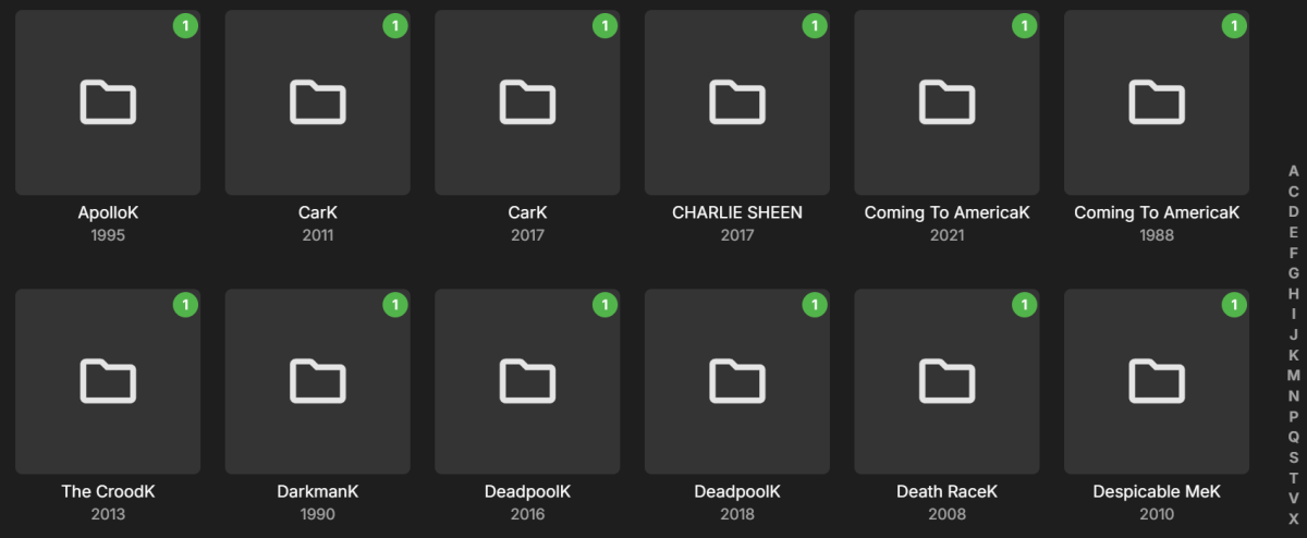

gillmacca01 220 Posted March 19, 2025 Posted March 19, 2025 I'm still running 1.0.0.109, and have just done a complete reset on the plugin (deleted m3u's and VOD's). I am still getting movies identified as TV Shows. I know this may have already been fixed in newer versions of the plugins, but I thought I would raise it, incase. I've noticed a pattern, all the movies being detected as TV Shows, have A capital K in the name (apart from the charlie sheen folder). I have only imported the VOD Movie folder into Emby. Not sure if the K is in the original m3u file, or if the plugin is creating the K
mickle026 653 Posted March 19, 2025 Author Posted March 19, 2025 To remove it, delete it manually from the plugins folder and restart emby. Needs minimum 4.8.10 server version, and try the last posted version in this thread. I will update post 1 with the newest version.
mickle026 653 Posted March 19, 2025 Author Posted March 19, 2025 8 minutes ago, gillmacca01 said: I'm still running 1.0.0.109, and have just done a complete reset on the plugin (deleted m3u's and VOD's). I am still getting movies identified as TV Shows. I know this may have already been fixed in newer versions of the plugins, but I thought I would raise it, incase. I've noticed a pattern, all the movies being detected as TV Shows, have A capital K in the name (apart from the charlie sheen folder). I have only imported the VOD Movie folder into Emby. Not sure if the K is in the original m3u file, or if the plugin is creating the K I am going to re-run it here and check but I think I can already see the error, when the name is altered to create the folder, tv shows are having the Sxx Exx removed or whatever format they have, this looks to me like a mis detection and its detecting "2 4K" as season and episode, thus removing that. According to my log entry it is happening after it has already detected it as a Movie As you can see in my log it is correctly identified as a movie, so that has been fixed already, but then it is still being ran through the episode check, it does that to absolutely make sure that its not a TV Show, but two numbers before that date are being mis-detected as season / episode and removed hence the sub folder Season 02 as you can see here. I will adjust the detection again and try to weed this one out without breaking it 18.Mar.2025 - 16:42:17 channelName: EN - Coming To America 2 4K (2021) EDDIE MURPHY 18.Mar.2025 - 16:42:17 logoUrl: https://www.themoviedb.org/t/p/original/cLw2V4cJNXD4v6o8EXCHfI9JNms.jpg 18.Mar.2025 - 16:42:17 Checking [Include Config] Include: True because config is empty. Next check Ignore Config. 18.Mar.2025 - 16:42:17 Checking [Ignore] Contains 18.Mar.2025 - 16:42:17 Checking [Ignore] StartsWith 18.Mar.2025 - 16:42:17 Include / Ignore checking passed succesfully. 18.Mar.2025 - 16:42:17 Ingnore/Include Total execution time: 0 ms 18.Mar.2025 - 16:42:17 Detected and removed country code: Modified string is 'Coming To America 2 4K (2021) EDDIE MURPHY' 18.Mar.2025 - 16:42:17 Sanitized Channelname: Coming To AmericaK (2021) EDDIE MURPHY 18.Mar.2025 - 16:42:17 Detected Movies - URL contains the word '/Movie/' 18.Mar.2025 - 16:42:17 Detected and removed country code: Modified string is 'Coming To America 2 4K (2021) EDDIE MURPHY' 18.Mar.2025 - 16:42:17 Adding movie: Coming To America 2 4K (2021) EDDIE MURPHY imagePath=https://www.themoviedb.org/t/p/original/cLw2V4cJNXD4v6o8EXCHfI9JNms.jpg, year=2021, genres= 18.Mar.2025 - 16:42:17 groupTitle Folder omitted due to IgnoreGroupTitleFolder setting. 18.Mar.2025 - 16:42:17 Constructed Folder Name: D:\VODS\Movies\Coming To AmericaK (2021) EDDIE MURPHY\Season 02 18.Mar.2025 - 16:42:17 Item [2229330] Adding to Folder: D:\VODS\Movies\Coming To AmericaK (2021) EDDIE MURPHY\Season 02 Is it appearing like that in the logs?

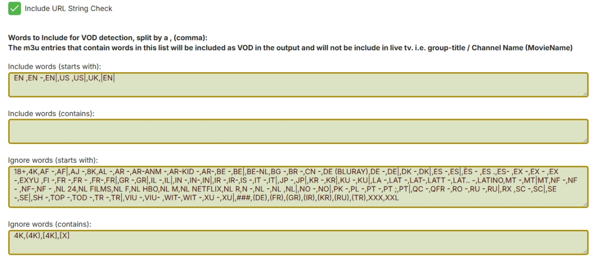

fbrassin 47 Posted March 19, 2025 Posted March 19, 2025 The latest version is running without problems with my configuration right now. Can i suggest one thing? About ignore input is it possible to make it a box so that if it is long i can see all at once without going to the and of the line?
BigIrn 10 Posted March 19, 2025 Posted March 19, 2025 11 hours ago, Chadstratts said: Hi two of us just tried it on two different machines and are getting this. Copied to plugins folder and see it show up in plugins. But then when I go to settings it gives and error and then I can't do anything. On MacOS here is where I have to place the DLL:

gillmacca01 220 Posted March 19, 2025 Posted March 19, 2025 9 hours ago, mickle026 said: I am going to re-run it here and check but I think I can already see the error, when the name is altered to create the folder, tv shows are having the Sxx Exx removed or whatever format they have, this looks to me like a mis detection and its detecting "2 4K" as season and episode, thus removing that. According to my log entry it is happening after it has already detected it as a Movie As you can see in my log it is correctly identified as a movie, so that has been fixed already, but then it is still being ran through the episode check, it does that to absolutely make sure that its not a TV Show, but two numbers before that date are being mis-detected as season / episode and removed hence the sub folder Season 02 as you can see here. I will adjust the detection again and try to weed this one out without breaking it 18.Mar.2025 - 16:42:17 channelName: EN - Coming To America 2 4K (2021) EDDIE MURPHY 18.Mar.2025 - 16:42:17 logoUrl: https://www.themoviedb.org/t/p/original/cLw2V4cJNXD4v6o8EXCHfI9JNms.jpg 18.Mar.2025 - 16:42:17 Checking [Include Config] Include: True because config is empty. Next check Ignore Config. 18.Mar.2025 - 16:42:17 Checking [Ignore] Contains 18.Mar.2025 - 16:42:17 Checking [Ignore] StartsWith 18.Mar.2025 - 16:42:17 Include / Ignore checking passed succesfully. 18.Mar.2025 - 16:42:17 Ingnore/Include Total execution time: 0 ms 18.Mar.2025 - 16:42:17 Detected and removed country code: Modified string is 'Coming To America 2 4K (2021) EDDIE MURPHY' 18.Mar.2025 - 16:42:17 Sanitized Channelname: Coming To AmericaK (2021) EDDIE MURPHY 18.Mar.2025 - 16:42:17 Detected Movies - URL contains the word '/Movie/' 18.Mar.2025 - 16:42:17 Detected and removed country code: Modified string is 'Coming To America 2 4K (2021) EDDIE MURPHY' 18.Mar.2025 - 16:42:17 Adding movie: Coming To America 2 4K (2021) EDDIE MURPHY imagePath=https://www.themoviedb.org/t/p/original/cLw2V4cJNXD4v6o8EXCHfI9JNms.jpg, year=2021, genres= 18.Mar.2025 - 16:42:17 groupTitle Folder omitted due to IgnoreGroupTitleFolder setting. 18.Mar.2025 - 16:42:17 Constructed Folder Name: D:\VODS\Movies\Coming To AmericaK (2021) EDDIE MURPHY\Season 02 18.Mar.2025 - 16:42:17 Item [2229330] Adding to Folder: D:\VODS\Movies\Coming To AmericaK (2021) EDDIE MURPHY\Season 02 Is it appearing like that in the logs? Yes, but it is also classing it as a tv show

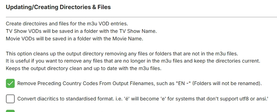

mickle026 653 Posted March 19, 2025 Author Posted March 19, 2025 7 hours ago, fbrassin said: The latest version is running without problems with my configuration right now. Can i suggest one thing? About ignore input is it possible to make it a box so that if it is long i can see all at once without going to the and of the line? Like this? I have change the html input boxes to text areas to handle being able to be resized, they should also now dynamically adjust to the loaded text or typed text. Added country code + " " to the country code remove filter. VODtoSTRMscheduledTask.dll 2
mickle026 653 Posted March 19, 2025 Author Posted March 19, 2025 (edited) 5 minutes ago, gillmacca01 said: Yes, but it is also classing it as a tv show 19.Mar.2025 - 05:36:03 channelName: EN - Coming To America 1 (1988) EDDIE MURPHY 19.Mar.2025 - 05:36:03 logoUrl: https://www.themoviedb.org/t/p/original/4L99DjVfcp9BKYBDMPnrMyW3IOE.jpg 19.Mar.2025 - 05:36:03 Checking [Include] Contains 19.Mar.2025 - 05:36:03 Checking [Include] StartsWith 19.Mar.2025 - 05:36:03 **FILTER** Keeping [channelName] [39621]: EN - Coming To America 1 (1988) EDDIE MURPHY :Filtered by: 'EN ' 19.Mar.2025 - 05:36:03 Checking [Include] StartsWith, Include: True 19.Mar.2025 - 05:36:03 Checking [Ignore] Contains 19.Mar.2025 - 05:36:03 Checking [Ignore] StartsWith 19.Mar.2025 - 05:36:03 Include / Ignore checking passed succesfully. 19.Mar.2025 - 05:36:03 Ingnore/Include Total execution time: 1 ms 19.Mar.2025 - 05:36:03 Detected and removed country code: Modified string is 'Coming To America 1 (1988) EDDIE MURPHY' 19.Mar.2025 - 05:36:03 Sanitized Channelname: Coming To America 1 (1988) EDDIE MURPHY 19.Mar.2025 - 05:36:03 Detected Movies - URL contains the word '/Movie/' 19.Mar.2025 - 05:36:03 Detected and removed country code: Modified string is 'Coming To America 1 (1988) EDDIE MURPHY' 19.Mar.2025 - 05:36:03 Adding movie: Coming To America 1 (1988) EDDIE MURPHY imagePath=https://www.themoviedb.org/t/p/original/4L99DjVfcp9BKYBDMPnrMyW3IOE.jpg, year=1988, genres= 19.Mar.2025 - 05:36:03 groupTitle Folder omitted due to IgnoreGroupTitleFolder setting. 19.Mar.2025 - 05:36:03 Constructed Folder Name: D:\VODS\Movies\Coming To America 1 (1988) EDDIE MURPHY 19.Mar.2025 - 05:36:03 Item [79240] Adding to Folder: D:\VODS\Movies\Coming To America 1 (1988) EDDIE MURPHY I don't see that here? *Edited* Ah you still have the "K" so not running the fixed dll, or maybe its me excluding the 4K, I will re-run not excluding 4k and test Edited March 19, 2025 by mickle026
gillmacca01 220 Posted March 19, 2025 Posted March 19, 2025 5 minutes ago, mickle026 said: 19.Mar.2025 - 05:36:03 channelName: EN - Coming To America 1 (1988) EDDIE MURPHY 19.Mar.2025 - 05:36:03 logoUrl: https://www.themoviedb.org/t/p/original/4L99DjVfcp9BKYBDMPnrMyW3IOE.jpg 19.Mar.2025 - 05:36:03 Checking [Include] Contains 19.Mar.2025 - 05:36:03 Checking [Include] StartsWith 19.Mar.2025 - 05:36:03 **FILTER** Keeping [channelName] [39621]: EN - Coming To America 1 (1988) EDDIE MURPHY :Filtered by: 'EN ' 19.Mar.2025 - 05:36:03 Checking [Include] StartsWith, Include: True 19.Mar.2025 - 05:36:03 Checking [Ignore] Contains 19.Mar.2025 - 05:36:03 Checking [Ignore] StartsWith 19.Mar.2025 - 05:36:03 Include / Ignore checking passed succesfully. 19.Mar.2025 - 05:36:03 Ingnore/Include Total execution time: 1 ms 19.Mar.2025 - 05:36:03 Detected and removed country code: Modified string is 'Coming To America 1 (1988) EDDIE MURPHY' 19.Mar.2025 - 05:36:03 Sanitized Channelname: Coming To America 1 (1988) EDDIE MURPHY 19.Mar.2025 - 05:36:03 Detected Movies - URL contains the word '/Movie/' 19.Mar.2025 - 05:36:03 Detected and removed country code: Modified string is 'Coming To America 1 (1988) EDDIE MURPHY' 19.Mar.2025 - 05:36:03 Adding movie: Coming To America 1 (1988) EDDIE MURPHY imagePath=https://www.themoviedb.org/t/p/original/4L99DjVfcp9BKYBDMPnrMyW3IOE.jpg, year=1988, genres= 19.Mar.2025 - 05:36:03 groupTitle Folder omitted due to IgnoreGroupTitleFolder setting. 19.Mar.2025 - 05:36:03 Constructed Folder Name: D:\VODS\Movies\Coming To America 1 (1988) EDDIE MURPHY 19.Mar.2025 - 05:36:03 Item [79240] Adding to Folder: D:\VODS\Movies\Coming To America 1 (1988) EDDIE MURPHY I don't see that here? *Edited* Ah you still have the "K" so not running the fixed dll, or maybe its me excluding the 4K, I will re-run not excluding 4k and test Correct, I have no way to update the dll file on my QNAP while I am away (unless someone know a way), that's why I said it may have been fixed

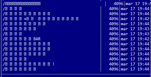

fbrassin 47 Posted March 19, 2025 Posted March 19, 2025 On 3/17/2025 at 9:32 PM, fbrassin said: Another thing. I found some Tv shows and some movies written like these Is there a way to solve? Do you think there is a way to understand which characters are not recognised?
mickle026 653 Posted March 19, 2025 Author Posted March 19, 2025 17 minutes ago, fbrassin said: Do you think there is a way to understand which characters are not recognised? I have already in the last version add a standardise diacritics option, have you tried it and see if its caused by utf8/ansi characters? What are the movies/tv show names that this is happening to? If the names are all garbled, copy the link in the strm file and search for it in your m3u file to get the information.

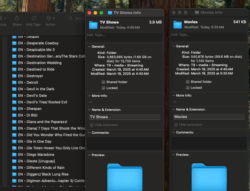

mickle026 653 Posted March 19, 2025 Author Posted March 19, 2025 (edited) 1 hour ago, BigIrn said: So the issue I was having earlier with the input m3u being the m3u4u.com URL is still there. It will see it and it looks like it downloads but then finishes in a few seconds. I tried it again with just the local m3u and it is running now. What is the issue exactly? Is it not downloading, processing, or is it just "empty" of the data you have selected to output, because of the massively reduced file size (120mb to 2.8mb)? Edited March 19, 2025 by mickle026
BigIrn 10 Posted March 19, 2025 Posted March 19, 2025 15 minutes ago, mickle026 said: What is the issue exactly? Is it not downloading, processing, or is it just "empty" of the data you have selected to output, because of the massively reduced file size (120mb to 2.8mb)? Very simply, m3u4u.com doesn’t produce anything. local m3u works. When I ran the job that worked I had both versions. In input 1 and 3. Now I’m only running local m3u on 1. I will try to put in the raw m3u from my provider when this finishes to see if does anything different than using m3u4u.com
