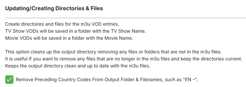

gillmacca01 220 Posted March 16, 2025 Posted March 16, 2025 So, i've run the latest version, none of the strm's in the output file have had EN removed, and still not importing the 3000+ movies that were detected at tv shows. Should I delete the output folders and let it rebuild from scratch?

mickle026 653 Posted March 16, 2025 Author Posted March 16, 2025 So here's where I am at, I have corrected detection when Check URL is not selected I have corrected remove country codes - wondering if I should add "UK" as the current country code is "EN" 16.Mar.2025 - 15:27:28 tvgName: EN - Bigfoot Famous (2021) 16.Mar.2025 - 15:27:28 groupTitle: |EN| MOVIES 2018-2021 16.Mar.2025 - 15:27:28 channelName: EN - Bigfoot Famous (2021) 16.Mar.2025 - 15:27:28 logoUrl: https://image.tmdb.org/t/p/w600_and_h900_bestv2/141Mj7agibo9jmbpKqw3tHppIoa.jpg 16.Mar.2025 - 15:27:28 Keeping [channelName] [36296]: EN - Bigfoot Famous (2021) :Filtered by: 'EN ' 16.Mar.2025 - 15:27:28 Detected and removed country code: Modified string is 'Bigfoot Famous (2021)' 16.Mar.2025 - 15:27:28 Sanitized Channelname: Bigfoot Famous (2021) 16.Mar.2025 - 15:27:28 Detected and removed country code: Modified string is 'MOVIES 2018-2021' 16.Mar.2025 - 15:27:28 Type: Movies - Detected Movie file extension: .mp4 16.Mar.2025 - 15:27:28 Detected and removed country code: Modified string is 'Bigfoot Famous (2021)' 16.Mar.2025 - 15:27:28 Adding movie: Bigfoot Famous (2021) 16.Mar.2025 - 15:27:28 groupTitle Folder omitted due to IgnoreGroupTitleFolder setting. 16.Mar.2025 - 15:27:28 Item [72590] Adding to Folder: D:\VODS\Movies\Bigfoot Famous (2021) @gillmacca01 The VODs are populating correctly here as far as I can tell , with just include and ignore words VODtoSTRMscheduledTask.dll

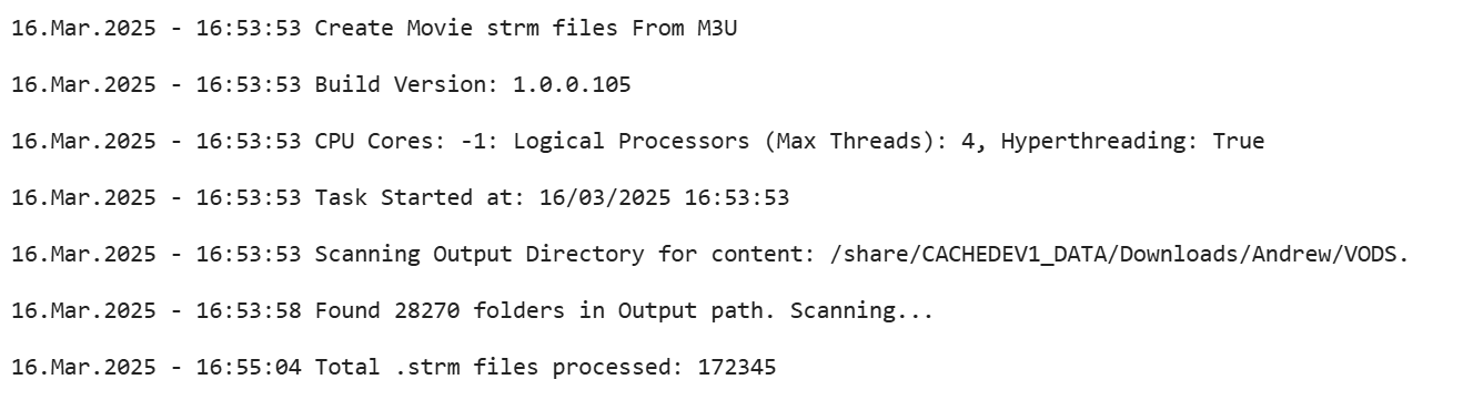

mickle026 653 Posted March 16, 2025 Author Posted March 16, 2025 This one just has additional logging it logs the build number in the top of the log There is some more in verbose mode 16.Mar.2025 - 16:30:29 CreateMovieStrmsFromM3UTaskStarter method triggered. 16.Mar.2025 - 16:30:29 Inside Task.Run. 16.Mar.2025 - 16:30:29 Create Movie strm files From M3U 16.Mar.2025 - 16:30:29 Build Version: 1.0.0.105 16.Mar.2025 - 16:30:31 CPU Cores: 8: Logical Processors (Max Threads): 16, Hyperthreading: True 16.Mar.2025 - 16:30:31 Task Started at: 16/03/2025 16:30:31 I have a GUT feeling that even though Emby has restarted in SOME cases, it is just going through the motion, and not really restarting..... and I have this feeling that its the "embytray" that sometimes causes this.. Its just a GUT feeling at the moment, but you should be able to tell if the next run after dll update has the same build number or not. VODtoSTRMscheduledTask.dll

mickle026 653 Posted March 16, 2025 Author Posted March 16, 2025 @gillmacca01 The log has only done stage 1, scanning the content already on the drive. There is more to do, it has to process the m3u and categorise everything then write the output files The end of the log tells you it has finished For your m3u a full verbose log is nearly 1gb, its huge... (and probably split into parts)
gillmacca01 220 Posted March 16, 2025 Posted March 16, 2025 (edited) 3 minutes ago, mickle026 said: @gillmacca01 The log has only done stage 1, scanning the content already on the drive. There is more to do, it has to process the m3u and categorise everything then write the output files The end of the log tells you it has finished For your m3u a full verbose log is nearly 1gb, its huge... (and probably split into parts) Sorry for the confusion. I thought because the scheduled task said it was finished, that it was done. Didn't realise it hadn't actually finished Not sure how I'm going to send you that file Edited March 16, 2025 by gillmacca01
