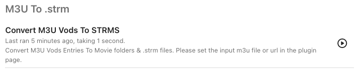

BigIrn 10 Posted March 16, 2025 Posted March 16, 2025 Ok so I am on version 99 and I created a whole new folder called Streaming instead of VOD. I created my m3u with EVERY channel with fingers crossed. I put in the URL and it doesn't read it. I put in the actual m3u and it still seems to not read it. What filters are you guys using or did you change them? Am I missing something when I add the url or m3u? 16.Mar.2025 - 06:15:35 Create Movie strm files From M3U 16.Mar.2025 - 06:15:35 CPU Cores: 10: Logical Processors (Max Threads): 10, Hyperthreading: False 16.Mar.2025 - 06:15:35 Task Started at: 3/16/2025 6:15:35AM 16.Mar.2025 - 06:15:35 ----------------------------------------------------------------------- 16.Mar.2025 - 06:15:35 Create Movie Stream Files From M3U Scheduled Task Triggered. 16.Mar.2025 - 06:15:35 ----------------------------------------------------------------------- 16.Mar.2025 - 06:15:35 Input File 1: /Volumes/T9/StreamingM3U/all_m3u.m3u 16.Mar.2025 - 06:15:35 -----------------------[ Scanning Current Folders ]---------------------------- 16.Mar.2025 - 06:15:35 Scanning Output Directory for content: /Volumes/T9/media/Streaming/. 16.Mar.2025 - 06:15:35 Found 0 folders in Output path. Scanning... 16.Mar.2025 - 06:15:35 Total .strm files processed: 0 16.Mar.2025 - 06:15:35 ----------------------[ Reading M3U File Contents ]---------------------------- 16.Mar.2025 - 06:15:35 Loading M3U file. 16.Mar.2025 - 06:15:36 Reading local file: /Volumes/T9/StreamingM3U/all_m3u.m3u 16.Mar.2025 - 06:15:36 The output directory is empty. 16.Mar.2025 - 06:15:36 -----------------------[ Updating Output Folder ]------------------------------- 16.Mar.2025 - 06:15:36 Updating OutputFolder (Creating/Deleting strms & folders) 16.Mar.2025 - 06:15:36 Config: Write LiveTV VOD: False Write Movie VOD: True Write TV Show VODS: True 16.Mar.2025 - 06:15:36 Finished this import. 16.Mar.2025 - 06:15:36 Task Ended at: 3/16/2025 6:15:36AM 16.Mar.2025 - 06:15:36 Task Duration: 00:00:00.82 16.Mar.2025 - 06:15:36 No Input File 2 16.Mar.2025 - 06:15:36 No Input File 3

mickle026 653 Posted March 16, 2025 Author Posted March 16, 2025 I think I already have it in a previous dm, its a small m3u with only live tv in it? 2.8mb? from m3u4u ? There is only live tv in it, if you add "UK" to your include starts with, it produces the livetv.m3u just fine. It cant produce tv shows or movies because there are none in it. IF set it also produced the live tv folder with the strm files. So with its contents, the only option you have to you is live tv, do you have different urls for movies and tv shows? or is m3u4u a splitting service? This doesnt seem to be the complete m3u?

mickle026 653 Posted March 16, 2025 Author Posted March 16, 2025 This should resolve the m3u url not downloading VODtoSTRMscheduledTask.dll
BigIrn 10 Posted March 16, 2025 Posted March 16, 2025 15 minutes ago, mickle026 said: I think I already have it in a previous dm, its a small m3u with only live tv in it? 2.8mb? from m3u4u ? There is only live tv in it, if you add "UK" to your include starts with, it produces the livetv.m3u just fine. It cant produce tv shows or movies because there are none in it. IF set it also produced the live tv folder with the strm files. So with its contents, the only option you have to you is live tv, do you have different urls for movies and tv shows? or is m3u4u a splitting service? This doesnt seem to be the complete m3u? I sent 2. The one earlier tonight was just live tv. The one named ALL.m3u is everything. @gillmacca01gave me the idea to just throw everything at it and see what sticks.

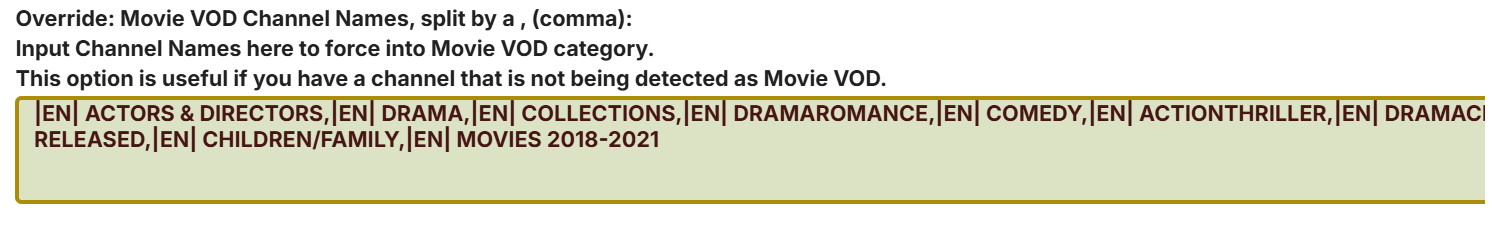

gillmacca01 220 Posted March 16, 2025 Posted March 16, 2025 (edited) @mickle026 When you get the chance, can you confirm I have filled this field out correctly (I know it says channel names, don't know if that means/included groups) I currently have over 3000 movies being detected as tv shows, in various groups. I'm hoping I'm not going to have to enter every single movie name Edited March 16, 2025 by gillmacca01
BigIrn 10 Posted March 16, 2025 Posted March 16, 2025 7 minutes ago, mickle026 said: This should resolve the m3u url not downloading VODtoSTRMscheduledTask.dll 676.5 kB · 0 downloads Thanks. I turned on verbose logging and is doing *something*. I'll wait until it's finished.
BigIrn 10 Posted March 16, 2025 Posted March 16, 2025 24 minutes ago, mickle026 said: This should resolve the m3u url not downloading VODtoSTRMscheduledTask.dll 676.5 kB · 0 downloads Testing now with URL and no filters.
BigIrn 10 Posted March 16, 2025 Posted March 16, 2025 Still nothing. I'll send you the logs @mickle026
mickle026 653 Posted March 16, 2025 Author Posted March 16, 2025 (edited) @BigIrn I have replied to your dm with an explanation of what is happening. Edited March 16, 2025 by mickle026
mickle026 653 Posted March 16, 2025 Author Posted March 16, 2025 2 hours ago, gillmacca01 said: @mickle026 When you get the chance, can you confirm I have filled this field out correctly (I know it says channel names, don't know if that means/included groups) I currently have over 3000 movies being detected as tv shows, in various groups. I'm hoping I'm not going to have to enter every single movie name can you send me some examples of the EXTINF lines without the url ? of what is being mis-detected
gillmacca01 220 Posted March 16, 2025 Posted March 16, 2025 I will have to remove the override and rerun the plugin
mickle026 653 Posted March 16, 2025 Author Posted March 16, 2025 2 hours ago, gillmacca01 said: @mickle026 When you get the chance, can you confirm I have filled this field out correctly (I know it says channel names, don't know if that means/included groups) I currently have over 3000 movies being detected as tv shows, in various groups. I'm hoping I'm not going to have to enter every single movie name I cannot find |EN| DRAMA in the m3u file you sent me
gillmacca01 220 Posted March 16, 2025 Posted March 16, 2025 2 minutes ago, mickle026 said: I cannot find |EN| DRAMA in the m3u file you sent me It's in my M3U. One of the movies in the group is Jailbreak Pact (2020)
mickle026 653 Posted March 16, 2025 Author Posted March 16, 2025 @gillmacca01 Its ok, It appears that I still have your link to download the original, I will grab that and check it to see if anything changed
gillmacca01 220 Posted March 16, 2025 Posted March 16, 2025 2 minutes ago, mickle026 said: @gillmacca01 Its ok, It appears that I still have your link to download the original, I will grab that and check it to see if anything changed I'm just re-adding the movies VOD only back into Emby
mickle026 653 Posted March 16, 2025 Author Posted March 16, 2025 @gillmacca01 Found it, its in your new m3u, it wasn't in the previous one I had, i will check what is going on there
